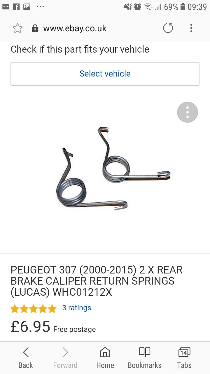

Any way I can put it on myself? I tried searching oine and found this on ebay. Is this the same stuff? And is it easy to put in? Cheers bud.Image

It shouldn't be too hard to fit - although it might be a strong spring! There are possible 2 types of brakes fitted, so those might not be the right ones; post up your VIN (It will hide itself) and I'll check what's fitted.

RichardW wrote: 13 Dec 2018, 12:11 It shouldn't be too hard to fit - although it might be a strong spring! There are possible 2 types of brakes fitted, so those might not be the right ones; post up your VIN (It will hide itself) and I'll check what's fitted.
Thanks mate. VIN VF3**************[VIN obfuscated, can be read by forum staff]
Hope it is an easy fit haha

Yours has Lucas brakes, so those look like the right ones.
