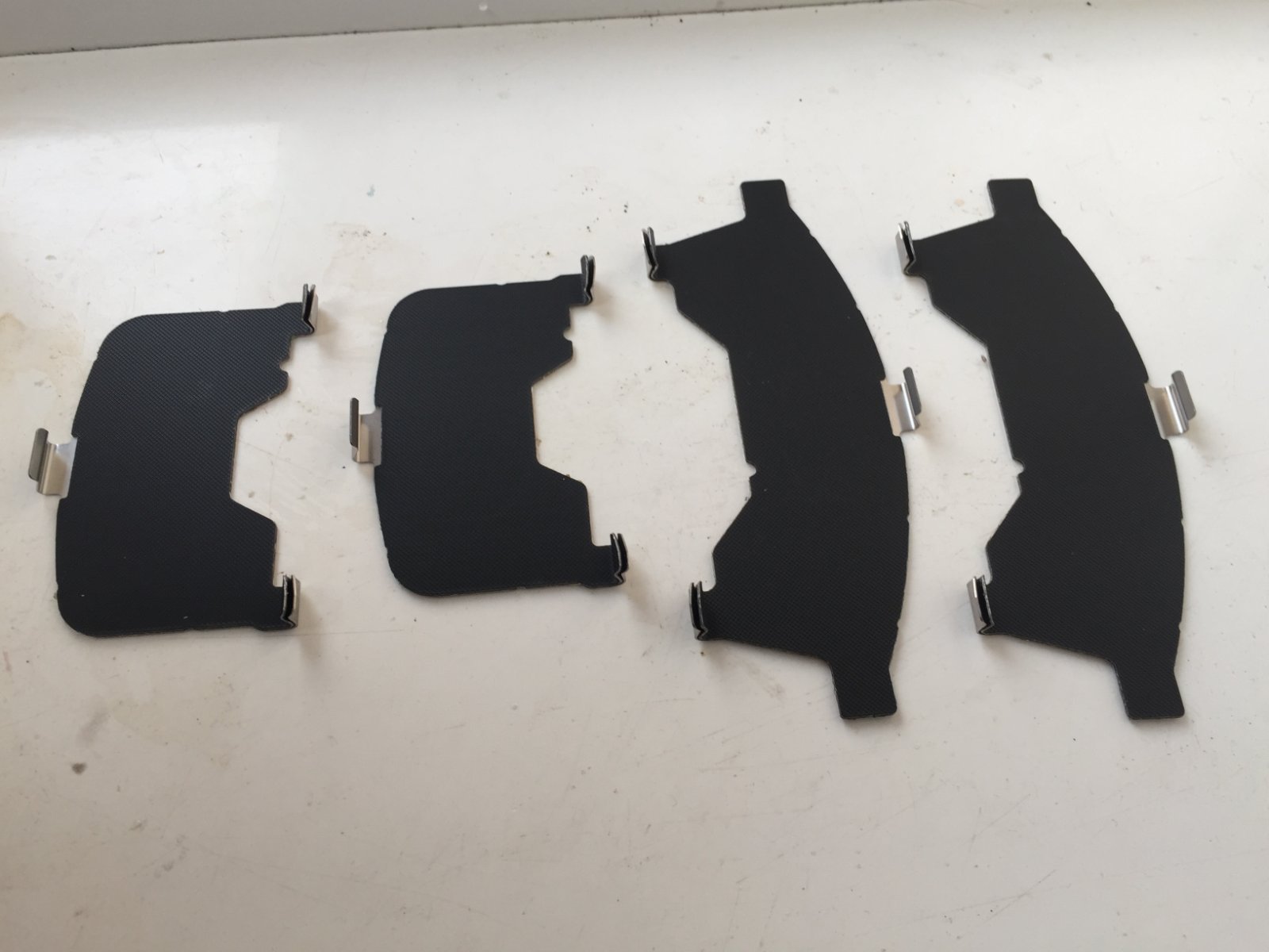

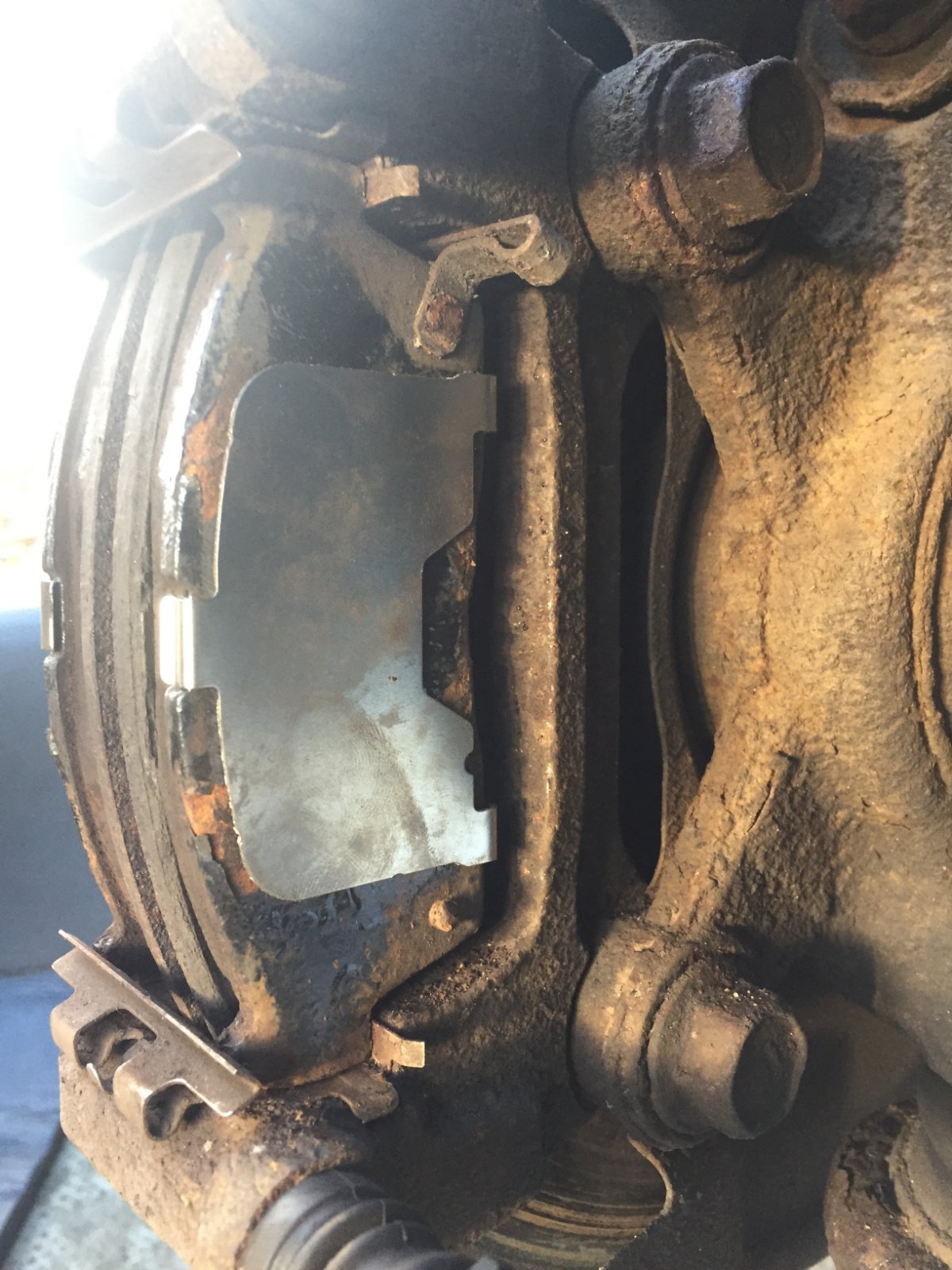

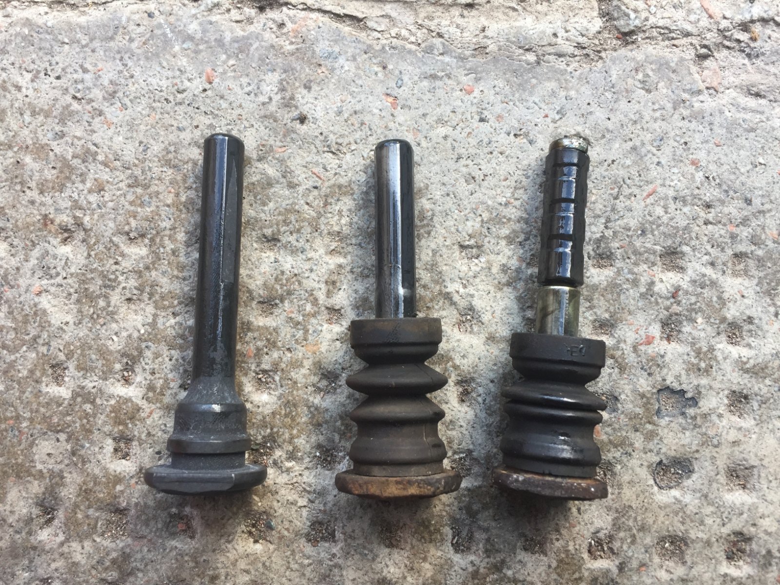

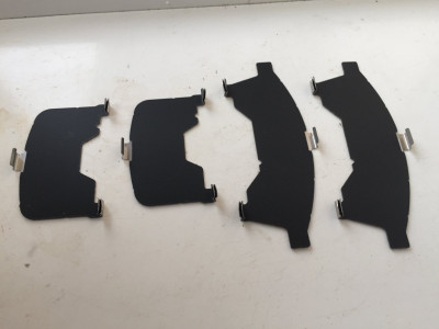

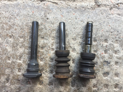

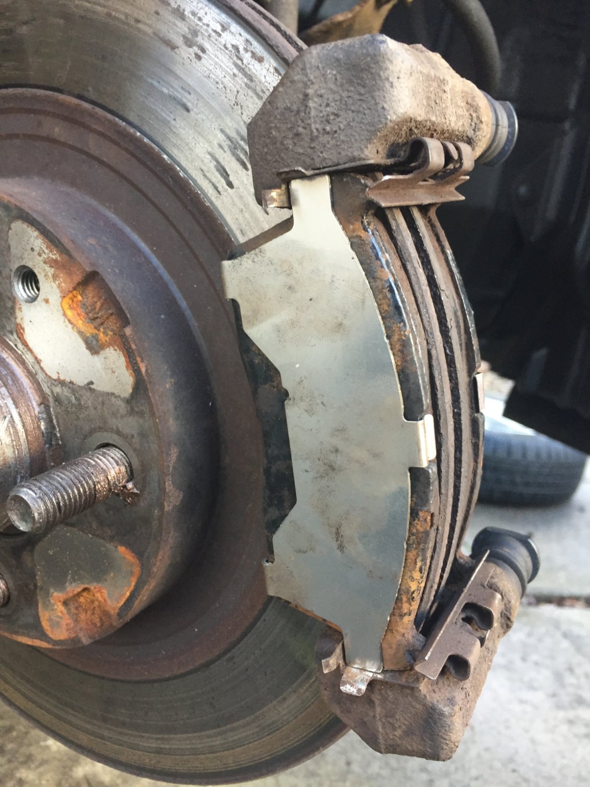

In other news, a few weeks ago now before I got sick I replaced both the rear seat handle for the new one, and the front brake caliper slide pins and fitted the "noise reduction kit". I ended up buying a set of four of the top metal only pins to completely eliminate the stupid rubber bush. It had the parts guy scratching his head at first wondering why I wanted four of the same instead of two of each but he took my word for it when I explained what I was up to.
New pin on the left, old ones middle and right:
I forgot to measure the old and new pins with the caliper to see if there was much wear, but just trying to rock the pins around in the caliper yoke by hand the new ones seemed a significantly snugger fit so I think there was significant wear on the old pins. I also fitted this noise prevention kit which seems to be two layer shims with a damping layers, probably designed for squeal reduction:
Fitted:
I'm pleased to report that in the weeks since then, the incessant never ending front brake caliper rattle on rough seal finally seems to be gone for good.
It's amazing how much more "solid" a car feels when a major source of rattles is eliminated.
I don't know how much the new pins contributed and how much the anti-rattle shims contributed but either way, silence is bliss.
I still don't know the purpose of the rubber bush on the bottom pin - if it's for anti-rattle purposes its a miserable failure.... The all metal top pin fits the bottom yoke hole perfectly, and there is absolutely no rattle now. Another thing I've noticed is that the front brakes are finally consistent and sensitive in their operation. They no longer stick on ever so slightly on occasions, and they are sensitive and smooth in their initial application and with plenty of bite if you push hard. In other words they work properly now.
Terrible design decision having that jam prone rubber bush in my opinion, and totally unnecessary! It gives me peace of mind to know that that rubber bush cannot possibly jam on me again - as it's no longer there...

Simon, why is it all so rusty around there?
On the anti-squeal shims, having two placed together is normal for some cars - our RAV4 has just this arrangement. Some of these shims are now coming 'ready-coated' with a teflon-like layer, and some pad sets are also rear-side coated with a heavy, sound-coupling layer.
Where they don't have a special layer of any kind, and are just plain metal, I think is important that both sides of the shims are smeared with copper grease, to provide positive acoustic coupling (and some anti-rattle at the same time).
