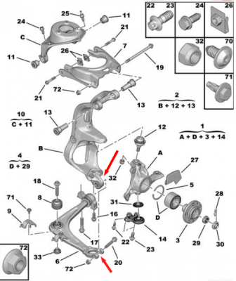

Right, I have just gotten the car back from my local Indy - went in for the bush on the lower front OS Pivot Support. As you know Citroen do not supply bushes for these only the £356 support!
So just to confirm that I was having a clunking noise intermittently when pulling away a little sharpish or braking suddenly - and worse when going over a pot hole; It was determined that this bush was moving when levered with a screwdriver and was the culprit.
So the bushes are available in kits or from about £10 each and can be done in situ without taking the support off. Worth knowing for future reference.
Also, whilst there, got a call to say the front discs were crumbling and the pads were on the metal. So had those done too They said the discs were one of the largest ones they've seen!
