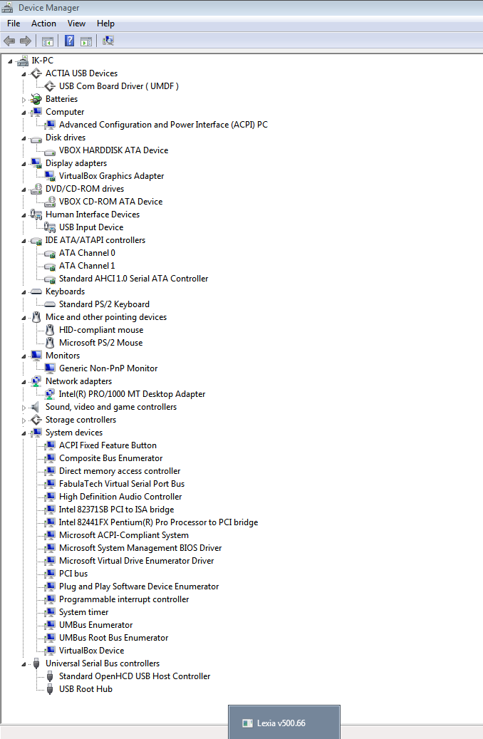

Re: Lexia making me want to tear my hair out.
Check the USB driver in Device Manager?

Did you check device manager or that the USB ports are allowing communication through the VM?

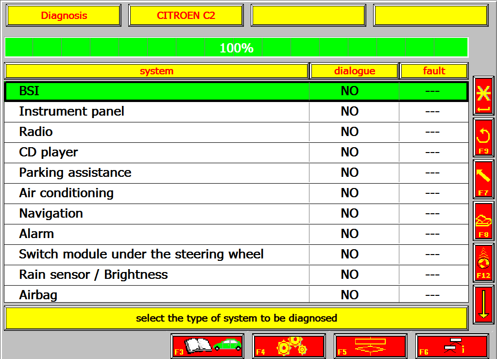

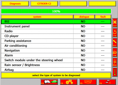

tomjyoutwit
- Posts: 127
- Joined: 17 Nov 2018, 13:11
- x 5
So when asked to connect the VCI, I did, but then after running diagnosis all the dialogues returned 'No' which makes me think that Lexia is not communicating with the car (also no green light on the unit)
