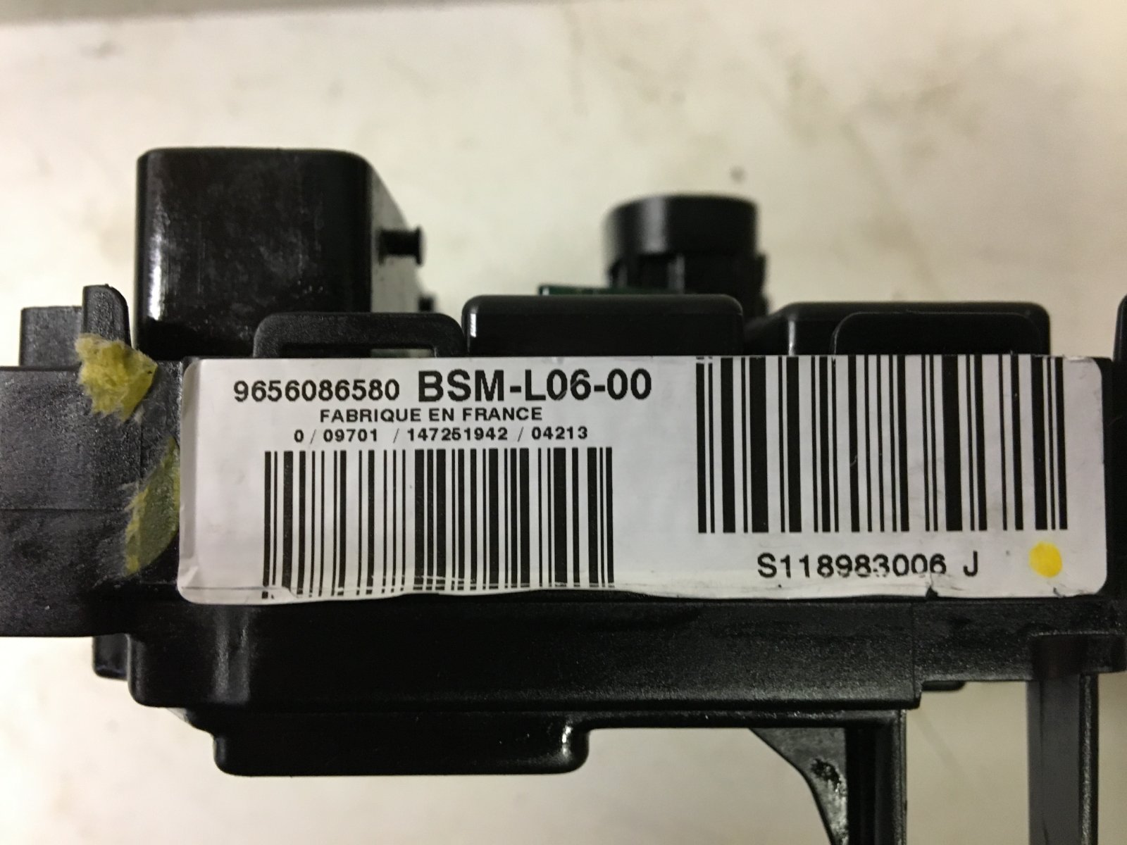

Has anyone got one of these for sale?
2004 C5 Mk11 2.2 HDI Auto Exclusive Vin Number: VF7**************[VIN obfuscated, can be read by forum staff]
BSM L06 - 00
9656086580
I have approached some Ebay sellers of this item but they say that the long part number does not match.
Could that be just a serial number with the main reference being L06 - 00 ?

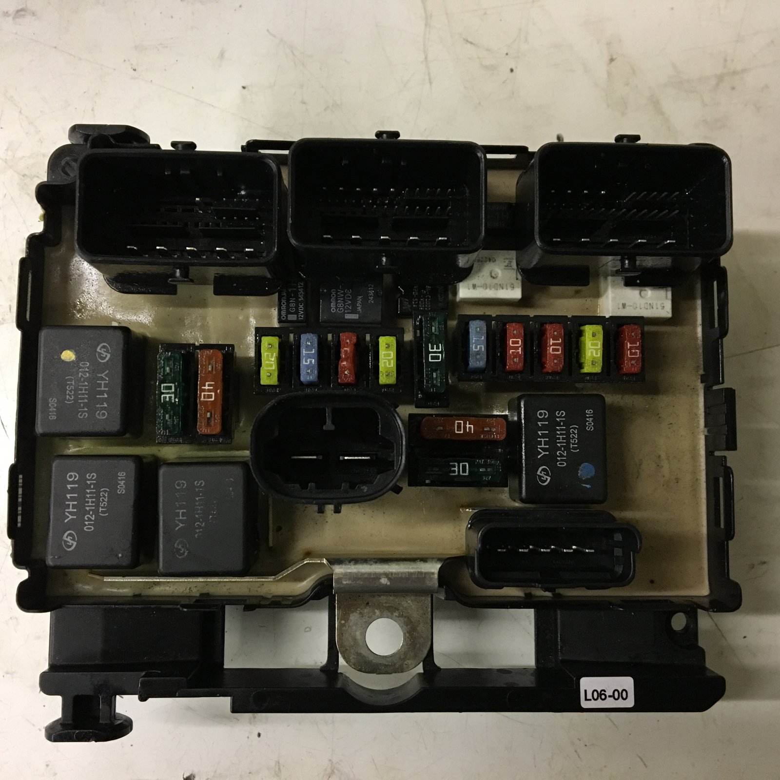

Re: WANTED C5 under bonnet fusebox
What's wrong with the original one? It might be repairable.
I've been advised that it may have a faulty fuel pump relay
I ask because I recently discovered the relays can be had for a few quid and are easy to replace if you can (de)solder?
No problem with soldering but does it mean cutting the bottom off the unit to gain access or by trying to remove all the silicone sealant?
If it's the same construction, no cutting needed. The two boards are push-fit pins and any breached sealant (around the soldered joints) can be remade after.
Or are they all potted in? I can't tell from the photo.
The one you need is PSA part number 6500CK.
It is important to get the correct one for the specific vehicle and options.
It does look potted, now I've had a closer look. I thought you meant the sealant covering the PCB or perhaps joining the casing.
It can be unpotted but probably more work than you're willing to undertake when used spares are relatively cheap.
what does potted mean?
- Posts: 14310
- x 3296
Potting compound is a material used to protect circuit boards, typically from environmental conditions, and sometimes to protect intellectual property. It is the cream substance in the first of the two pictures.
