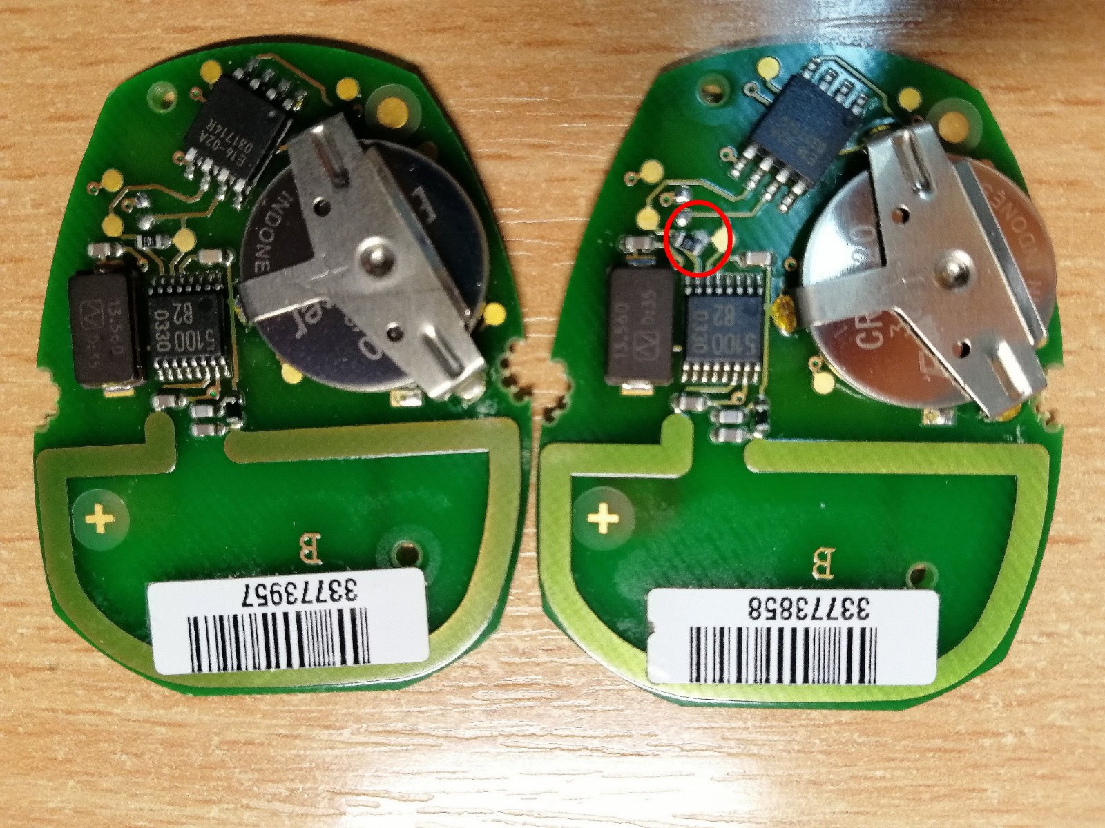

So, I managed to find the old key and took both apart, swapping the rubber pads, circuit boards and making a note of the combinations.
The good news is that I have now managed to get one functional key fob
It turns out that one of the components on the circuit board has been displaced.
I hope that the picture below shows this well... Is there any way that I can arrange to get this repaired?
Also, the donor keyfob has a missing piece - the pivot button and spring that allows the keyblade to swing out like a flickknife.
