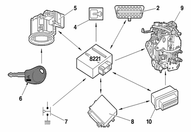

Ok, so you have the 1.4i 75 TU3JP Petrol Engine.
The injection ECU system on this is a SAGEM as you have stated.
You say that you have a 'cracked' ECU - but that does not follow that it will allow the car to be started. It may just mean that it has been unlocked or the code has been cleared ready for re-programming.
For your vehicle, in order for the vehicle to start the transponder chip must be recognised and the engine ECU unlocked - if not it will continue to rotate without starting. These are the scenarios:
Unlocking the engine management ECU
Components:
The items with strikethrough are for the Diesel engine so can be ignored.
- Switch the ignition to the "ignition +" position:
- The transponder warning lamp ( 4) lights
- The system reads the code from the transponder in the key
- The transponder warning lamp ( 4) goes out
- The engine can be started
- The ECU informs the control module of its state
- The control module sends the unlocking command to the ECU
- The ECU unlocks
- The ECM replies by relating its new state
- The transponder warning lamp ( 4) flashes
- The engine cannot be started
Components:
| (2) Centralised diagnostic socket . (4) Transponder warning lamp (in the instrument panel). (5) Transponder analogue module. (6) Integrated transponder. (7) Driver’s door switch. (8) injection ECU (petrol). (9) diesel injection pump. (10) Injection double relay (supply to the ECM). (8221) Control module |

Hi Marc, The ECU is unlocked so immobiliser is bypassed. It was sold as PLUG and PLAY In any case with either of the ECU I have all seems normal. The transponder warning light is NOT flashing. When I turn over the engine all warning lamps are extinguished so all looks normal. It seems like it is trying to start as I get an occasional cough and then nothing.
