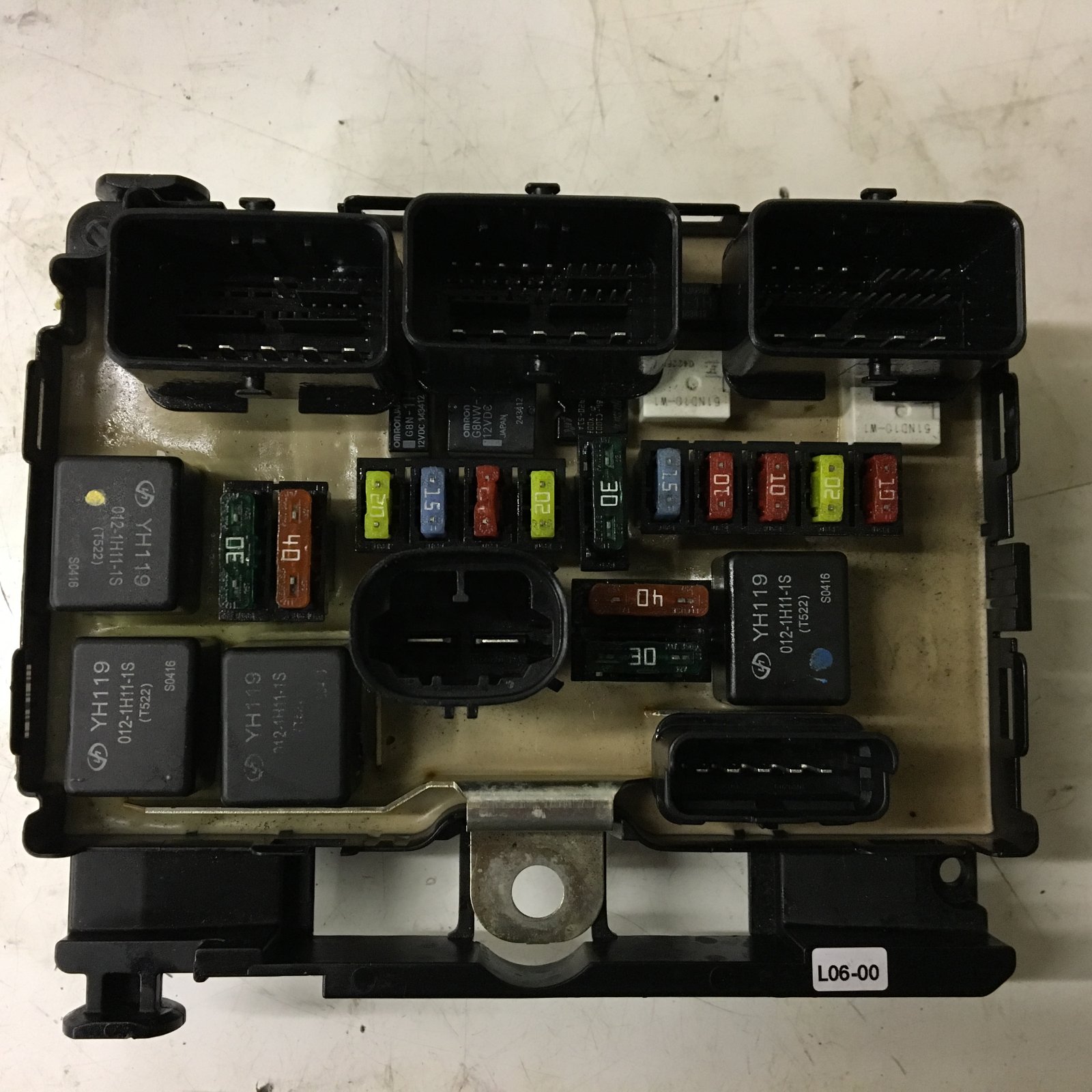

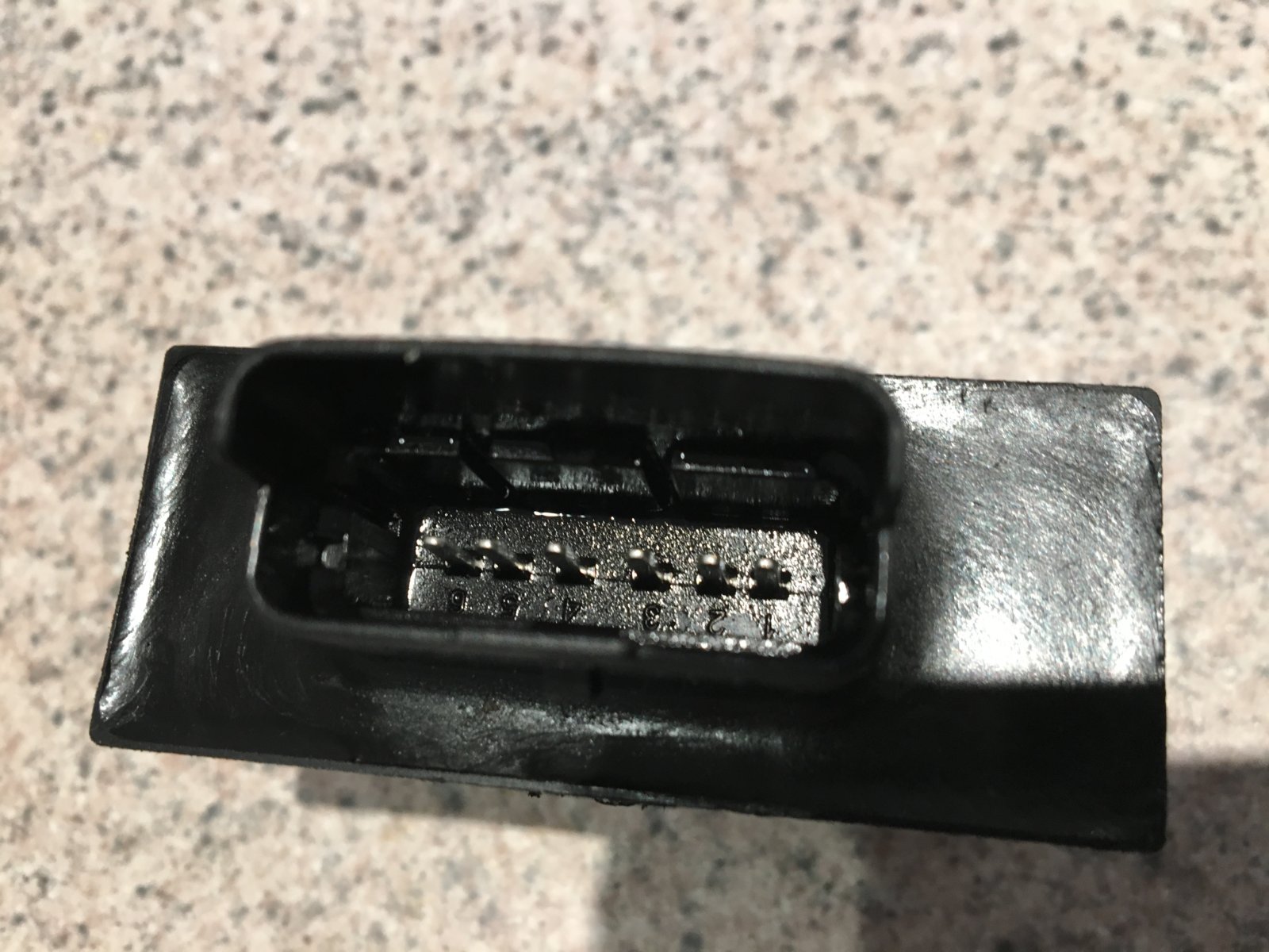

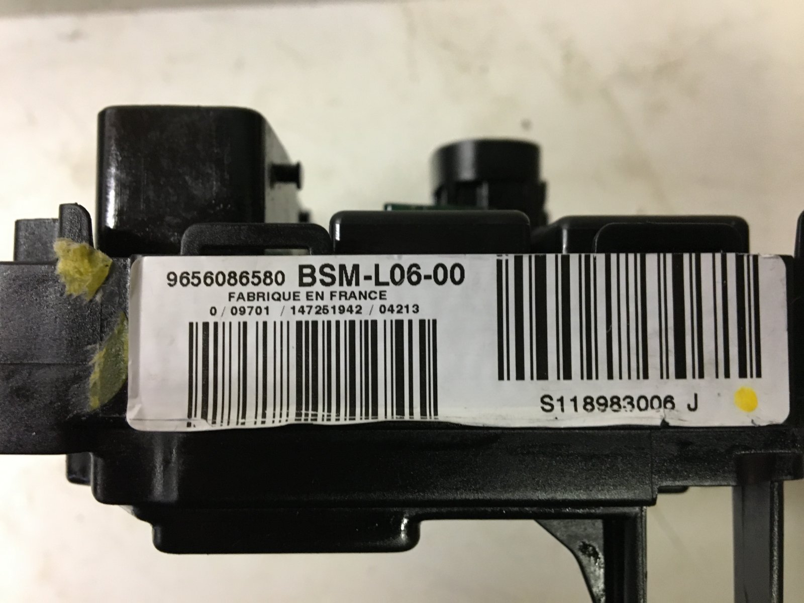

Removed the fuse box today and scrutinised all the plugs and pins but no burning or corrosion anywhere. Car has in tank pump which I have removed and tested and it is working. Which of the onboard relays is for the fuel pump. The one second from left on the board seems looser the others and shows sign of slight separation from the silicone layer at the bottom.
- x 6963
Re: C5 Fuel Pump Relay testing
The wiring diagrams don't show the relays I'm afraid only the fuses and the maxi fuses.
