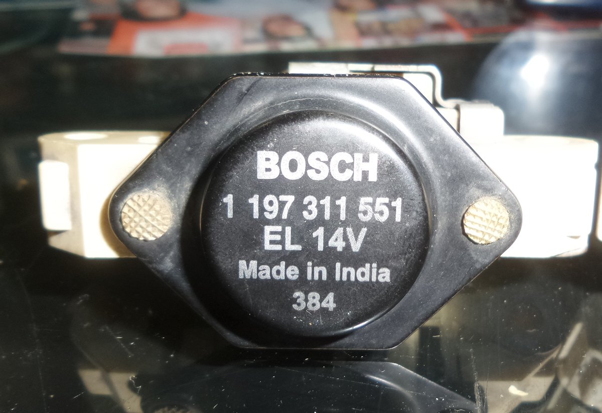

The reason I didn't change brushes and bought a second hand voltage regulator instead is that one alternator repairman in my area advised me not to change the brushes of my original voltage regulator.
He told me if you change its brushes, it will work 2 or 3 days and will stop working again.
He said I will regret changing brushes and it is better to replace the whole voltage regulator.
That's why I'm confused! Someone encourages me to change the brushes while the other one warns me against doing it!

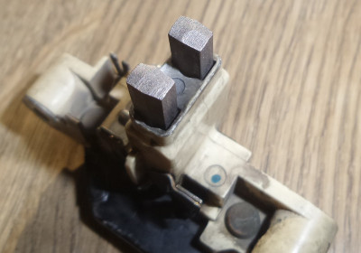

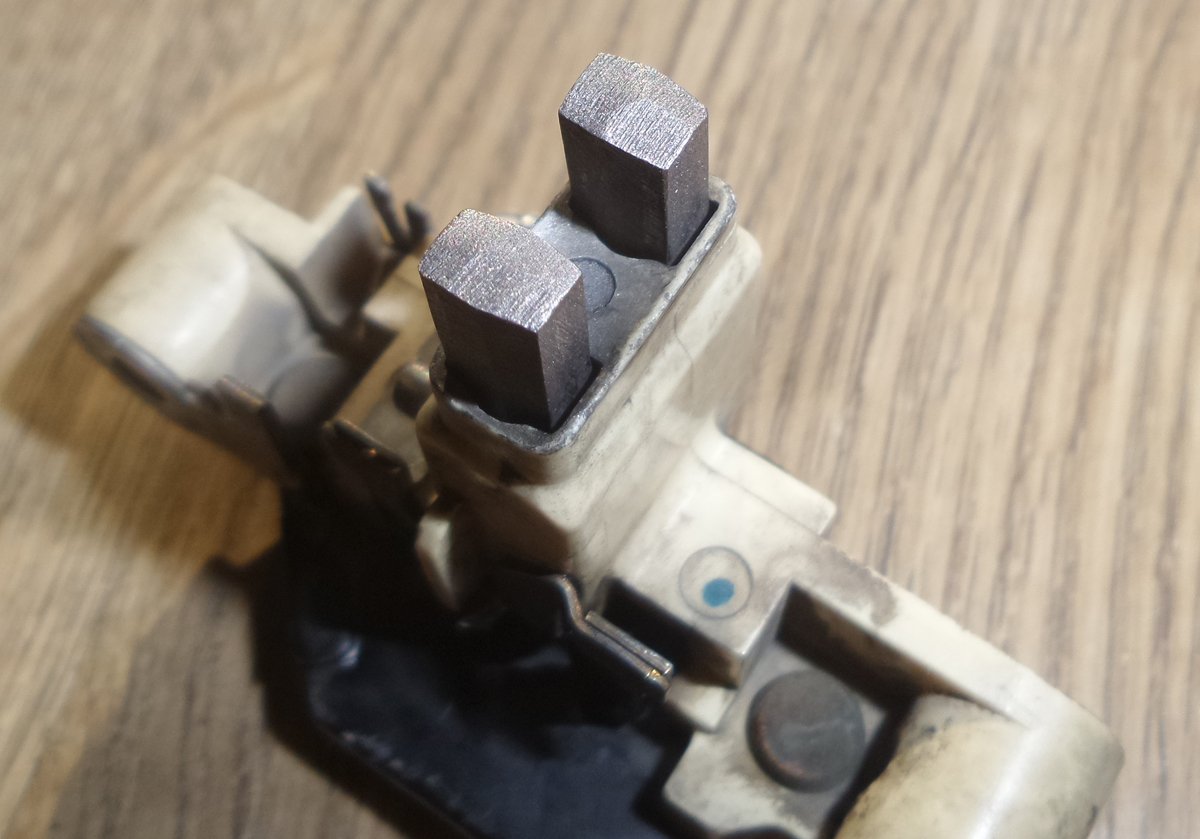

I removed the faulty voltage regulator and found someone who changed the brushes of my original voltage regulator.
This is my original voltage regulator:
The new brushes installed on it:
I fitted my voltage regulator with new brushes on the car and put everything back into place (Intake manifold, throttle body, fuel rail, etc)
I was ready to start the car with new brushes!
I started the engine but the battery seemed to be weak and didn't have enough juice to turn the starter motor but the engine started up. The battery warning light was still on and I checked the battery voltage with the engine running and it was 9.1 Volts! So, the alternator wouldn't charge the battery!
I turned off the engine and decided to jump start it. I used my father's car for this purpose.
I jump started my car and let it idle for 2 minutes (With my father's car engine off). The voltage was increased from 9.1V to about 12V but reduced gradually to about 11.89V. Then I revved the engine a bit and let off the throttle. About 1 minute later, voltage increased to 14.3V! The alternator started working and was charging the battery! The battery warning light disappeared!
I took the car for a spin to see what will happen. Everything was fine and the engine behavior was perfectly normal. After about 30 minutes of driving, I pulled over to check the voltage and it was still 14.3V! I revved the engine to make sure the voltage regulator is working properly and the voltage didn't go higher than 14.3V regardless of RPM! It prevented over-charging! It seemed the voltage regulator was doing its job!
I came back home and hooked up my PSA ACTIA code reader to check if there were any faults and there were no faults found:
What do you think now?
Why the alternator didn't work during the first two or three minutes?
Do you think the problem was solved?
I turned off and on the engine several times to make sure the alternator is working and the voltage was 14.3V, no problem.
