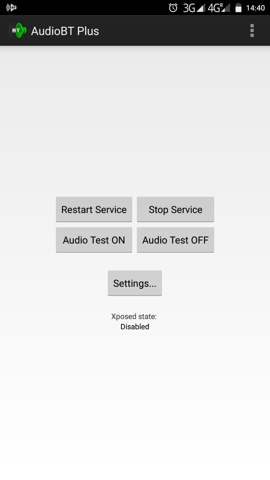

Now we can run the app and configure it :
1/ here you can manage the service on your phone, and do a quick test to make sure the sound is forwarded to the car

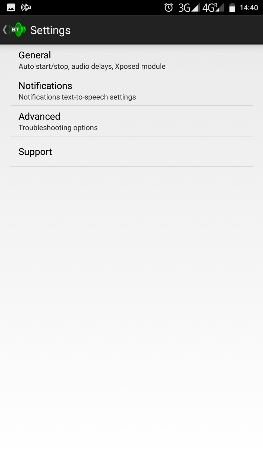

2/ Let's go to the settings

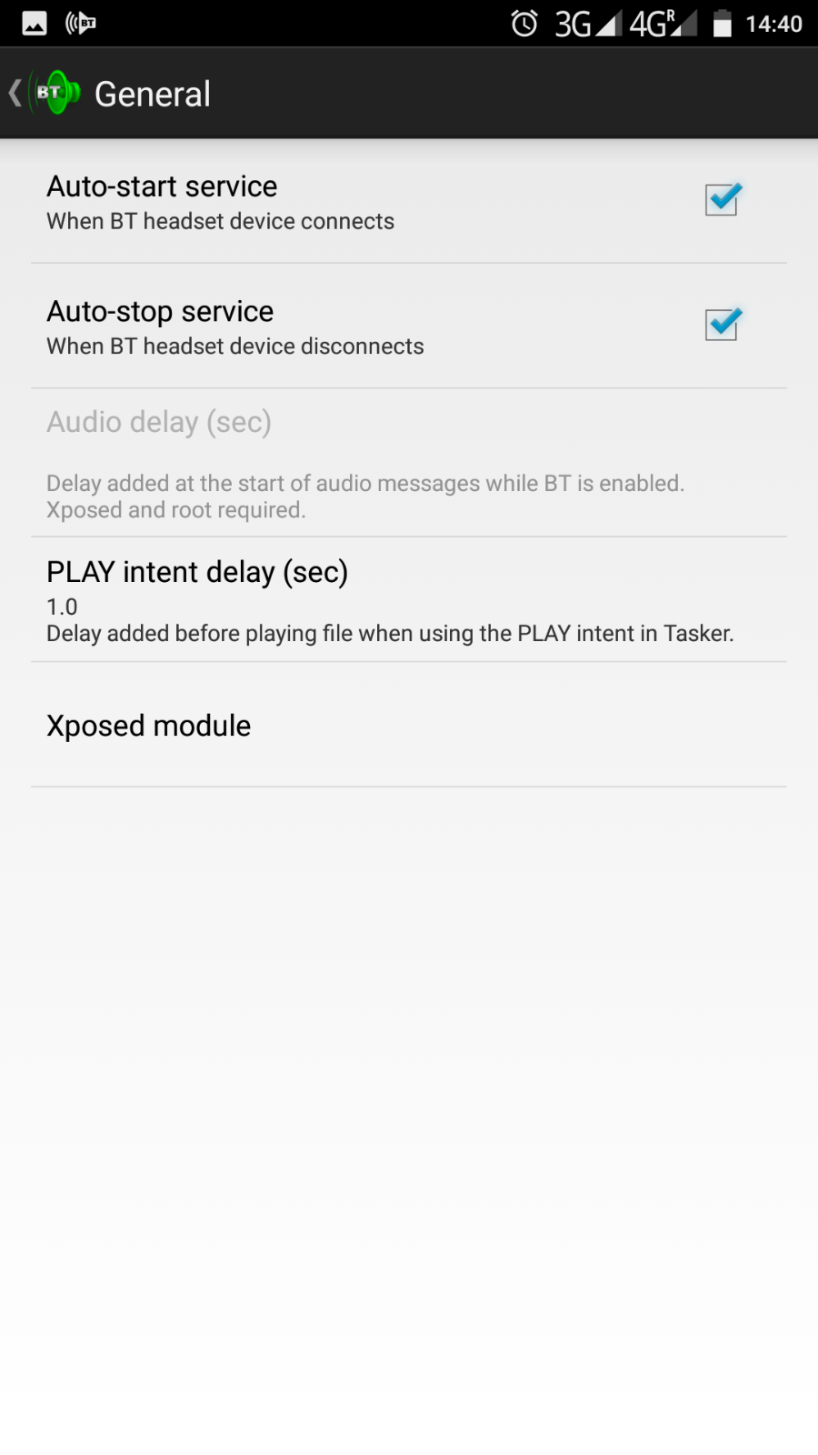

3/ General
Good point for this app is it won't take any phone ressources if there is no bluetooth device connected... and stop the service when the device disconnect.

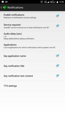

4/ Notifications
I have added a delay of one sec just to let the phone and the NG4 establish properly the connection before reading the notif.
With application name / title / content it can be a bit verbose, it is up to you :)
5/ Notifications : list of applications
Just tick what application notification will be read on the NG4

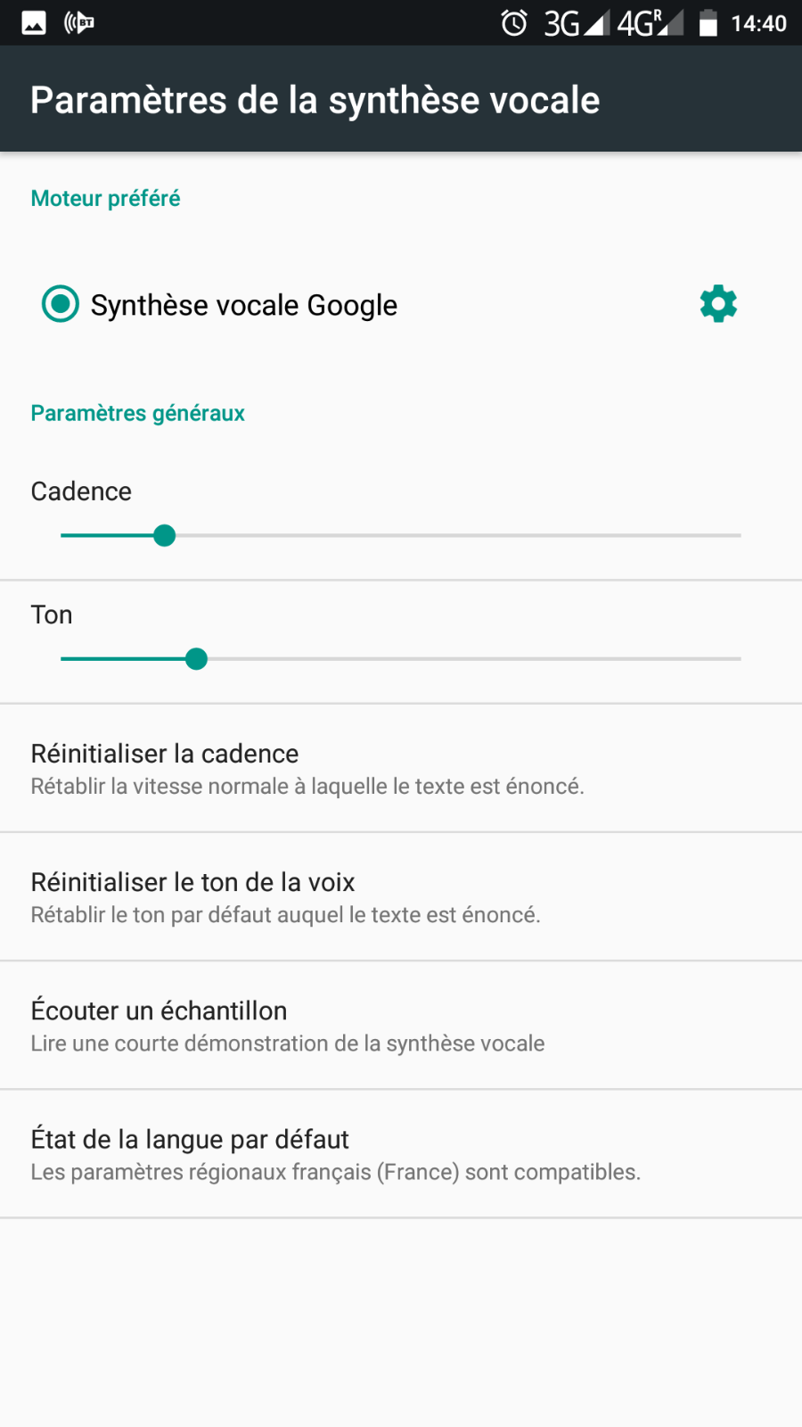

6/ Notifications : TTS settings
Sorry for this french screenshot, french ppl drive french cars you know :)
It is not the app itself, but the android parameter for text to speech (TTS). So you modify the voice there.

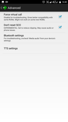

7/ Advanced
Here I tick the "don't reset SCO" option, otherwise it take ages before the phone is connected to the NG4 ... not really convenient for a GPS app :)
