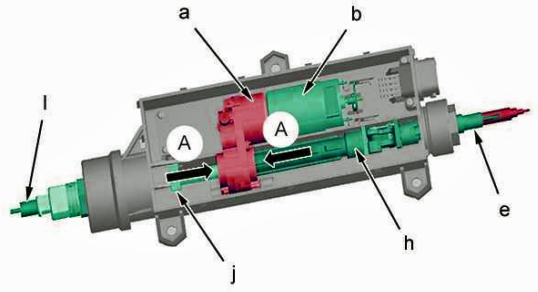

This is how they tighten and slacken internally:
Tightening
During the application phase, the electric parking brake ECU controls the motor "b" in the application direction "A".
The force provided by the motor "b" is reduced and sent by the reduction motor "a" to the splined shaft "h".
The splined shaft "h" and the threaded pin "j" are linked by the interior thread of the splined shaft "h", the rear left secondary cable "l" is linked to the threaded pin "j", the rear right secondary cable "e" is linked to the splined shaft "h".
The rotation of the splined shaft "h" in the application direction inserts the threaded pin "j" in the splined shaft "h" which draws in the right and left secondary cables.
The drawing in of the right and left secondary cables applies the rear brake calipers.

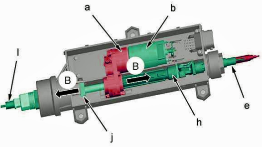

Slackening
During the release phase, the electric parking brake ECU controls the motor "b" in the release direction.
The rotation of the splined shaft "h" in the release direction extracts the threaded pin "j" from the splined shaft "h" which distances the right and left secondary cables at "B".
The distancing of the right and left secondary cables at "B" releases the rear brake calipers.
