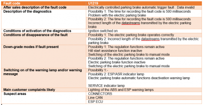

There are a multitude of faults that can occur after incorrect operation or otherwise - and the codes I have basically repeat what Lexia is saying in your screenshots.
You must make sure the EPB is not applying itself once the battery is connected back up - hence the need to put the ignition on, foot on brake and then hold down EPB button for 5-10 seconds, then switch off. Then you can try the emergency release. If you are saying it won't release then I'm not sure what has happened.
Remember the ESP controls all functions of the EPB. When there is a fault with the system it will disable all the auto functions - so I would expect it to be reporting the status as shown, plus the car isn't running so half those functions won't be active anyway.
U1219 - which really only tells us what we know in that the data isn't what is expected - that the EPB is not happy as the cables are not set properly.

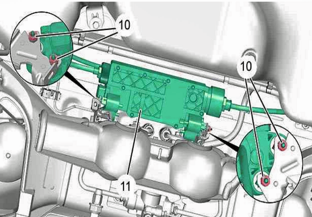

C5 X7 Electronic Parking Brake Removal Procedure
Disconnect the battery.
BSI Rest / Battery Disconnect / Reconnect Procedure
Refitting
Refit: The electric secondary brake unit (11).
Tighten the nuts (10) to 0,8 ± 0,2 daN.m.
Connect the connector (at "g").
Refit the protector (9).
CAUTION: Respect the routing of the manual unlock cable (6) and of the parking brake cables (7).
On each side:
Engage the electrically controlled parking brake manual unlock cable (6) in its housing (at "b").
Immobilise the electrically controlled parking brake manual unlock cable (6) (at "a"); Using universal pliers .
Couple that handle the (5) to the electrically controlled parking brake manual unlock cable (6).
Refit: The underbody protectors (8) and (7).

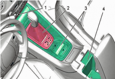

| Remove the glove box (1). Unclip: The gear lever gaiter (2). Remove:
| Pull the handle (5). Immobilise the electrically controlled parking brake manual unlock cable (6) (at "a"); Using universal pliers . Uncouple the handle (5) from the electric parking brake manual release cable (6); By means of a screwdriver. |
| Remove the under body protections (7), (8). | Extract the electrically controlled parking brake manual unlock cable (6) from its housing (at "b"). Unclip the electrically controlled parking brake manual unlock cable (6) from the fuel tank (at "c"). |
On each side:
| Remove the protector (9). Disconnect the connector (at "g"). |
| Intentionally Blank | |
| Unscrew the nuts (10). Remove: The electric secondary brake unit (11). | Intentionally Blank |

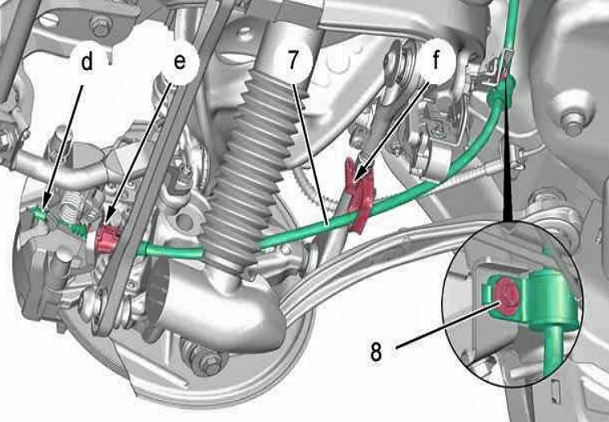

On each side:
- Position: The handbrake cable (7)
- Clip the guide of the parking brake cable (7) (at "e", "f")
- Couple the parking brake cable (7) (at "d")
- Refit bolt (8) ; Tighten to 0,8 ± 0,2 daN.m

- The oddments tray trim (4)
- The centre console fascia trim (3)
Refit: The glove box (1).
