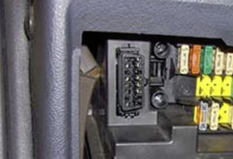

Your Berlingo is a BERLINGO VP ESTATE VAN 1.9 D 71 (DW8B) Manual gearbox 5, so has the DW8B engine with Lucas pump. This should have basic emissions fault code reading.
As this is a left hand drive model, do you have the following port located by the driver's left side?

Re: Berlingo I 1,9D M WJY 2002 wiring diagram
I will check it. But what technicians told me, the diagnose of this model is stupid and does not remember the failures..
- x 6945
You should still get some codes if it is related to the emissions equipment.
