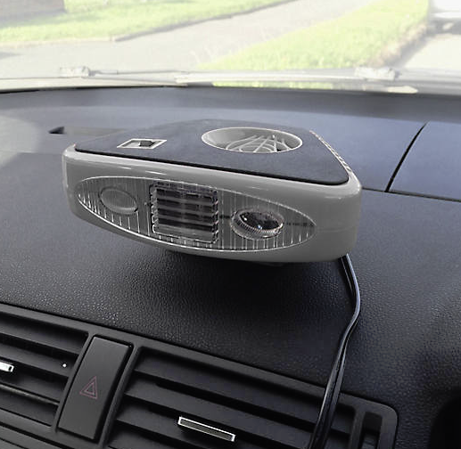

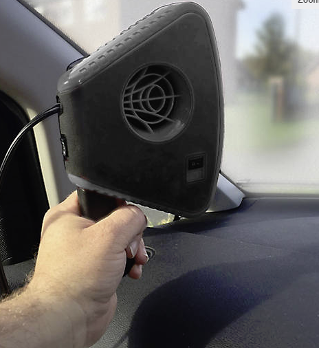

One of these?

Close enough, Chris.
...a slight correction.
white exec wrote: 28 Nov 2018, 07:38 A hot air blower to flatten the Li Po's batterys? :P
GiveMeABreak wrote: 28 Nov 2018, 09:05 One of these?
Tried something like that before, Marc. It was pathetic. All noise and rattles and no sign of any useful heat.
What I've ordered looks more like a PC fan stuck on a heating element. Crude and cheap but hopefully pretty powerful (tempting fate now, aren't I?).
