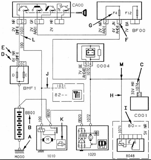

Complete new alternators on Mister Auto from £60-70 (and a choice of makes).
Looks like there is an ALT FUSE on the car, which (if pulled) would allow the rest of the car to be checked.
This may not be exactly the right diagram, but see item G on it.
