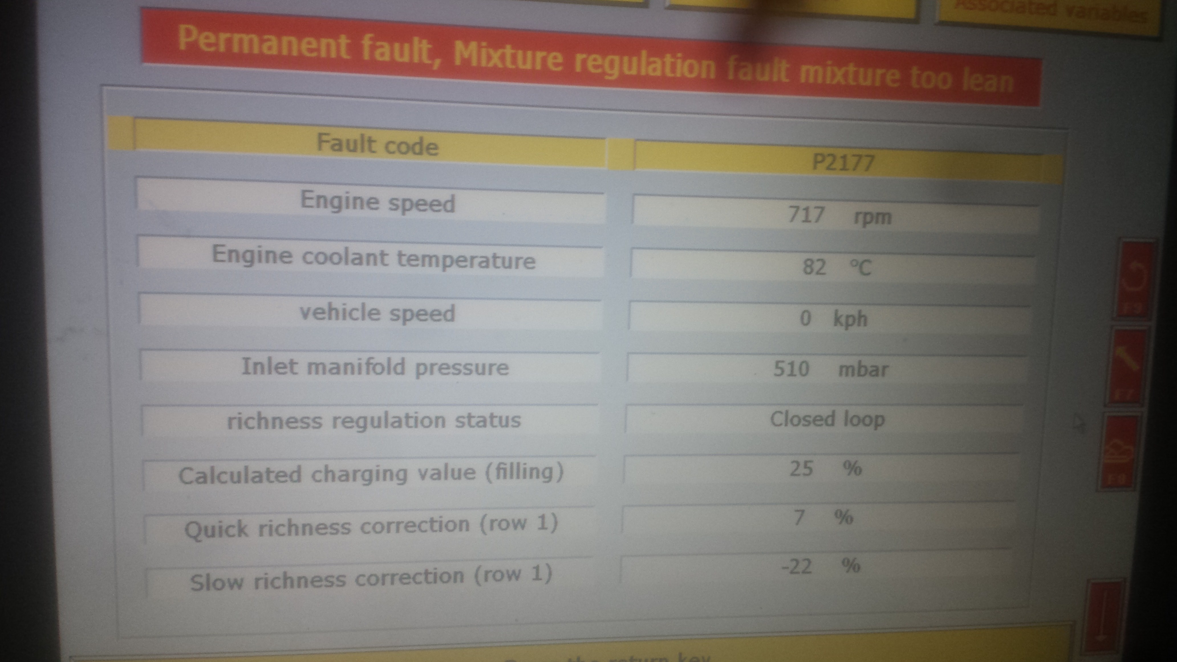

Hi,
Referring to my post
viewtopic.php?f=3&t=61276
Replaced the whole timing gear ( chain, tensioner, chain guides, bolts, all 3 gears ) including the 2 sealing ring of the VVT gear ( at the inlet camshaft ) to make sure all parts related to the timing are replace. I noticed some improvement in acceleration . After driving about 100 KM I felt that the ECU put the turbo in limp mode and lack of power but check engine did not lit. I hocked my Lexia did a global test and the following fault in the injection read "Temporary fault mixture regulation fault mixture too lean" P2177. I checked the details and found up that the fault was triggered when car speed was zero i.e when stopping. I erased the fault and the turbo came back to life - after two days the fault triggered and again it was when car speed was zero.
After the timing gear was replaced the mechanic drove the car for 100 km at sea level roads and all was well. I drove additional 100 km at sea level roads from the garage to the city I live and all was well.
I live in hilly city ( part of the city is 150 meters above sea level ) and after driving up hill and down hill ( about 6 km ) the fault triggered again. I hooked the Lexia cleared the fault and after 2 days of driving inside the city ( up hill down hill roads ) no more than 30 km the p2177 triggered again. So my observation is that it triggers when car speed is 0 and when driving up hill and down hill. I am not sure the fault is related with driving on roads that are 150 meter above see level , but it happens much more frequent. And all times it happens the car speed is 0.
The details of the error as I copy from the Lexia:
Fault code: P2177
Engine speed: 790 RPM
Engine coolant temperature: 87
Vehicle speed: 0 kph
Inlet manifold pressure: 540 mbar
Richness regulation status: Closed loop
Calculated charging value( filling ): 27%
Quick richness corrections ( row 1) : 8 %
Slow richness corrections ( row 1) : -23 %
Any ideas

I would suspect a vacuum leak, was the inlet manifold removed?
Also check the PCV hose to the manifold at the back of the engine (if fitted), I have heard of them splitting when disturbed.

Np the inlet manifold was not removed. I thought about vacuum leak and sprayed a carburetor cleaning spray around every suspected place for leak expecting the engine to rev higher for a short while if the spray is penetrated to the inlet path due to a vacuum but it did not happen the engine revs steadily. I guess this procedure is not 100% checking for leaks. The interesting fact is that the fault is triggered only when vehicle speed is 0. Can one of the sensors give wrong values ? Reading the causes for this fault indicates it may be an injector but than why does it happen on 0 speed ?
Thanks

I did a bit of web searching, but there don't seem to be many confirmed cures for that fault code on the EP6 engine. Some claim that it is due to a slight valve timing error (which might be relevant in your case), others that it is a sign of a failing high pressure fuel pump.

The high pressure fuel pump was replaced a month ago with a genuine new one. The whole timing gear was replaced a week ago. The only clue I have is that the ECU triggers the fault only when vehicle speed is zero.

Re: THP Engine fault P2177 - Mixture regulation fault : Mixture too lean.
Hi
Well the fault reappeared this time it reads PERMANENT: MIXTURE REGULATION FAULT : MIXTURE TOO LEAN and the check engine lit. At previous times it was TEMPORARY so I guess this is the reason why the check engine did not lit. Below is the screen shoot of the fault screen. It can be seen that it happens of idle on speed 0. The Inlet Manifold pressure seems a bit high for idle should be 420-450 mbar. Clearing the fault took out the turbo from limp mode. I checked all parameters that have an expected value an all are OK.
Does diagbox give readings for the fuel pressure set-point and measured fuel pressure? if so, can you show us those readings?
