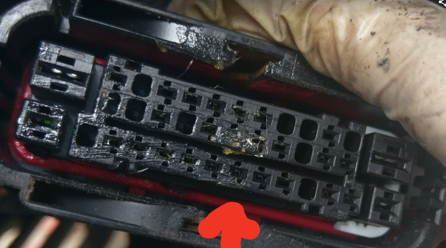

Its the same as this one.

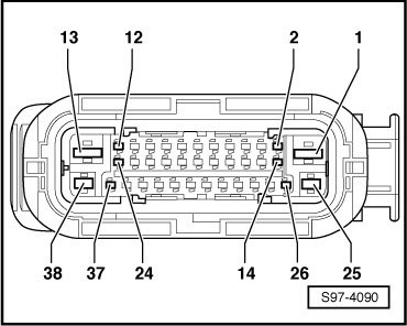

I found this diagram. I think this is it.
Thank you for the help it's much appreciated.

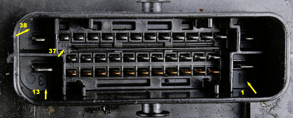

Look at this photo - it is similar to the one you have although not the same - but you get the idea - there are little numbers on the corner pins of the plug - you can then work out what is what:
Just make sure you check the numbers on your own plug as again this is another type of plug and you don't want to use a diagram for another plug

Yes your diagram is the male side where I posted the female side. I'll probe the plug end and see what voltages I pick up and see if they correspond with the info you shared. Thanks for your help!

Ok I checked the voltages and everything look good. My initial problem here is with a few cheaper OBD reader I get no comms with the ECU. With Diagbox & Lexia I get an ECU, ABS ECU incoherent fault (U1208), but it does scan through the different systems and read fault codes. I presume the fault on the car is effecting the CAN bus. Since I cant disconnect the ABS/ESP ECU from the circuit to isolate from the CAN bus and test , I'm not sure where else to go other than buy another ABS unit and hope it solves the problem. I don't really like this idea as its not diagnosing the fault really. The symptoms with the car is that the ABS fault light comes on the dash every so often and when it does happen seems to do so at lower speed e.g 46kph. Not sure where to go next.
