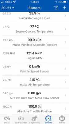

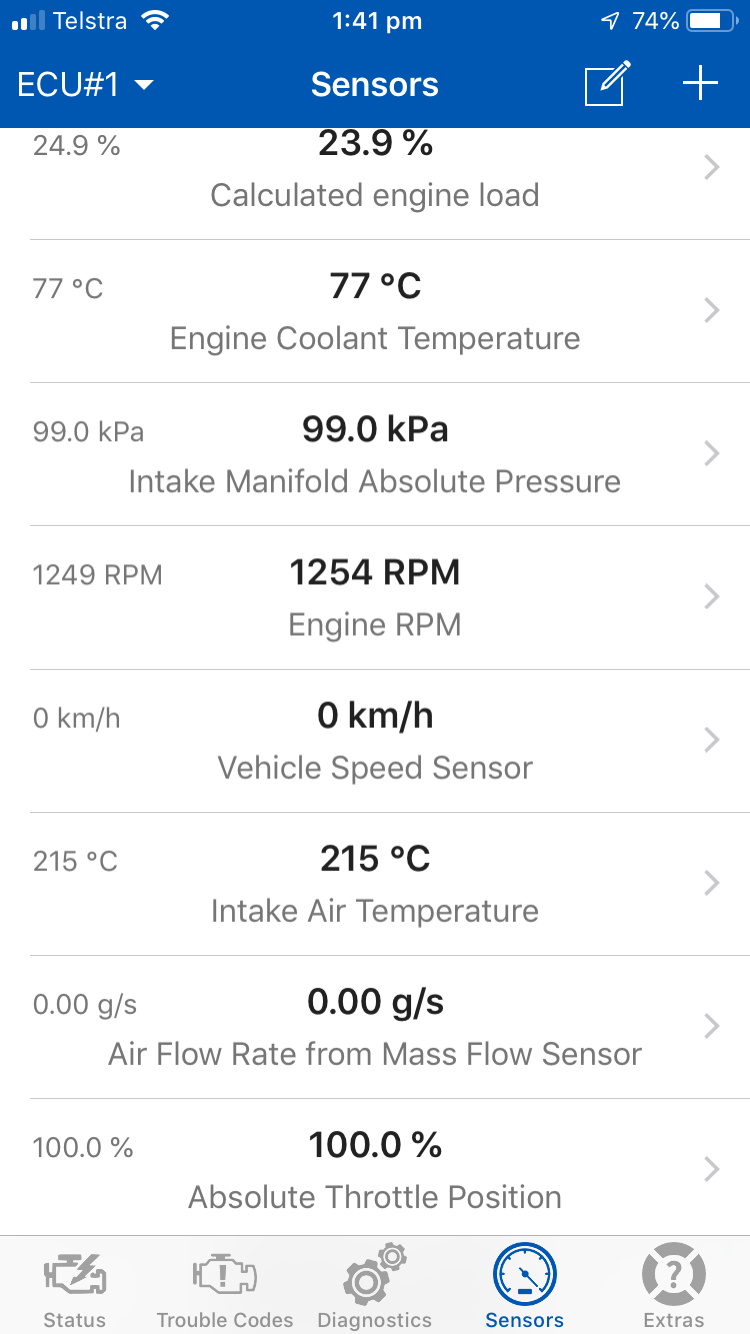

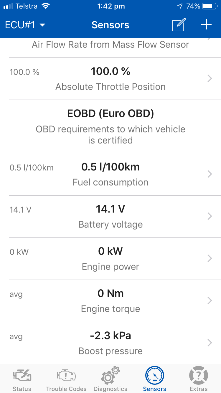

I had a look at the live data from the reader and this is what I saw (note the MAF was unplugged at this point) Interesting to note the intake air temp was reading 215deg no matter if the MAF was connected or not. Also with the MAF connected the airflow was something crazy like 300gp/s.

Does anyone have any ideas? Have I cooked my ECU??

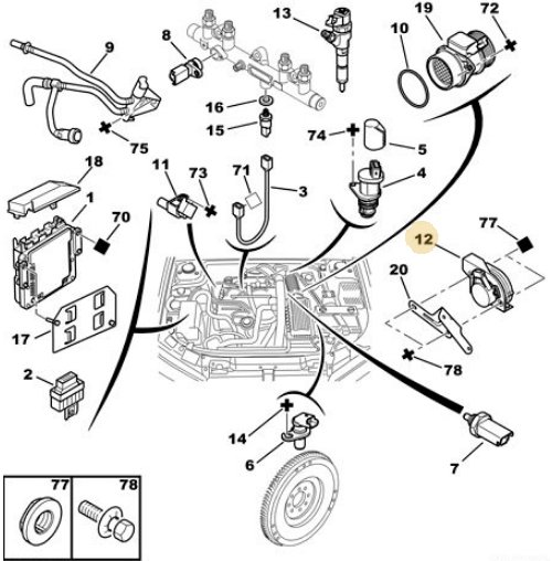

The wiring diagram indicates:
| TPS 1377: White = Accelerator pedal 1 position info 1378: Yellow = Accelerator pedal 2 position info 1391: Red = MIL-REQUEST signal 1392: Green = EOBD warning info | MAF 1408: Green = volts turbocharging solenoid valve / supply CC17: Pink = Engine Fusebox F5 Relay 5 1410: Red = turbocharging solenoid valve earth 2 1447: Yellow = turbo "bypass" butterfly solenoid valve 2 control 1448: White = compressor 2 air temperature signal |
