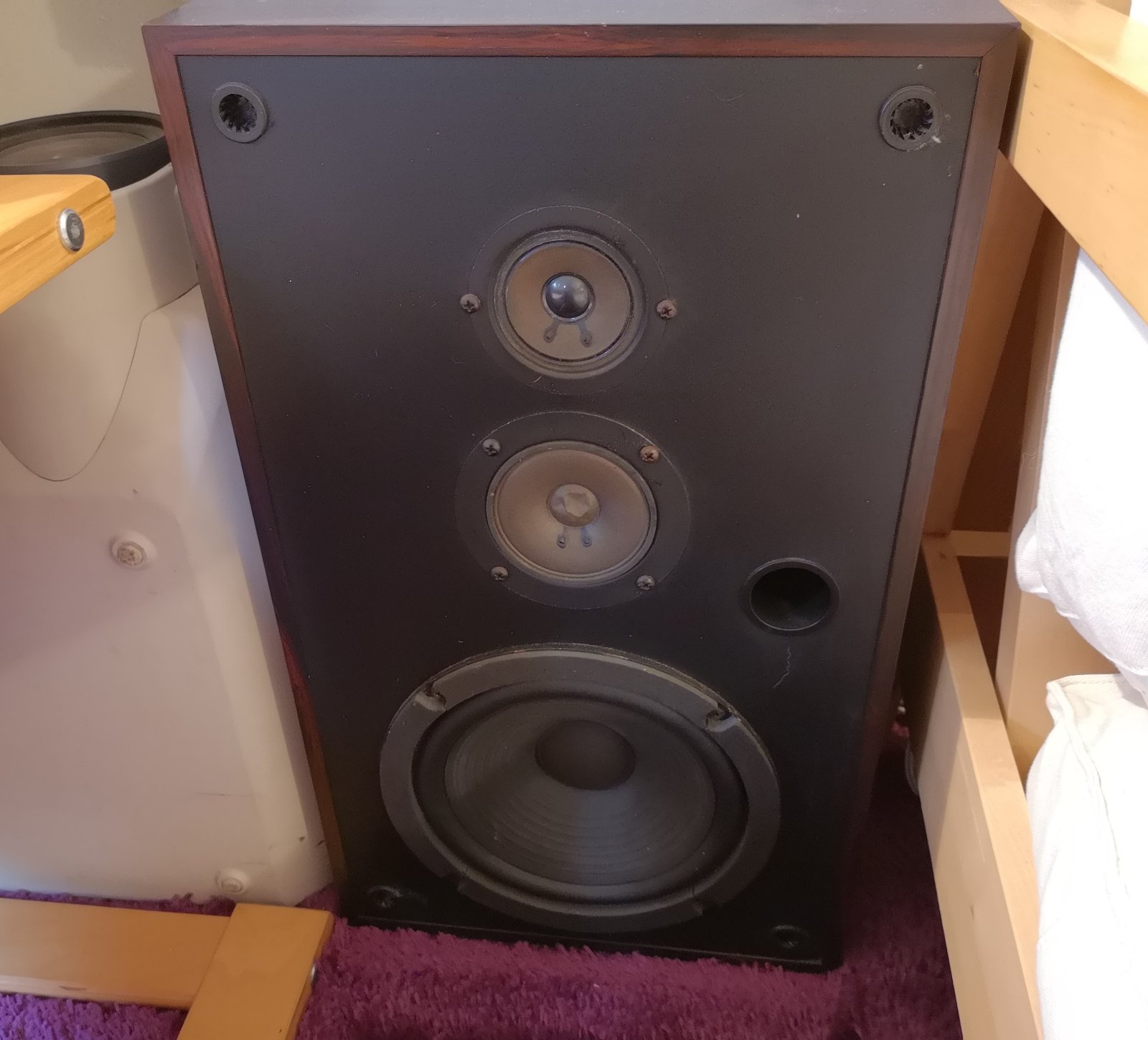

It's astonishing what you can do with a properly designed enclosure.
I made up a set of bookshelf speakers for a friend a few years ago using bog standard automotive drivers, and that sounded as good as anything I've bought off the shelf.
My main system is still using a pair of Pioneer CS-585 speakers with an automotive sub stuffed away in the corner just helping round out the bottom end (my logic being that a sub is a sub, seems to do the job just fine), and it sounds just as good as the multi thousand quid setup a friend has.
The party trick is still being able to make the sofa walk across the (concrete) floor if I really crank it up, though there's really no need.
I think that's what sets apart a really decent system, the ability to make the sound fully immersive even at relatively low volumes.
