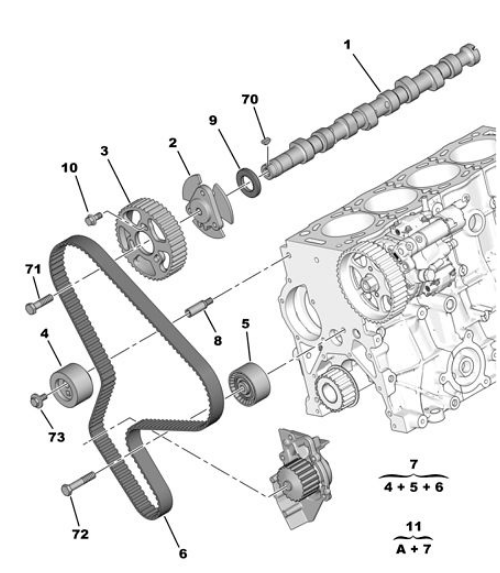

Ok, I have put the part numbers into a table for both vehicles and they are identical parts for these timing kit components based on the VIN numbers you supplied. I have used the latest replacement part numbers from Citroen Service where these have been changed from the originals and I have listed the OEM original parts first, and underneath for each model (where available) the cheaper equivalent parts listed by Citroen.
I also included the 2 types of Timing Belt Kits - as as you would expect these too are identical.
As far as the bolts go - these are the same too as per the diagram - if they are any of those shown in the diagram - as essentially, the same diagram is used by CITROEN for both these VINs.
Bolt (10): Diam 8x125-18
(71): Diam 10x150-40
(72): Diam 10x150-50
(73): Diam 8x125-30
