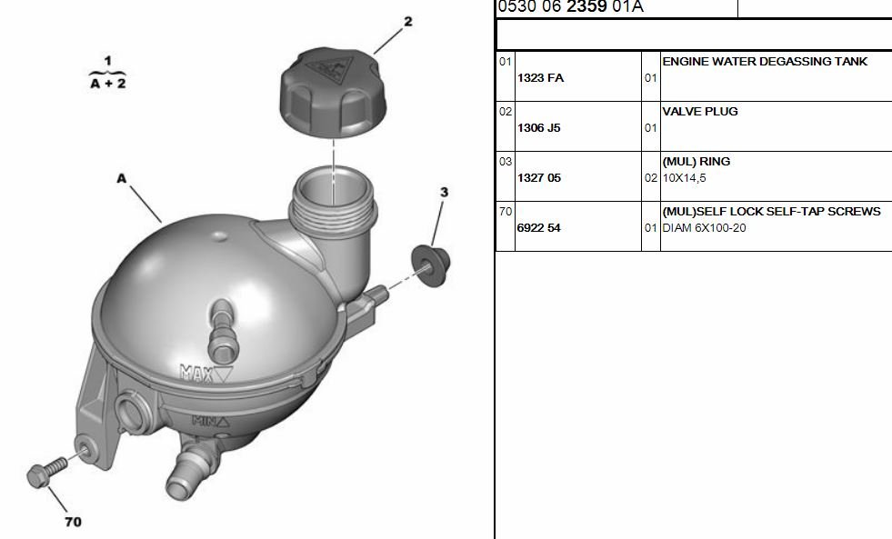

What I was asking above was: if you let it drop to a low level (but still visible) in the header tank/reservoir, does it continue to fall, or does it stabilise that that point?
Also a bit puzzled by your saying the reservoir has a capacity of only 300ml (is that right?), but expansion can be 400ml. That doesn't sound correct, and would give you a nearly-always empty reservoir. Something not right here.
Is this the expansion tank you have? What diameter is it?
Cutac

Expansion tank is 2L in capacity, I don't know where I got 300ml from.
I think level does continue to lower since at one point it was at the very bottom of the reservoir.
It's tricky to find the leak since I don't know when it'll happen and I can't look for it every time I drive the car. That's why I'm thinking of adding a dye or Liqui Moly Radiator Stop Leak.
