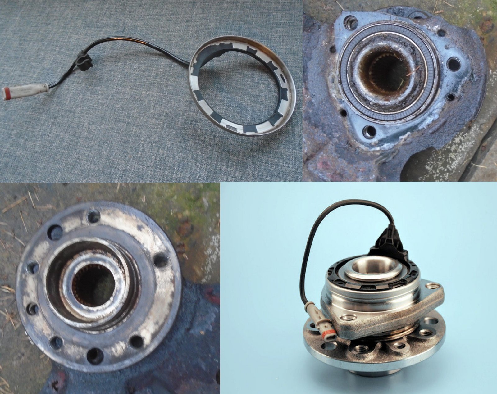

.and the job?.....in pictures
ABS sensor looks OK, but you get a new one with the replacement bearing/hub. Loads of white crusty galvanic corrosion though probably causing the ABS light to come on.
