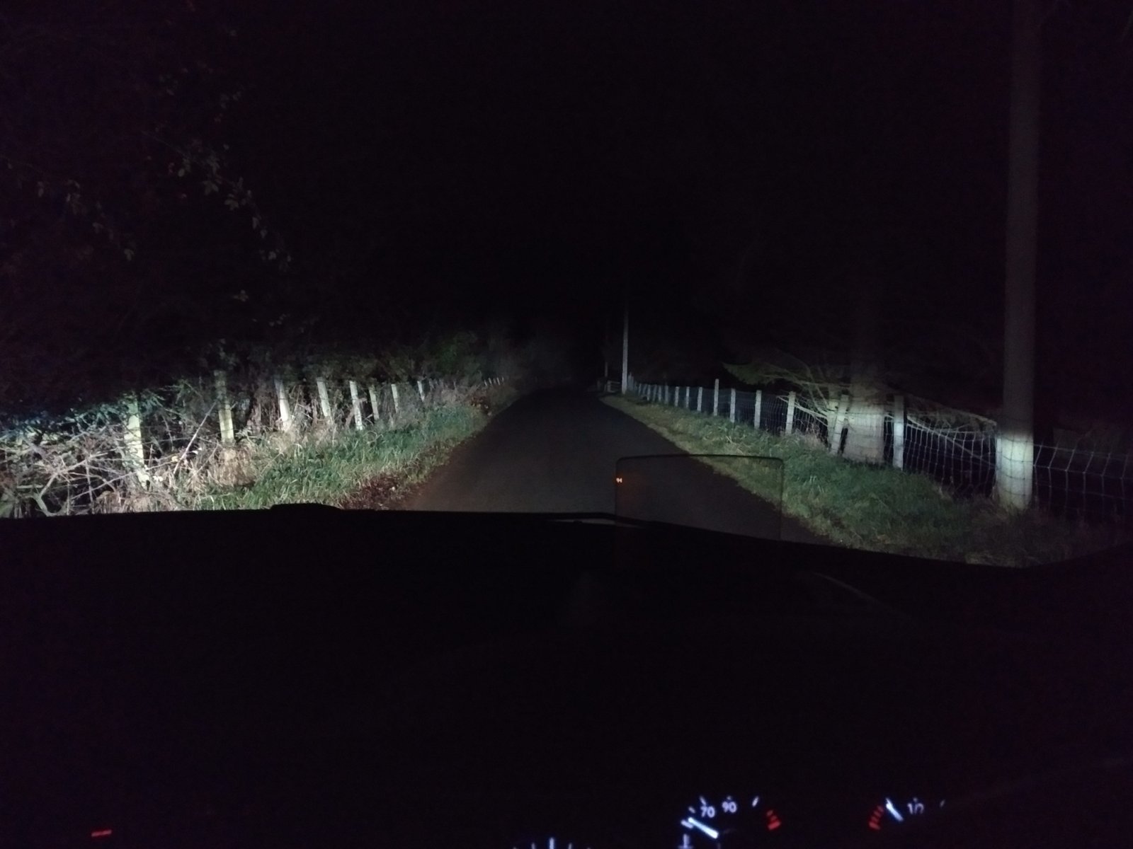

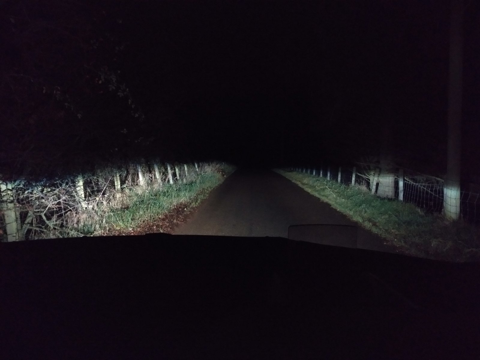

On the way home from work...note the odd spread of light. From inside the car, the bit on the RHS is not visible, making that side mostly dark.

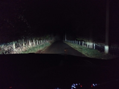

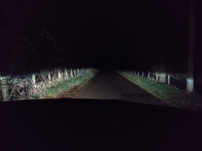

A short time later...
Dip
Main

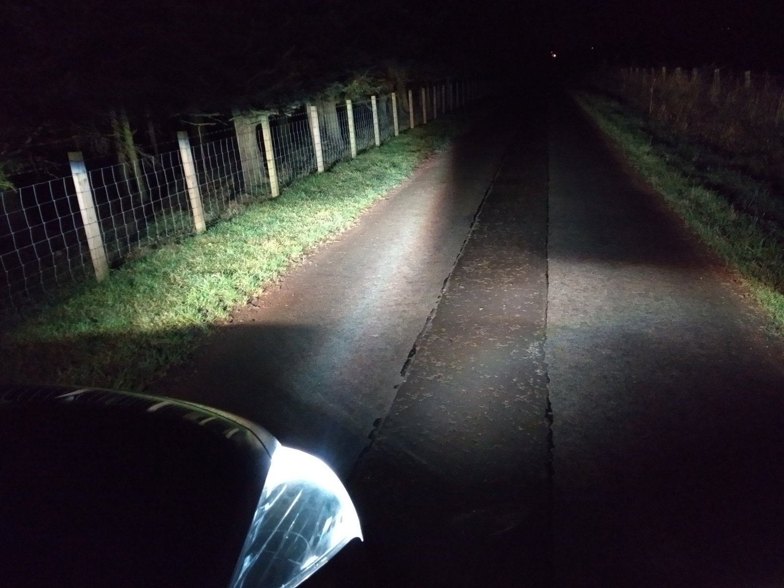

Note a nice even spread of light, and a difference between dip and main - difficult to pick up in the camera, but you can see the telegraph pole highlighted well up the road in the Main picture.
So, yes, my fault - neither was in properly: with the clip turned and the bulbs properly re-seated, they are the lights I thought they should be! Thank god for that....

Like driving a different car this morning - on the old bulbs there was no difference really between dip and main, and dip wasn't very good. Now the deer(*) in the next county are quivering when it's on main
