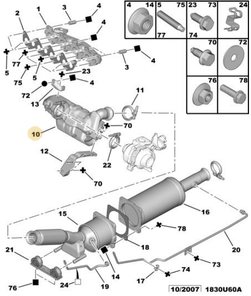

Anyone know the price of the front manifold cat part

Citroen replacement part number: 1706Y5. Brand new OEM is £1145.72 inc. VAT
or they do an equivalent, part number: 1612916180 at £800.54
Item 10 which is shown with the heat shield on of course. Normally you would also replace the fitting clamps at the same time.
Here's an example one from BM Catalysts on the Bay - not sure of the quality, but at least you can search on the part numbers now.
