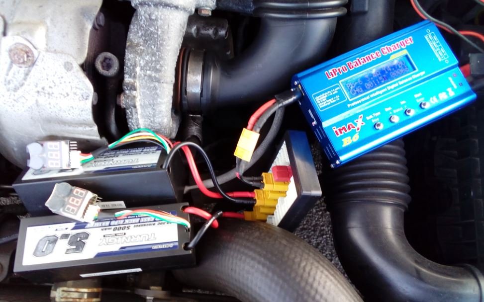

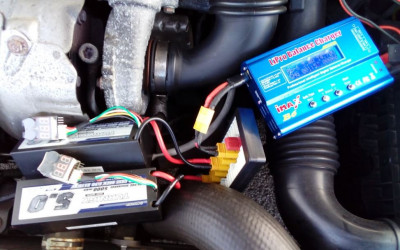

First test of C5 maintenance charge currently in progress.
Despite the lack of under-bonnet space, I managed to squeeze in 2x 4S 5A LiPo packs, a parallel charging board and Pb charger within the short constraints of what cables I have. As more parts/accesories arrive I should be able to make it more compact and secure but for now I'm just grateful I can lock the car up, retreat indoors and keep warm while it does it's thing.

Will you be able to get some pictures of the setup? as I'm very interested in this

Re: DIY cranking or booster battery pack
Will do tomorrow, am just about to crawl under the duvet for the night, brrrr!

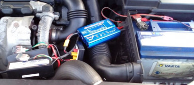

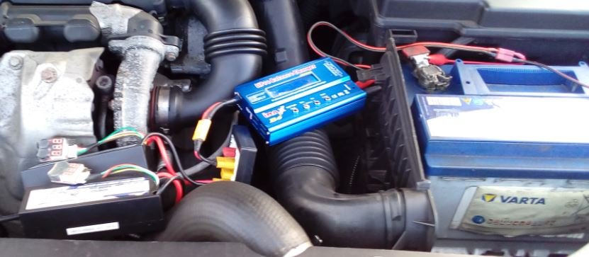

Battery reading 12.0V after unlocking, waking up ECU's and running the hydraulic motor.
It's back on charge now with same setup as yesterday. I can close the bonnet but haven't fully latched it down. That way I can lock the car and periodically check the status without waking up the systems.
LiPo's on the left with individual voltmeters plugged in connected to the parallel charging board inthe middle powering the Imax charger on the right running the Pb Charge 6S program at 5A max with no time or amperage cut-off limit until it considers it fully charged.

Blimey Mike - there's no way I would contemplate having anything like that under the bonnet - knowing my luck I'd forget about it and drive off with all that gubbins under the bonnet and probably go up with a bang down the lane!MikeT wrote: ↑30 Oct 2018, 08:44 I bought one of those solar panels from Maplins about 12 years ago and it killed the battery beyond recovery within a day or two.

The C5's off the road due to a fluid leak and other needed repairs, Marc.
Chris, those batteries are about six years old though still good as new, unlike my 6 lead acid batteries.
