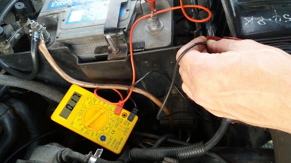

Thanks Chris. That seems like a whole lot easier way of doing things than comparing Battery Connected / Disconnected readings as I have been.
I did try this back in the summer when after investigation I'd decided there wasn't a problem. However a flat Battery two weeks ago after sitting unused for 4-5 days changed all that; it was so flat that even the Ignition lights were dim and obviously turning the key had no effect.
Having forgotten how to do it, I reminded myself via Youtube (I used

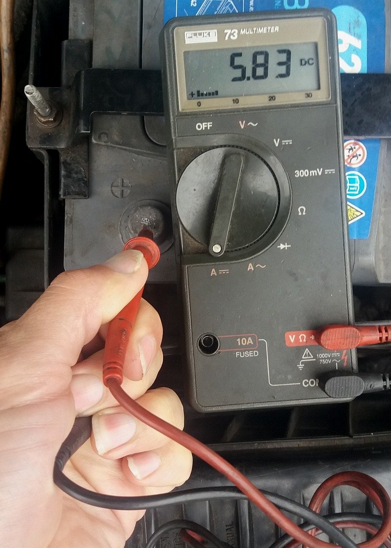

....but I seem to be getting a nonsense reading approx 1000x higher than the 50mA you suggest.
Am I doing it wrong, or do I have a massive 6A Drain? ...surely its me?
Reason: Fixed YouTube Links
Puxa
x 1750
Re: Compression: Turnover
Check the accuracy of the meter (on that DC amps range) by trying it with a bulb or two, eg 21W (1.75A), 5W (0.4A), etc. Also try the meter on the 10A range; sometimes just one range on a meter goes screwy, but another will work. Check that the meter's own battery is ok; readings can go wonky if not good.
6A is one helluva residual drain, and enough to flatten the battery in less than a day. I have once found a drain of 3A (on a Toyota, caused by an idiot auto-electrician fitting alternator connections the wrong way round), and this flattened the lump in a couple of days.
If you still have that big drain, leave the meter in place, and pull fuses one at a time until the drain drops back (to a sensible figure). That will tell you where the offending toaster is.

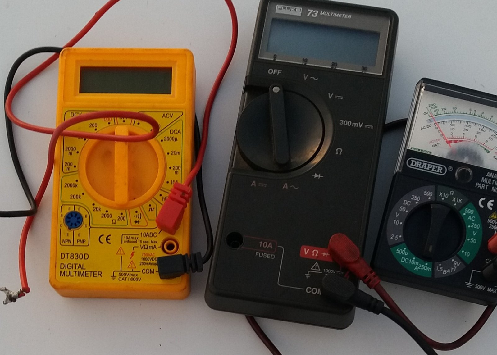

The Fluke Multimeter managed a reading of 6.21A this afternoon, a new PP3 had no effect and I was a bit mystified about the Bulb Test idea. I tried connecting it as you would for Continuity, ie to test for good filament, but got nothing; I guess that's not what you meant, but no matter; the little yellow Meter has proved that reading to be just nonsense.
I hadn't considered the fact that the Meter might be at fault here, so particular thanks for that inspiration. Bodging a connection to the Yellow Meter using the Fluke Probes (its own probes are broken) I got a reading that fluctuated between 0.05A and 0.22A, when I could get a good connection; so a new Multimeter is on order and hopefully that'll permit me to get some reliable readings.
I'll update when it arrives, hopefully with news that I've at least traced which Fused circuit is at fault.
(naturally, all three sets of Probes have different size fittings to the Meter, so aren't interchangeable).
Multimeters L-R
Yellow: Broken probes, but appears accurate. Attempts to bodge new ones using a wire wrapped around an insulated Precision Screwdriver failed.
Fluke: wildly inaccurate
Draper: gives a bizarre reading also '220' in this case.
Puxa
x 1750
Meters! Best of three!

The old analogue (Draper) meters tend not to develop faults, and can remain accurate more/less indefinitely.
The way they go awry is if too large a current is shoved through them on the Amps range, and the internal resistors get cooked before any internal fuse blows.
