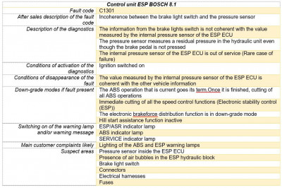

Here is the data I have for those faults. As you can see the downgrade mode will switch off all speed control functions like Cruise Control and Speed Limiter - so that fault is very likely to be expected and will probably disappear when the main fault is fixed with the Wheel sensor / ESP System.
As you can see the operations of the parking brake are all related to the ESP ABS ECU as I mentioned earlier. There are several suspects listed on each table - all of which can result in the problem you have.
Click to magnify these tables.

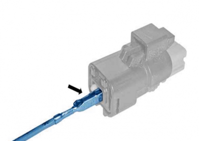

And now the blue wire on battery fuse box has snapped at the terminal and I can't get the crimp out
Does anyone know how to remove these crips from the fuse holder
Cheers

As for the wiring - not sure if this helps, but the pis may have a 'lock' bar that is slid to allow removal of pins and moved over again to secure once the pin is reinserted. So check on the end of the connector for a small release bar or wire that can be lifted or moved. Generally, this is where some heatshrink repairs may be needed if the wires are broken in the loom. Kits like the one below are a couple of £ now
