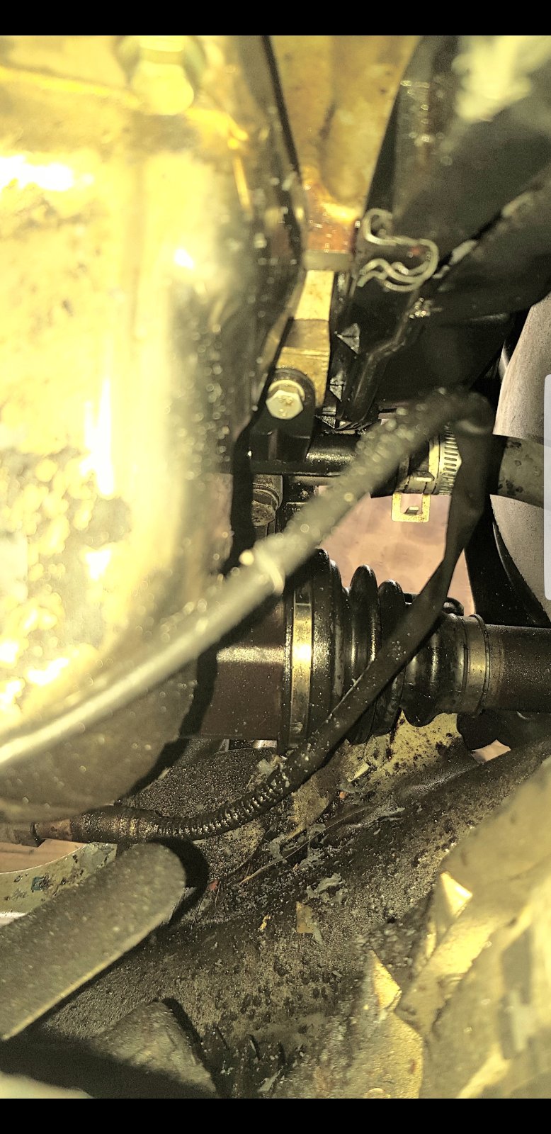

Also one of the o2 sensor behind the engine is very dirty due oil leak from valve cover. Please see the attached photo

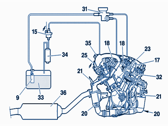

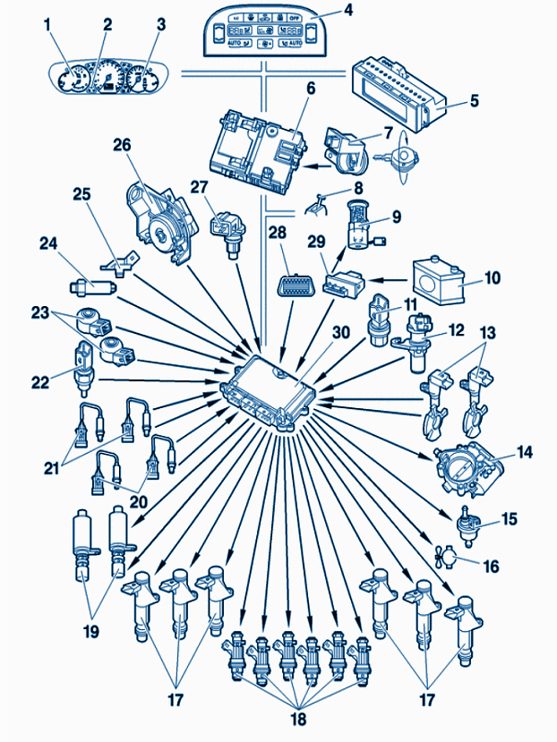

Ok, so here are all the components of the Bosch Injection system for you.

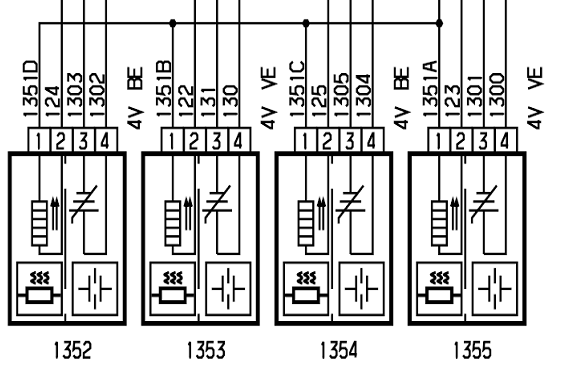

The Downstream O2 sensors have 4 wires. Here are the 4 Sensors Up & Down Front and Up & Down Rear. I think the one reporting the error is 1354. On this sensor, here are the wire codes:
1351C: Lambda sensor heating power supply
125: Control Heating Lambda Sensor D Downstream Catalytic Converter
1305: Signal from Lambda Sensor D (-) Downstream of the Catalytic Converter
1304: Signal from Lambda Sensor D (+) Downstream of the Catalytic Converter
Here are the components and 21 is the downstream sensors s0 you can see the location:
Your best bet is to use Lexia on it which will give you the live data on the O2 sensors. This should easily tell you the voltage - this video demonstrates (non-Citroen), but you get the idea.
If you don't have a Lexia, then either another diagnostic tool capable of providing live data or you'll have to backprobe the wires, which can be awkward - but is explained here on a different vehicle:

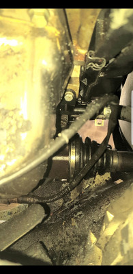

I noticed there is oil leak around exhaust, don't know if it is from previous rocker cover oil leak or it is coming from exhaust. Please see the attached image for exact location with red arrow. Could this be causing this error??

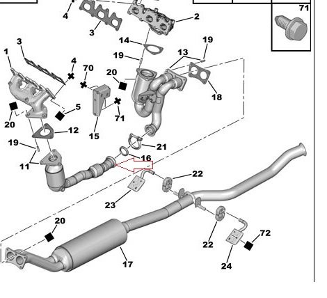

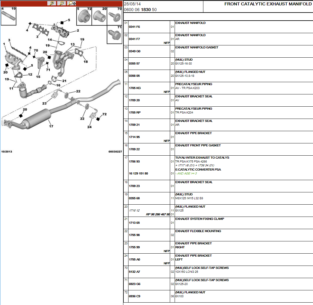

Here's your catalytic converter, item 17: Click the picture to zoom.
UK prices form Citroen - but you will hopefully find a supplier of these down under.
Part numbers:
Original: 170693 - £371.03
Alternative: 1612915180 - £739.70

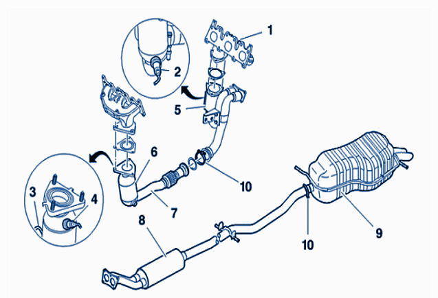

Whilst 17 is the main CAT, Marc, I think this fault is pointing at something different... You will note it says specifically 'rear bank' - and on the diagram there is no sensor D/S of the main cat... If you look back at the picture you posted at the end of October, you can see the sensors listed:
i.e. Item 2 is the rear bank D/S sensor and item 5 is the rear bank pre-cat. So the fault code is pointing a fault here, rather than the main cat (about which the ECU knows nothing). I would be looking at the live data for the rear bank D/S sensor first to see what it is doing, esp since it is covered in oil! The rear bank cat is an eye watering £823, the O2 sensor 'just' £192 (although this should be available cheaper aftermarket).GiveMeABreak wrote: 27 Oct 2018, 10:57
Ref Designation Reference Tightening torque 1 Upstream Oxygen Sensor (Rear) A 258 040 232 5 ± 1 daNm 2 Downstream Oxygen Sensor (Rear) A 258 040 232 5 ± 1 daNm 3 Downstream Oxygen Sensor (Front) A 258 040 232 5 ± 1 daNm 4 Upstream Oxygen Sensor (Front) A 258 040 232 5 ± 1 daNm 5 Pre-Catalyst (Rear) TR PSA K 160 3,3 ± 0,5 daNm 6 Pre-Catalyst (Front) TR PSA K 159 3,3 ± 0,5 daNm 7 Front Flexible Pipe - - 8 Catalytic Converter TR PSA K 175 PSA 4149 3,3 ± 0,5 daNm 9 Rear Silencer PSA 4143 - 10 Collars - 2,5 ± 0,3 daNm
