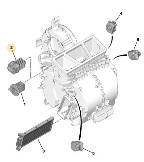

Ok, so C4 5 DOOR SALOON 1.6 i 16v 110 (TU5JP4) Manual gearbox 5
Here's the Heater Detail - the Heater Motor Control Module is item number 2.
Part 6441S7
£135.60 From Citroen

Ah nice OK. This could cause what I am experiencing then? (I.E. Going around it with the splice it so it actually works?) Reason why I am asking is because I heard if the this fails it normally only works at highest speed and not just lower speeds, where mine won't work at all unless I use that splice hack above.
x 6945
Re: C4 AC Blower Fixed, but is there a way to add a delay?
It's just another possibility for you to consider - some of these can work on full speed or nothing, others nothing at all - so hard to tell. But I would be wary of bypassing the fusebox to be honest.
