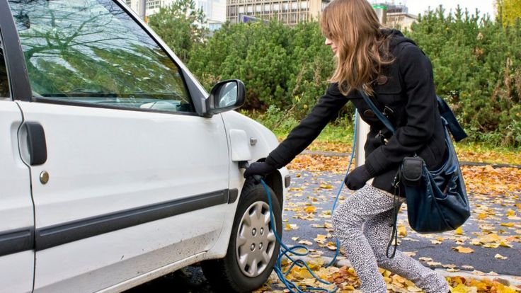

The BBC ran this article today about the ban on petrol and diesel vehicles.
https://www.bbc.co.uk/news/uk-40726868
The car in the picture that accompanies the article... This one...
BBC News Website
BBC News Website
Looks to me a bit like an electric Saxo...
Is it?
Or is it my imagination?

CitroJim wrote: 19 Oct 2018, 18:20 The BBC ran this article today about the ban on petrol and diesel vehicles.
Is it?
Does indeed! Never seen an electric Saxo in person, but have done plenty of miles in an electric 106, so I'd assume they were out there at some point.
Really liked them...our ones at work solved the thorny issue of heating with a tiny petrol burner which heated a liquid loop and a standard heater matrix. The heater in them was absolutely epic, heated up in next to no time and got to levels of hot that only Lada's, Saabs and Volvos usually manage. Tank was a gallon and used to last several months of daily use...so the environmental impact of burning a little bit of petrol for heat can't have been too massive.
I have to admit that I'd really love to find one for local duties...but remember having a look a couple of years back and decent ones seemed to change hands for way more than I could justify.
