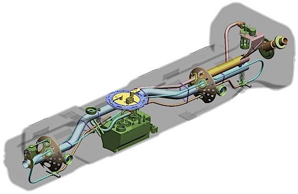

I found this on the net, it's a typical tank gauge unit although not specifically Citroen. the outside will be covered in a gauze filter, it occurred to me that if the gauze is clogged part way up and the fuel cannot get through the blockage you will only be able to pump fuel from above that level.
Maybe a blow through from the front with compressed air might clear it (if that's the cause)

Now, on with the motley:- C15 fuel pick-up is nothing like that (well it may be inside - but I don't have X-ray vision!) it's solid plastic & the only filter is a small hemi-spherical one (think nylon mesh tea strainer) at the bottom. The most likely explanation offered for me finding it lying on the bottom of the tank was that, some years before, compressed air had been used just as you suggest & the filter, being almost completely blocked, was blown off the unit. Interestingly, that suggests that when it developed similar symptoms about a year ago - there was no filter on the pick-up.
