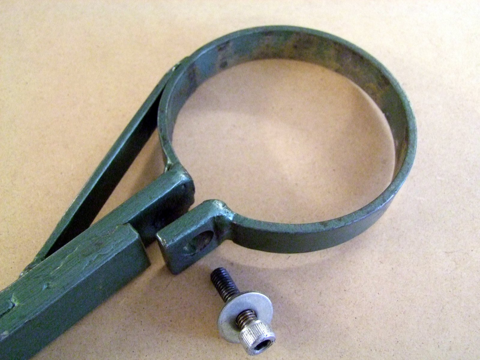

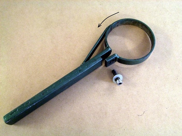

Re: Back spheres stuck on a 1997 Citroen Xantia Estate 1.9 Turbo Diesel
One more variation on removal tool design...
The rigid (non-bendy) handle is about 30cm long.
Complete tool can be made quickly, if some welding equipment is available.
Circular ring easily formed by using an old sphere, the steel strip, and a vise.
The small side-strut linking ring to handle is essential.

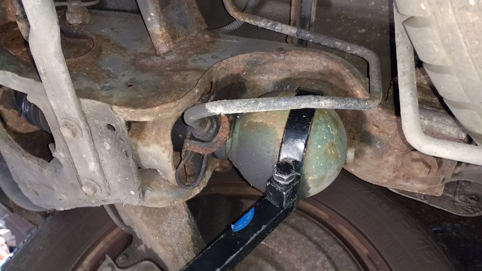

This is another variation on the removal tool, it's a genuine Pleiades one which has an angled head. Once clamped onto the sphere and with the engine idling, suspension on high as already noted, a couple of blows with a 4lb lump hammer should be sufficient to start it moving.
Ted
