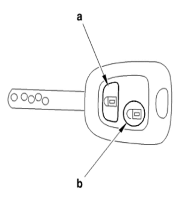

You did the correct procedure Mike (official routine below).
  • Put the HF key to be synchronised in position "ignition +"
  • Within the next 10 seconds, press one of the HF key buttons
  • Release the HF key button
The type of key issued for that year was this:
So if you have another type of fob it probably won't work as it will be the wrong version for the remote functions.

GiveMeABreak wrote: 04 Sep 2018, 16:13 You did the correct procedure Mike (official routine below).
Yup, that's the same design of both synched and non-synched remote Marc. PCB's are identical too. Even the audible signal I hear through the 433.nnn frequencies sounds identical.
