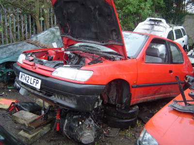

I'd also far rather replace the lump complete than do the Head complete, you can buy a secondhand engine for less than the cost of a set of Head Bolts and a Gasket Set, too.
But seeing as you fancy having a go, why not give the Head a try initially and if it that stalls, have a go at having the lump out complete.
Last two engines I did (ZX and 306) without a Hoist, just raise the body, tilt the lump onto its back and drag it out.
Loosen the Hub Nuts first by the way, 35mm on my 405. Before you jack it or remove the Road Wheels.
Have an A4 Pad, a Stash of numbered Sandwich bags, Digital Camera or phone and a Roll of Masking or similar tape to keep track of everything. Keep notes and re-assemble in reverse order.
Also: do have a think about getting yourself a spares vehicle for £50 or so, something that you can see running; and have a go at having the engine out. If it goes well, maybe you'll not have to wave a sad goodbye to the Synergie.
Plenty of advice freely available here if you're stuck.
Could be a lot of fun and a huge confidence boost! Sounds like you've nothing to lose.
