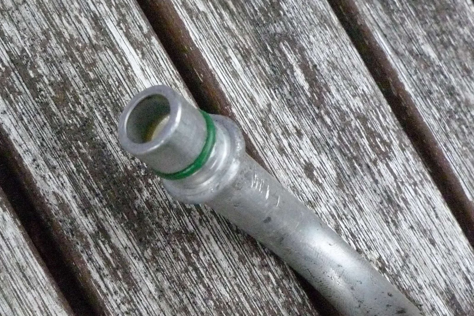

To clarify my ramblings above - here's what a leaking low pressure pipe looks like. I'd tried numerous new 'O' ring seals of varying sizes and materials and none of them cured the leak.

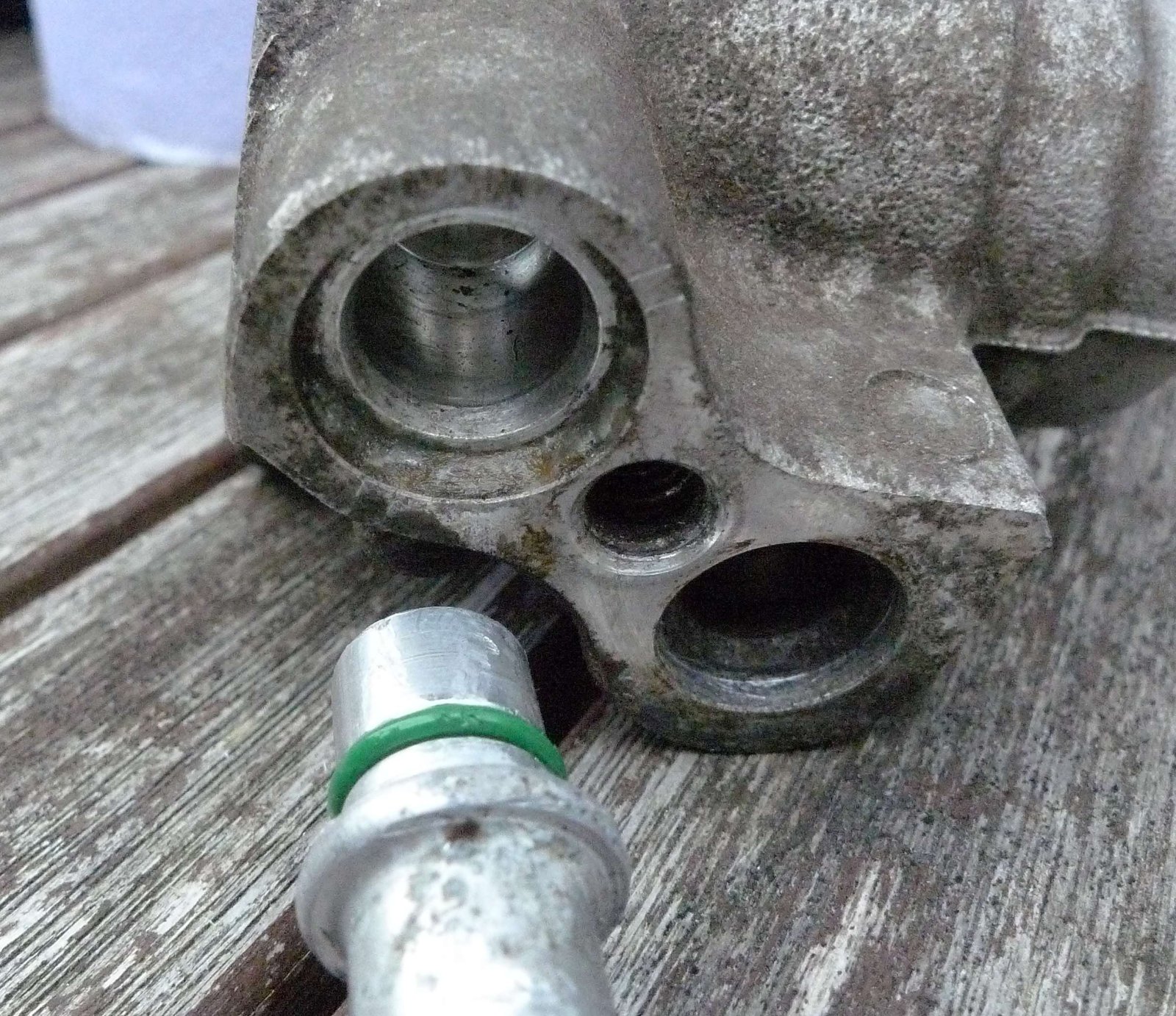

And here's where it goes and what it seals against. This is an old pinion shaft housing - the pinion shaft had rusted (like they all do), but the pipes still sealed OK right up until the rack was removed.

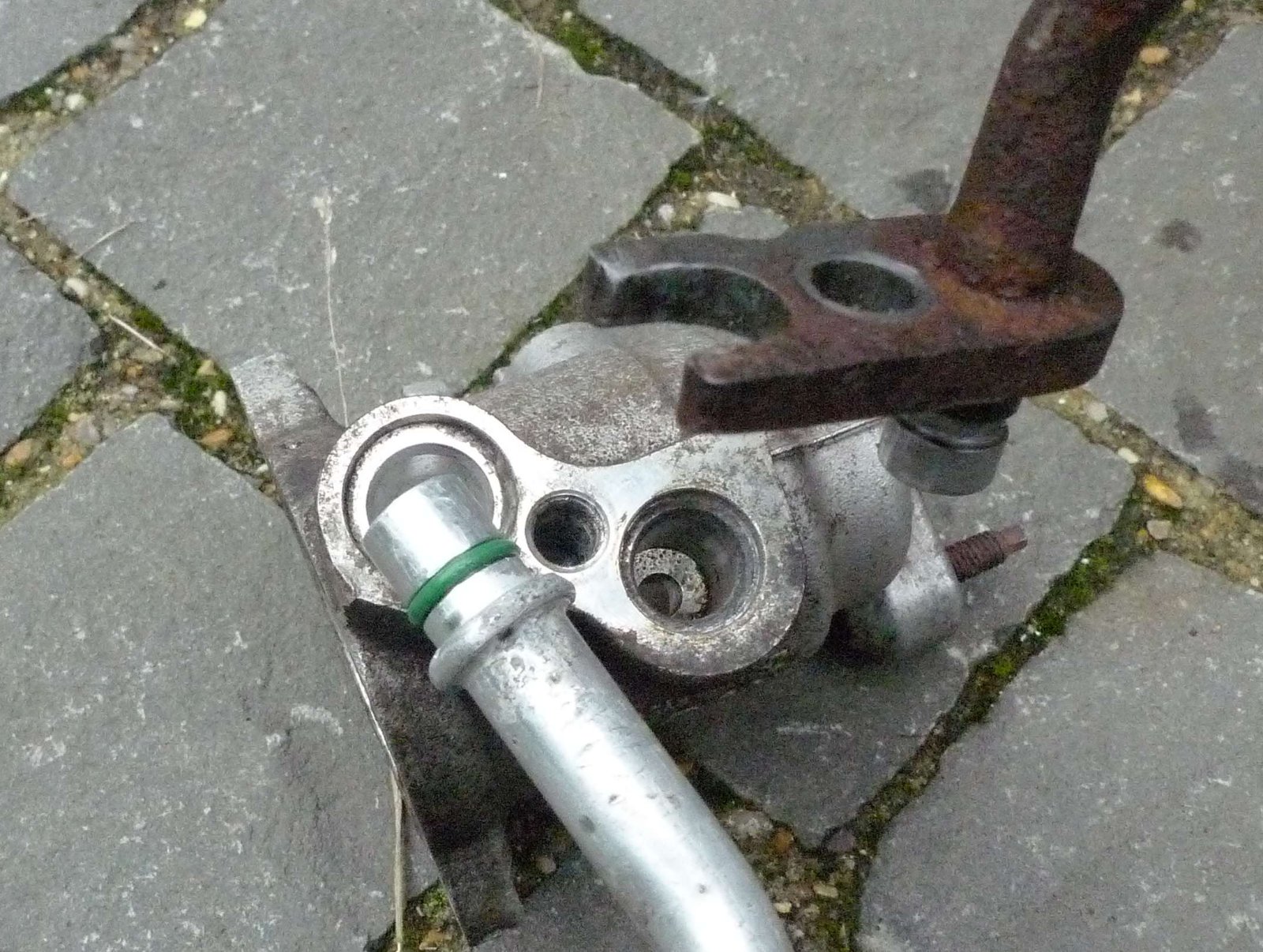

And here's what holds it all in place. The 'U' shaped clamp on the HP steel pipe holds the LP pipe down into it's pipe socket and the ridge pressed onto the LP pipe should just about be proud of the pinion housing to allow a firm and tight fit. If the ridge on the LP pipe gets worn then there'll be a little movement with the LP pipe in its socket allowing it to leak. I did wonder if a ~1mm thick nitrile / HNBR seal in between the pipe ridge and its seat in the pinion housing would cure the leaks.

The green 'O' ring in the photo is already a little oversize, but it still leaked a little. The replacement pipe is holding up well at the moment so I'm hoping the problem is cured........ until the next steering component fails

Re: C5 X7 Steering pipe replacement
hi Bobbin, From your pic it is very likely there is minor corrosion and pitting on the mating surface of the O rings. Make sure the O ring mating and seat surface are smooth without any scratched marks or pitting . Any minor imperfections will results in leaks. The O ring cannot be too oversize as it will distorts and leaks. If you not sure what is the right size check with hydraulic O ring seller for advice. Hopes this helps. This kind of joints sealing is very simple and reliable .
