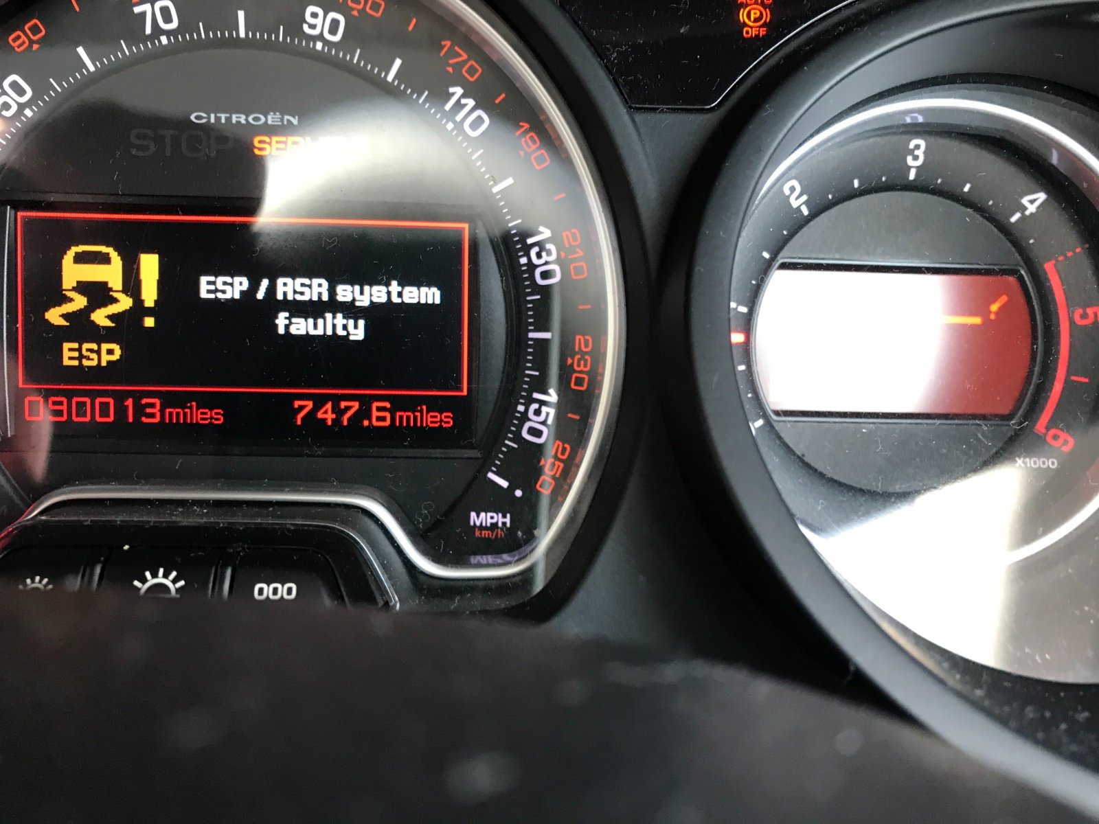

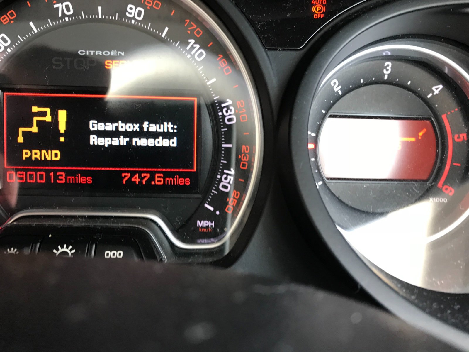

Ran out of diesel night previous. Oil top up showing.
Next morning car stuck in D3. Indicating parking breaks faulty, the gearbox and the ESP faulty.
Even in manual I can’t change gear.
I assume running it of fuel caused these.
Any suggestions,

Thank you very much Marc,
It’s a C5 exclusive HDI AUTO
Cylinder 2179CC
Reg *******
The photo order is the chronological order of faults. Apologies for being upside down.

Ok, so you have the DW12C 2.2 HDi Engine with FAP and AM6 box (2013).
From what I can tell and you will need to get it diagnosed; the AM6 Auto gearbox has gone into 'Refuge' or 'Limp' mode because of a problem detected by the ECU. This is a backup mode and shows the 'D3' indicator to confirm. It is a protection measure when there is an issue with the gearbox and limits the operation of the gearbox until rectified to protect itself. The fault normally clears when the car is restarted as far as I can tell.
The ESP / ASR fault and the parking brake fault can be related as the ESP ECU controls the electronic parking brake ECU. So if the ESP ECU is detecting a fault from the Gearbox ECU (as they communicate with each other) then this could be why it is throwing up associated errors.

What you need now is to get it read with Diagbox (Citroen's diagnostic tool) to find out the actual fault codes. Because this 'backup' mode can relate to several issues, we need to look at the fault codes to get an idea of the problem.
