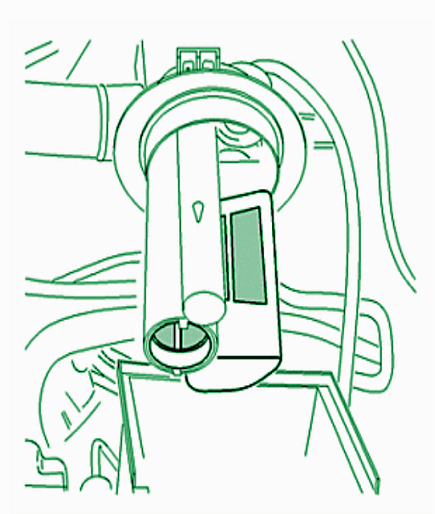

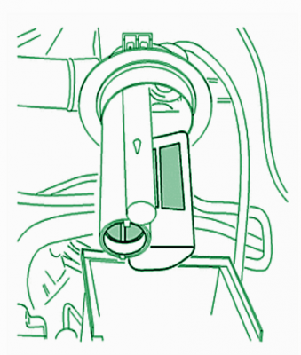

Ok, so here is the Filter component - incorporated into the LHM tank. There are documented cases where cleaning the system out especially the filters has cured rear sinking issues with electrovalves, so if you have eliminated other possibilities I strongly suggest you clean the filters out - there are surprisingly, a lot of Citroen 'specialists' that still don't know about the filters and the impact this can have on the system when blocked. Blocked filters can put a lot of strain on the system as the oil is trying to get back and forth and if you haven't done this in your ownership of the car, then you can't also guarantee that it has been done previously.
There's a guide on cleaning this out here, with photos, by Andrew:

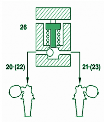

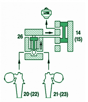

As for the roll control and firmness, here's how the valves work:
In the "firm" mode, valve ( 26) enables the vehicle roll to be avoided.
It prevents the transfer of the LHM fluid between the 2 suspension units.
When the vehicle is rolling, the fluid tends to pass from a suspension unit to the other; this causes the ball to move and block the passage; the suspension units are no longer interconnected.
Height Correction
In the "firm" state, valve ( 26) enables the height of the vehicle to be corrected. It allows the transfer of the LHM fluid from the height corrector to the suspension units.

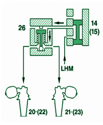

"Fluid Admitted" Correction
The height corrector is in the "fluid admitted" position.
The supply pressure from the height corrector pushes the ball to the bottom of the valve.
The suspension units are supplied by the corrector.

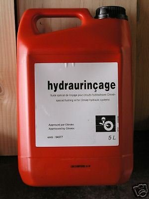

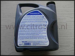

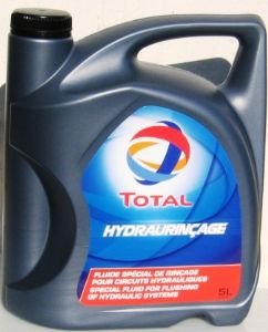

Couple of pictures here of what it looks like, which might help convince your Citroen dealer:
EDIT: Citroen part number is 11350 01 Hydraulic suspension/steering fluid (cleaning), 5-litre
Price can be similar to LHM Plus, or up to twice the price. Good news is that you'll only need 5L.
In some places, it has been packaged in plain orange containers. This may have been temporary bulk packaging from a while back.
