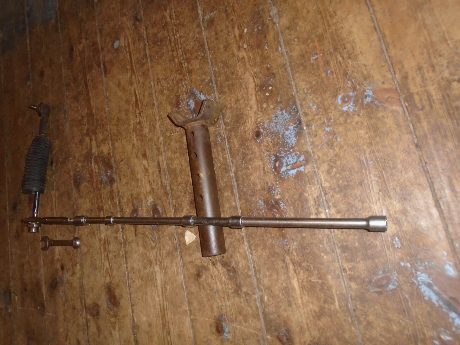

Yet another case of solving a problem with less than adequate tools with a bit of creative thinkingInstructions for operation.
Attach Molegrips
Wedge 19mm spanner engine block/clutch housing area to prevent any tendency of the rack to turn.
Position 17mm socket on knurled screw of mole grips
Assemble a long lever from assorted extension bars fron the socket set
Wedge axel stand tube against bulkhead
Lever the bar against the axel stand truning the mole grips to undo the stubborn nut.

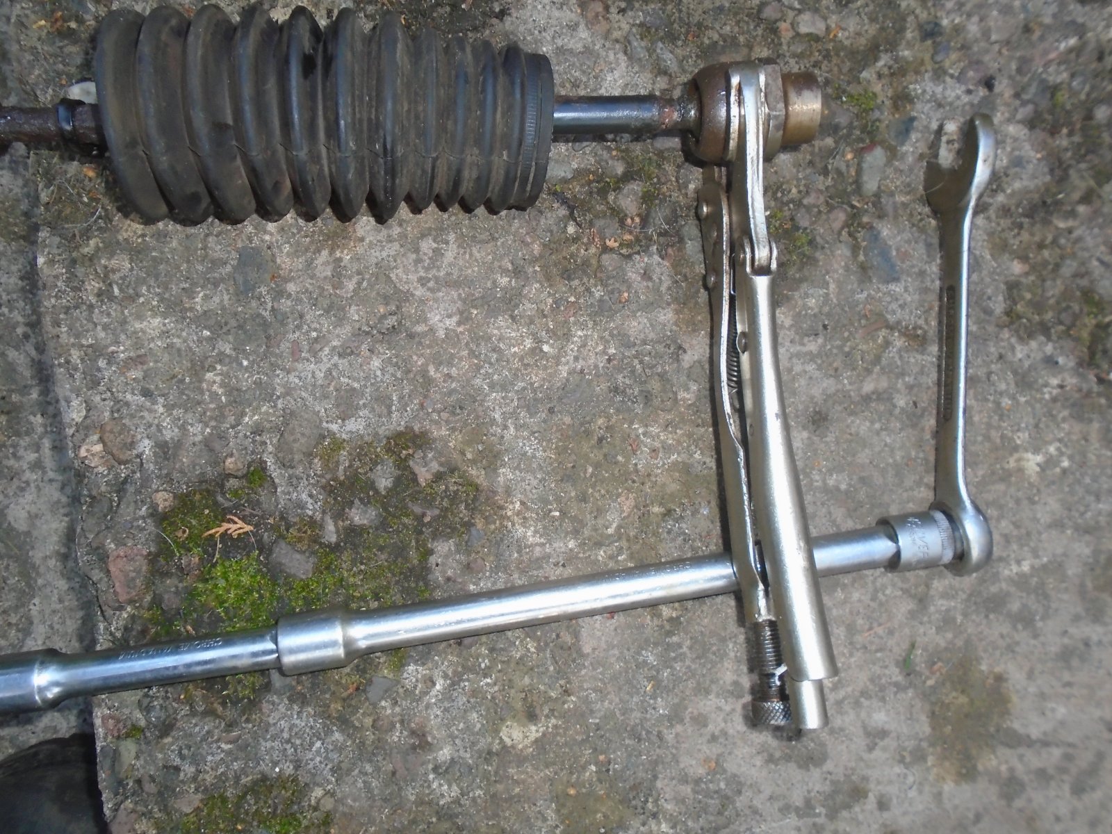

Re: Toolbag Tales-Homemade and improvised tools
That was the passenger side, the drivers side has of course a different geography of getting in the way bits and pieces of engine/bodywork. So different problems to be solved, but an adaption of the leverage principal came up trumps.
Regards Neil1/2 inch socket on end of long rod engages with ring of 19mm Spanner (open end fits in notch on rack)
Mole grips on bulbous bit of track rod, Lever exerts downward force on spanner and upward force on mole grips....Hey Presto! track rod undone!

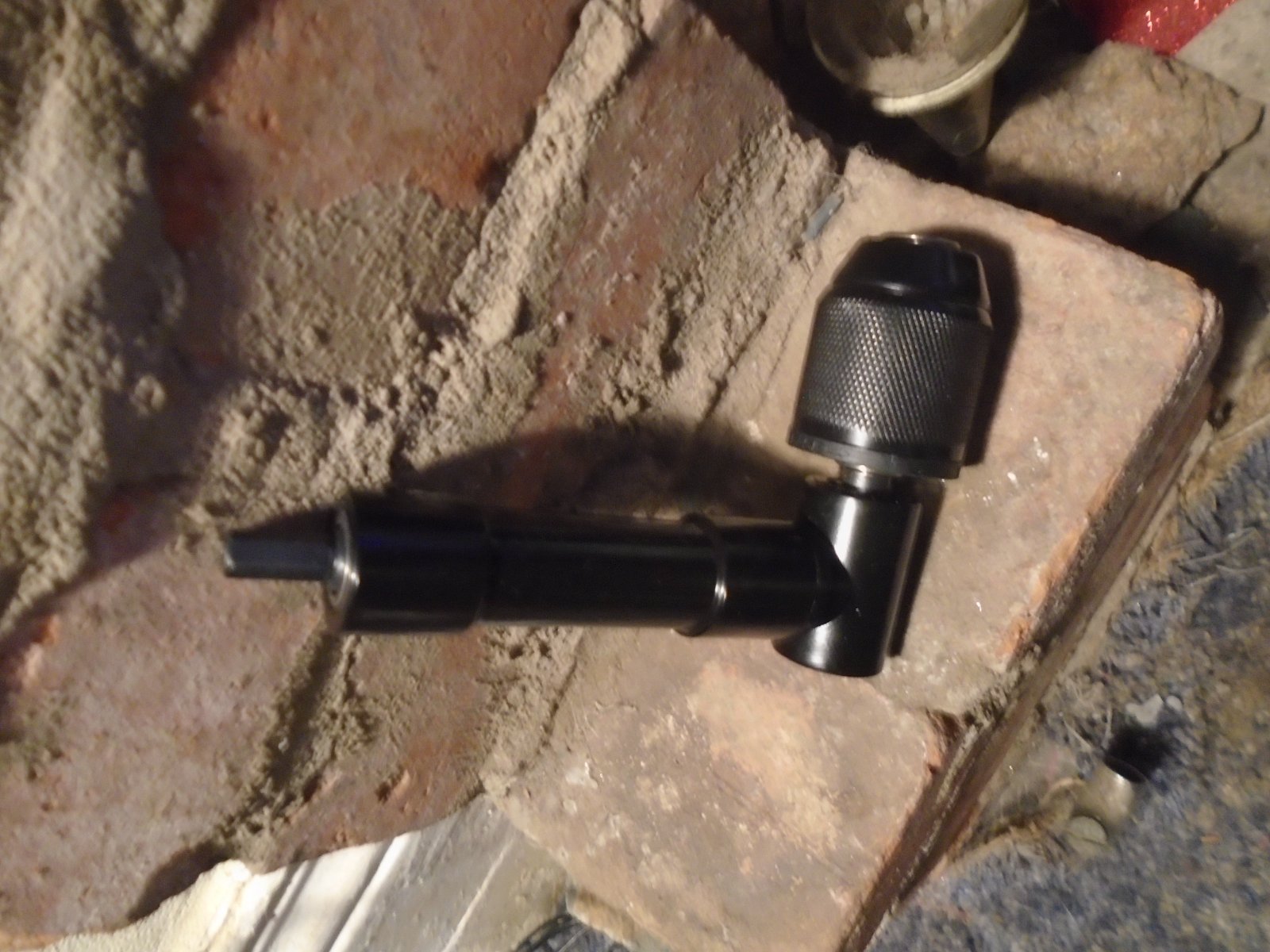

Just about as far off topic as you can get...neither homemade or improvised....brand spanking new
I feel a bit of cable re-routing is on the cards after lifting our floorboards and seeing what electrical installers did 40 odd years ago so this will come in handy.
Erbauer Angled Keyless Chuck 10mm, just over £20 of the Christmas pocket money tin!

NewcastleFalcon wrote: ↑28 Dec 2018, 18:02 Just about as far off topic as you can get...neither homemade or improvised....brand spanking new
I've burned out two of those Neil. the bevel gears for the right angle seem to be made of muck alloy. Mind you I was doing some tough drilling at the time.

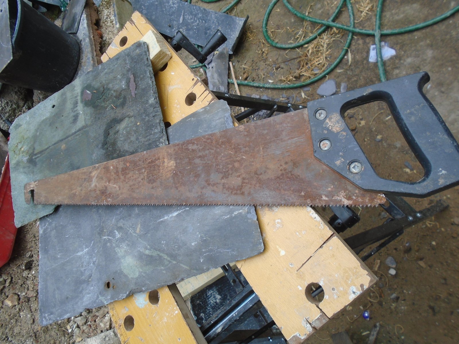

So what do you need when replacing a few broken slates.....
So I made one myself in a bit of inspirational creativity, and it works.
Well its a 40+ mile round trip to the nearest "Slate Ripper" supplier. Screwfix and Toolstation within touching distance of each other.............One has slate rippers for £28.99 quid, one for £8.49 (same make at both).Number 1.....A suitable youtube video ✔
Number 2....A Slate Ripper. X
REgards NeilTake one rusty blunt old handsaw. Hacksaw a couple of cuts to the hanging-up hole to fashion the "hook" and bobs your uncle. You can hit the handle end with a hammer to exert additional force if required.
