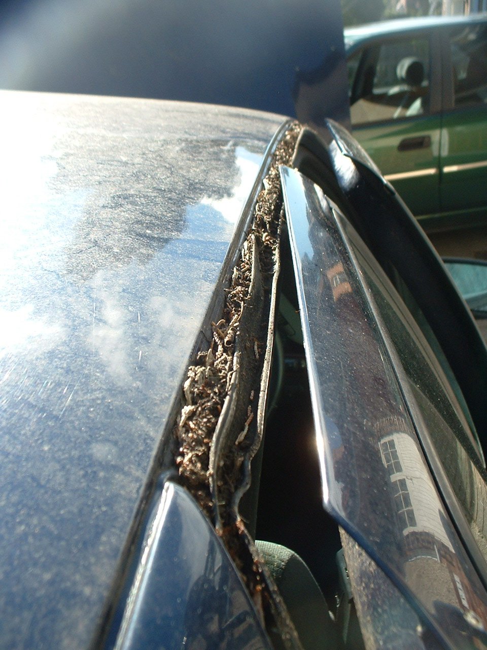

Gutters full
Skull's nearside gutter
Skull's offside gutter
Hard to see how they got THAT full

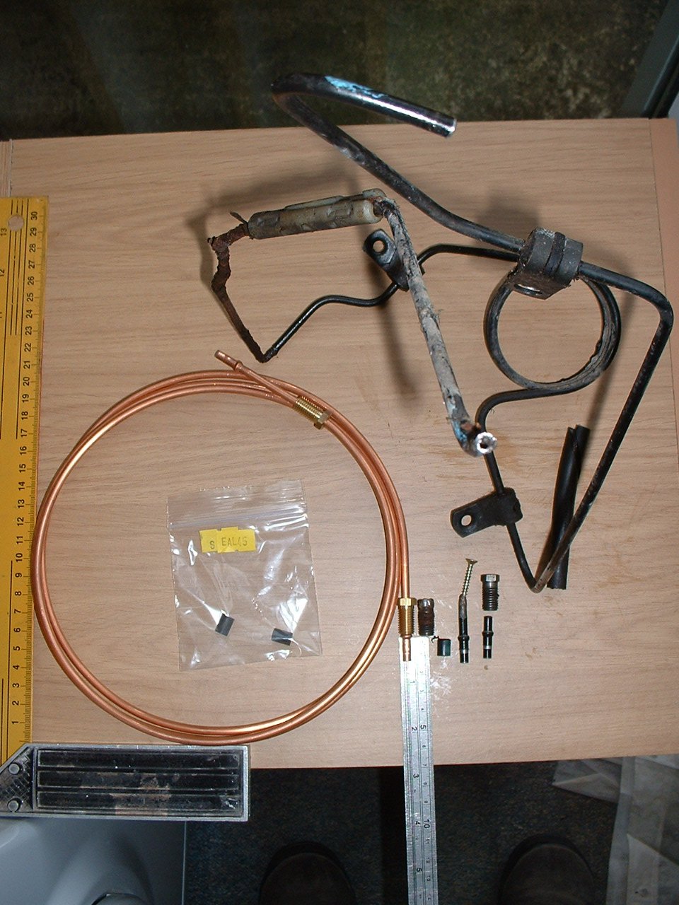

new pipe arrived and old one removed with a struggle .... currently struggling with new pipe going into safety valve (either access and orientation or thread on safety valve needs cleaning) ....
Old one off for comparison
removal was a challenge
access to safety valve
trying to refit .....head of new bolt is bigger 10mm
Gary
Skull
(Donor 2026)
Posts: 1382
Joined: 02 Aug 2013, 13:35
x 381
Re: My first Activa
Unread post by Skull »
Well it's not going to plan #-o
The safety valve end of the pipe is a torturous route to get it in place I have had to position it 5 times now trying different methods of inserting the pipe. I can't seem to get the union to bite properly ....a few times it has kidded me only to jump out.
I've done one of these pipes before and don't recall having trouble with the threads - the biggest problem is access (more so on the Activa due to additional pipework in the area)
I turned my attention to the regulator end of the pipe to satisfy myself that the union thread wasn't the problem. This seems to have needed an enormous amount of pressure on the back of the union for it to thread properly and although it looks as though it's a good fit I would be happier with another couple of full-turns going by the amount of thread remaining. There is no way I could apply the same pressure to the safety valve end so after another failed attempt I removed that end of the pipe and trimmed about 2mm off the end and chamfered the end profile. It seemed as though it was winding on with the most back pressure possible given the access angle but it still popped off ](*,)

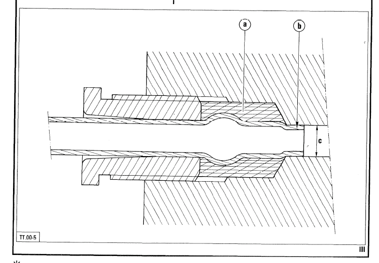

Also this diagram is similar to the one in my Haynes manual but I've yet to see the detailed taper at B on any pipes on the Xantia which would certainly allow the pipe to go on more and improve the stability of the whole connection :?:

I wonder if 'a' is a pipe seal?

Yes Hell Razor
a is the pipe seal :wink:

After considering stripping out from above for access it soon became apparent that it wouldn't help access to the safety valve area. I thought I'd have a further look underneath and thought that the safety valve was maybe attached to a bracket held by the torxs bolt you can see partially hidden behind an old tie-wrap in the photo above. That turned out to be a dead end as what I thought was a bracket was actually a small leg of the subframe :rofl2:
So I went back to the original plan and decided to trim the old seal as the new one had been shredded by the repeated extraction each time the pipe was removed I'd had to dig it out with the dental pick reinserted the pipe and had another few wiggles of the pipe into the safety valve and FINALLY a miracle happened [-o< The pipe slid in further than it ever had before and I've managed to get a few full turns =D> The spanner doesn't have much room to swing so it's been a slow job and not fully tightened up yet but I'm hopeful .....
In hindsight I presume that either the seal (a) was stopping the full insertion or the pipe trim and taper (b) allowing the pipe to insert fully (into c) has finally allowed the union to get a proper bite on the thread before the pressure from the Citroen flare has made it pop out of the thread on the safety valve ....

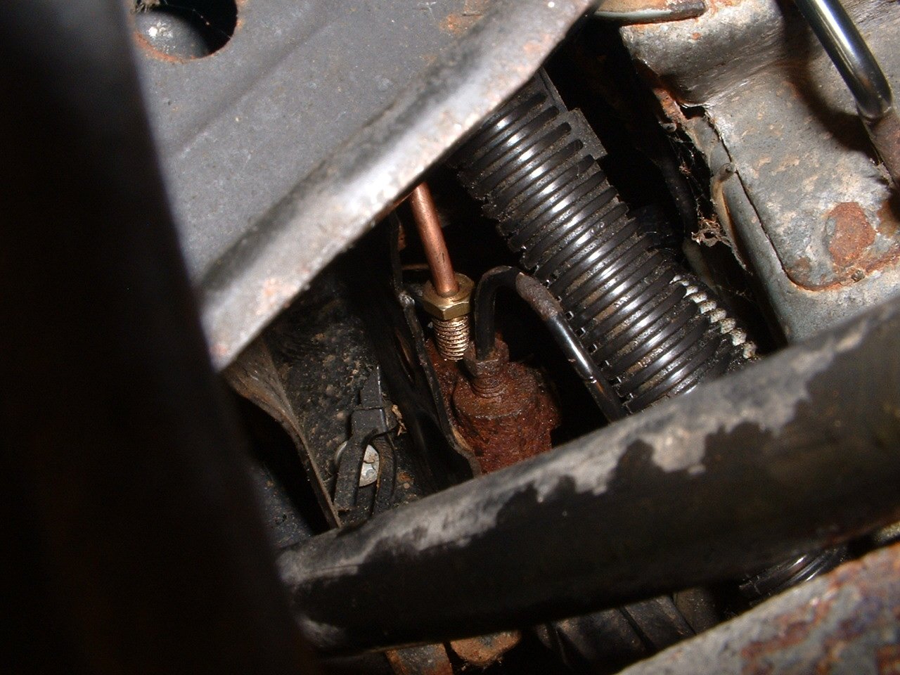

Pipe replaced and tightened :-D
Now to clean up that corner strip brakes down and check/lube
Photos of alternative access (final tightening without a cranked pipe spanner - christmas list)
safety valve from below left front subframe
access from engine bay 4th gear selected
spot the spanner
spot the spanner
new pipe
new pipe
spaghetti junction
spaghetti junction

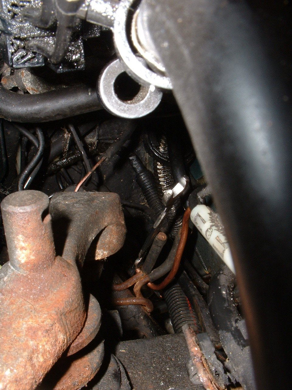

Played around with the fuel pump as I was suspicious of it operating as I couldn't hear it priming like my HDi does, but wasn't sure if it would make as much noise :?:
I initially tried fuse 9 (10 amp) in the engine bay but that seemed fine I wasn't sure which relay was for the fuel pump so moved onto the fuel pump itself I tried running it directly off the old car battery Pins 2 (white) and 4 (green) but still couldn't hear or feel anything ... Delved deeper and ended up breaking the sealing ring on the fuel tank #-o but on removal it seemed as though the pump was only just in one piece and was tricky to maneuver out, stuck it in a bucket and tried the battery wires again directly to the pump motor .... almost condemned it but then it purred into life :-D so pulled the terminals off and cleaned up the connection, reassembled pump and popped it back loosely in the tank, turned the key and still couldn't hear or feel anything then thought bugger it just give it a go starting .... fired up first time :-D
She runs elation quickly turned to :evil: as I checked around for further leaks ....
Skull wrote: 27 Sep 2018, 22:55

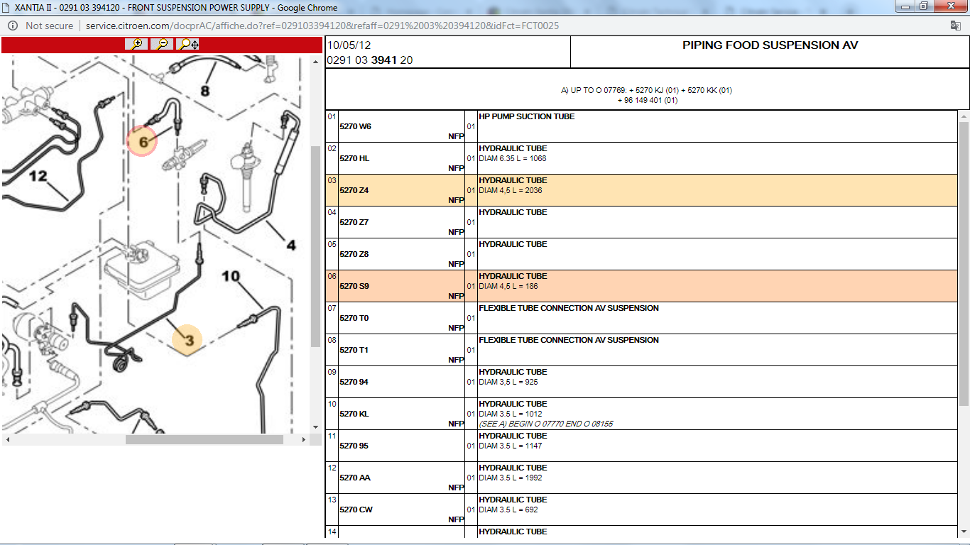

pipe 6 safety valve to 'K' junction (possibly damaged in removal of pipe 3) (Citroen 5270 S9 NFP 4.5mm 186mm) (ring Automec Monday)
Pipe 6 damaged as feared
Looks like I had nicked it with the hacksaw after all as a fine mist developed into a green lake but it looks like the pipe I repaired is good so I guess I'll have to get another pipe made up by Automec if possible .....
All in all though a positive day with some progress made :wink:
