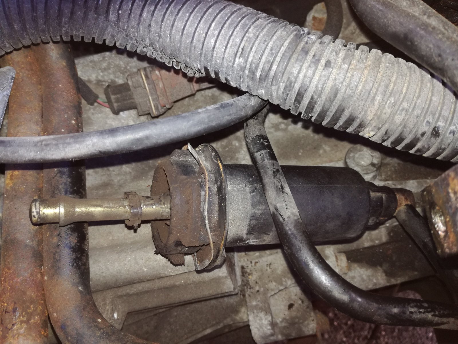

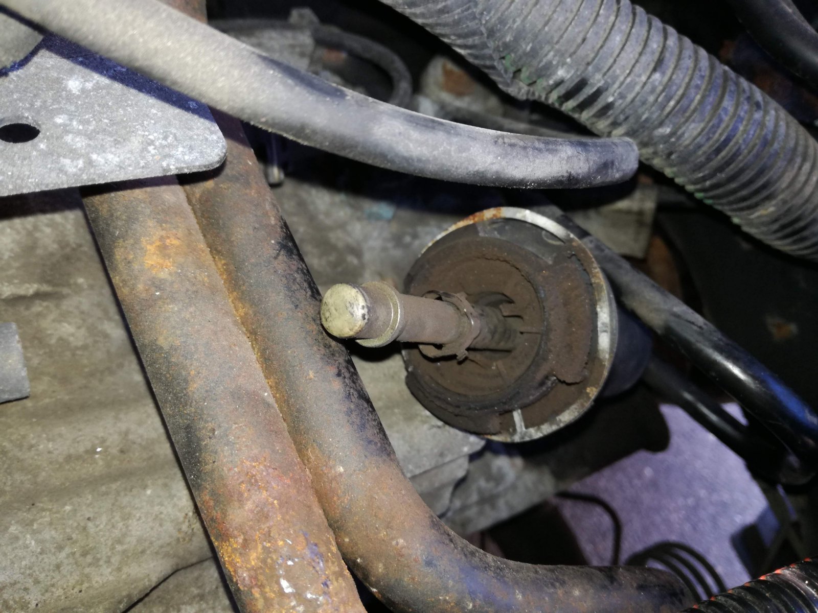

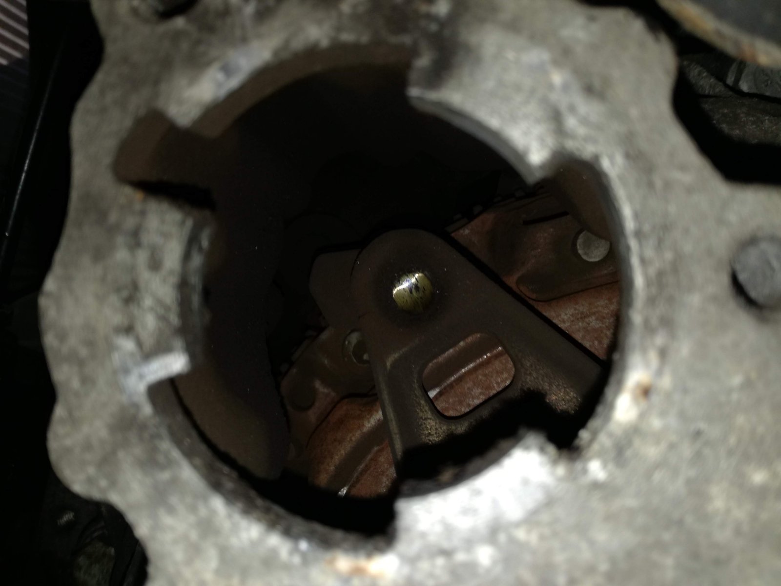

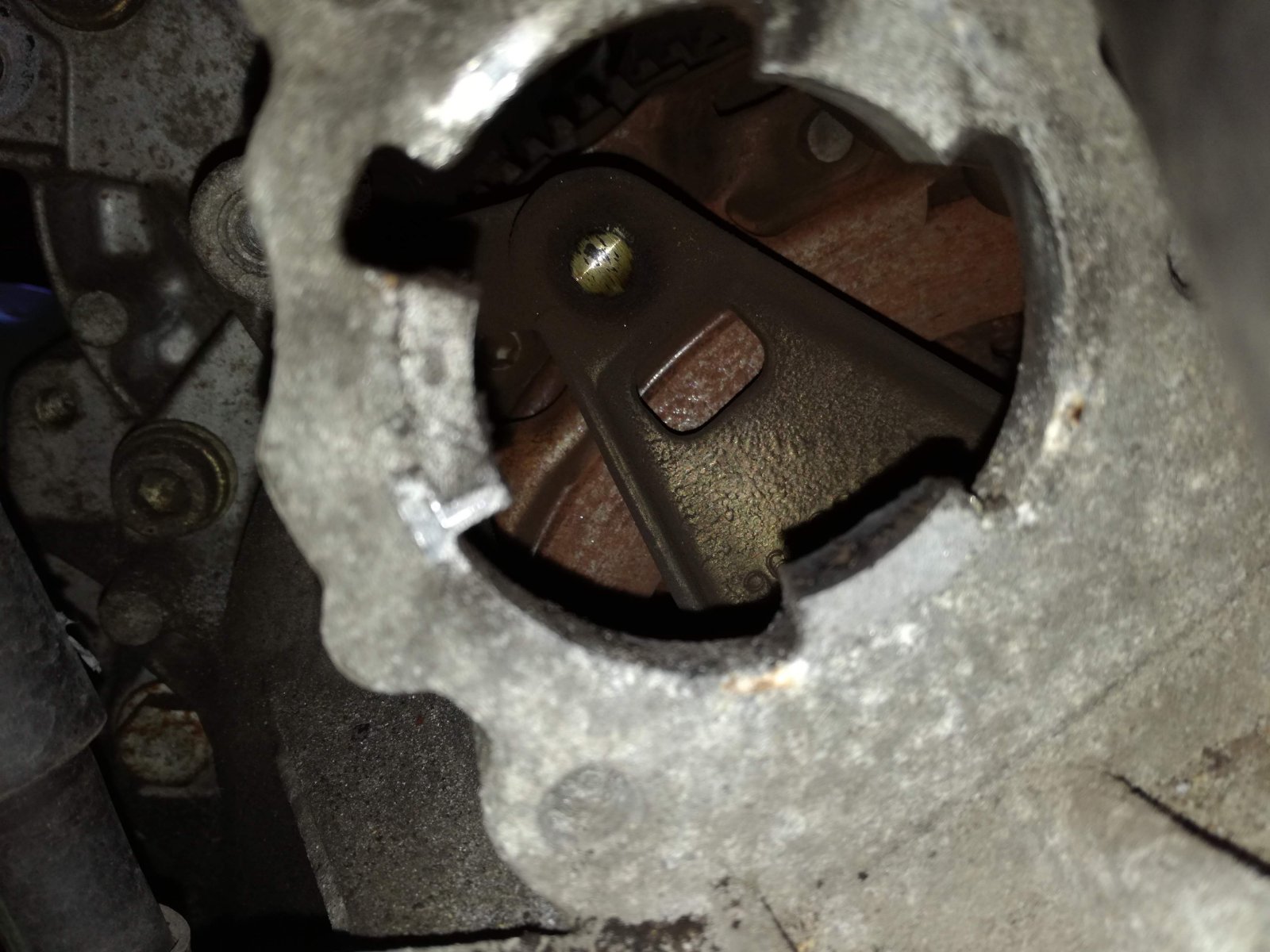

I've had a look at the slave cylinder and removed it from the bell housing today. It came out in one piece with the pushrod still attached. There is no visible signs of fluid leaking through the end of the cylinder. I am able to push the rod back in slowly with quite some exertion needed but have left it to slowly push out again. Clutch pedal has been wedged so it can't be pushed down. Should I push the rod back in and tie it or will it be ok left as is?
I have taken some pictures - do you think the fact there is no fluid loss will mean it maybe won't need bleeding or will air have got in anyway?

It looks like you have been lucky. The slave cylinder is probably OK, and may not even need bleeding.
The piston should be kept pushed in. When new replacements were supplied, they came with a plastic shipping cover that restrained the plunger, and I think the service instructions say that it should be refitted if the slave cylinder is ever removed from the bell housing. I suppose you can use some welding wire or similar to wire the plunger to keep it in place while the clutch is worked on.

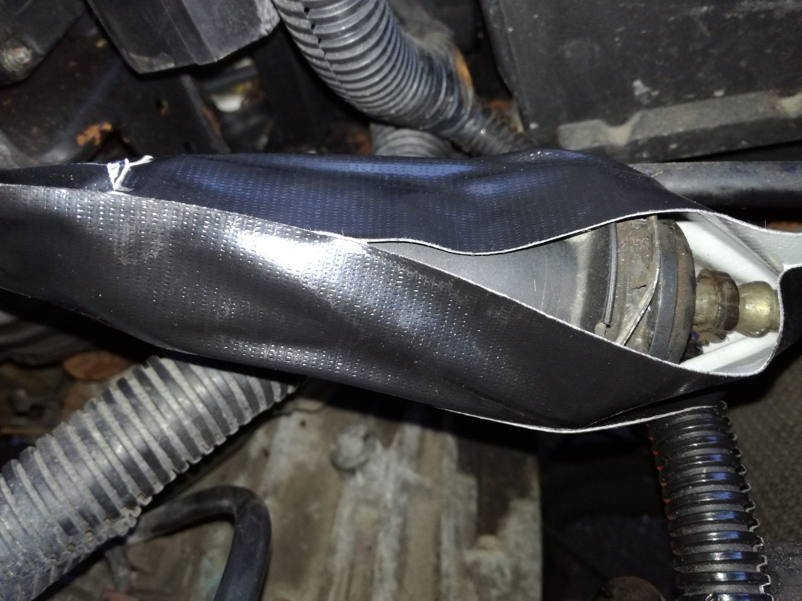

xantia_v6 wrote: 24 Sep 2018, 16:37 It looks like you have been lucky. The slave cylinder is probably OK, and may not even need bleeding.
Yes let's hope I've been lucky.
I've pushed the rod back in and used Gorilla tape to hold it in place. It should work, it's amazing stuff!
