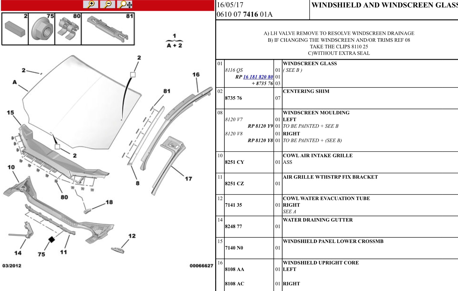

Hi all, my left hand n/s trim flew off on the M4 the other day. Where can I order a new Red one please, any ideas?
- x 6947
Re: 2009 C5 Windscreen trim
We'll need your VIN to get the correct part number and price for your car, but will only be a breaker or a dealer. The trim will also need clips to attach and are available separately.
Ok, so the part number for the woindscreen moulding is below. Can you confirm this is the correct part from the diagram. Bear in mind that it is essential that new clips are used when refitting, the old ones wif not already snapped will do so. Also, these are supplied unpainted, so you would need to take it to a Body repair shop and get them to prime and paint it for you. I can tell you that priming any trim parts and painting and clear coating yourself is a pain in the rear, due to bubbling. It would be easier to get a pro to do it.
If you decide that it is too much of a faff, then you at least have the part number for the left hand trim, but you must at least get the trim clips. You’ll just have to search and try and find one with the same colour as yours.
Trim clips part number: 1622750180 @ 73p each inc. VAT.
Windscreen Trim (unpainted) part number: 8120Y9 @ £110.32 inc. VAT
Hi Marc,
Yes part No 8 Passenger side. Is it easy to replace /worth replacing the clips on the drivers side as well as this may also fly off, it seems loose as well? I have seen the clips on ebay. Packs of 10, looks like 5 on each side (yellow in colour).
How do I order the trim please?

- x 6947
I don't have anything on replacing the trims unfortunately - when I had my windscreen replaced a couple of years ago year I had the windscreen company do it - and I know he came armed with a stack of clips.
To order the trim, you just contact your Citroen Dealer - you have the part number in the diagram. It might be worth asking them how much to get it painted and fit it at the same time? Most of them usually have a local bodyshop they use for repairs anyway - so that might be the way to go.
Thanks for your help, daft question but left is viewed from outside or inside?
- x 6947
Left from inside
The same problem also for me. Driving the left windscreen lost from the area... c5 tourer 2009 black. Do ypu beleive that i can find and what price?
Windscreen moulding for Citroen C5 2009 grey-black... i think not the trims ... excuse me. Number 8 in the picture
