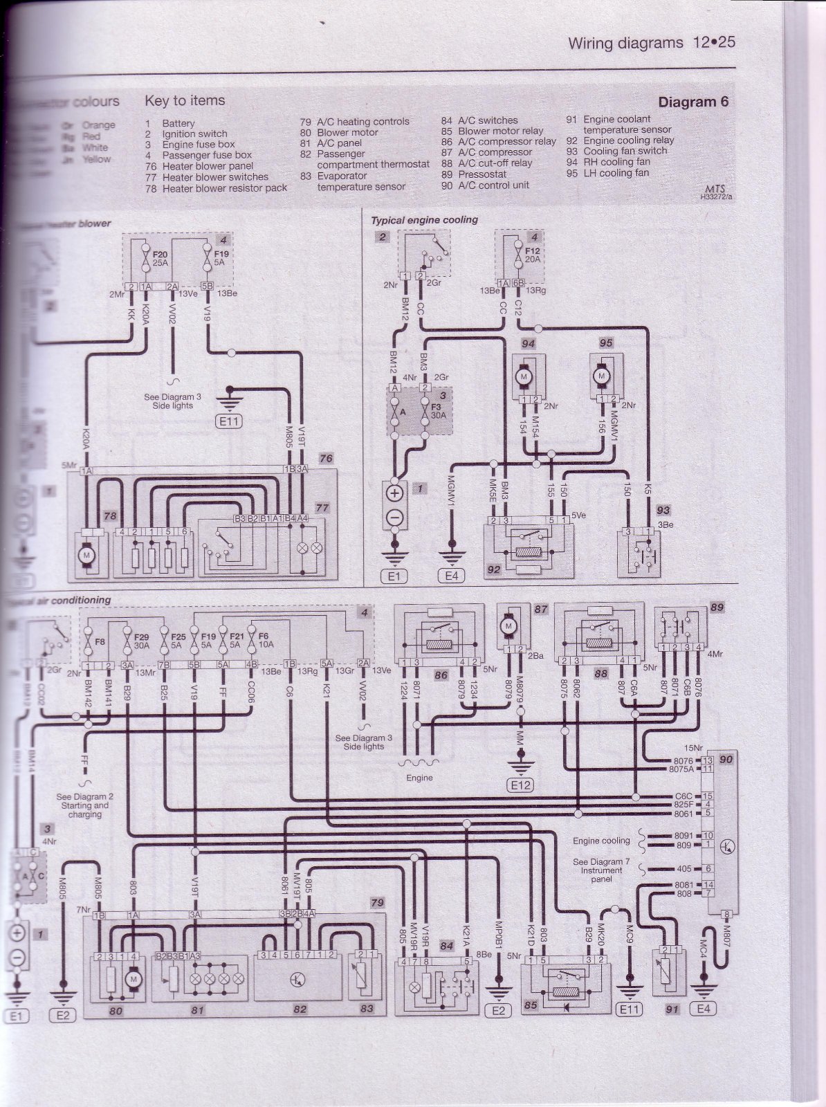

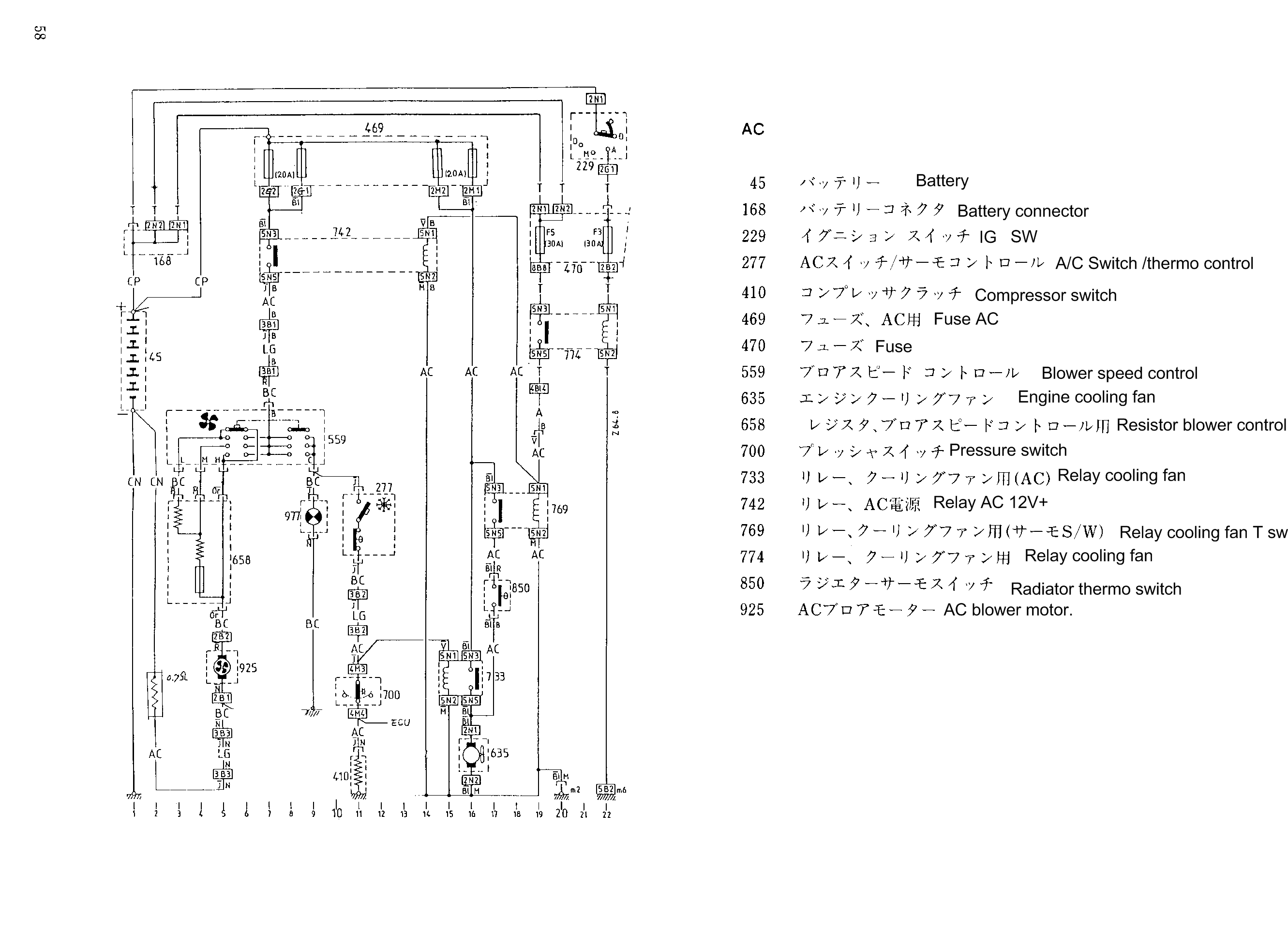

So I found a diagram out of a Haynes Berlingo book. Is this the same?
Posts: 11005
Joined: 09 Nov 2005, 22:03
x 1476
Re: AX fitting airco system
Unread post by xantia_v6 »
I can't really read those. I did however find a set of AX wiring diagrams here: http://on.no-ip.biz/car_catalog/ax5/index.html, including the wiring for the A/C system.
It looks like the AX does have an over temperature switch (item 855 on diagram IV), but it only triggers the warning light, it is not connected to the A/C system. So there is a precedent for keeping it simple.

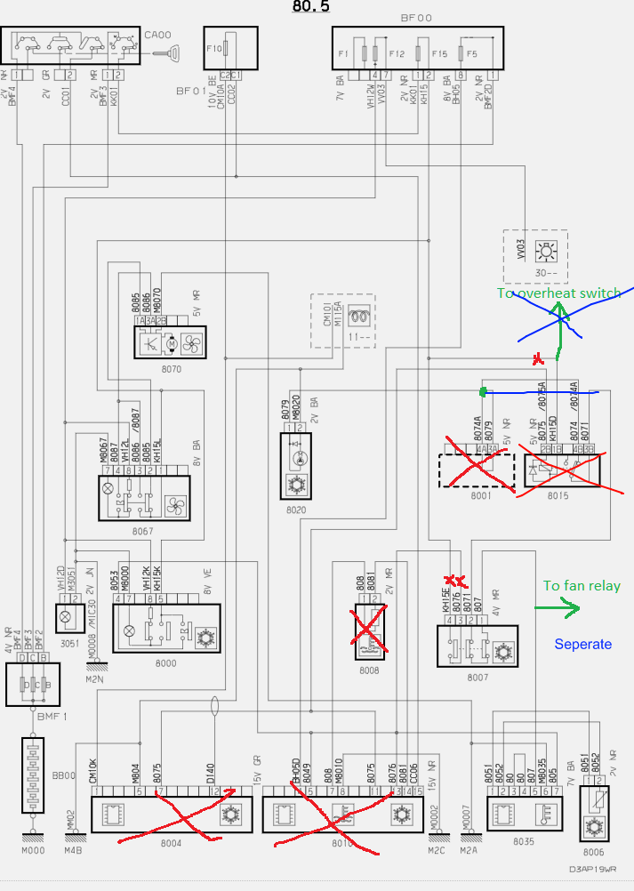

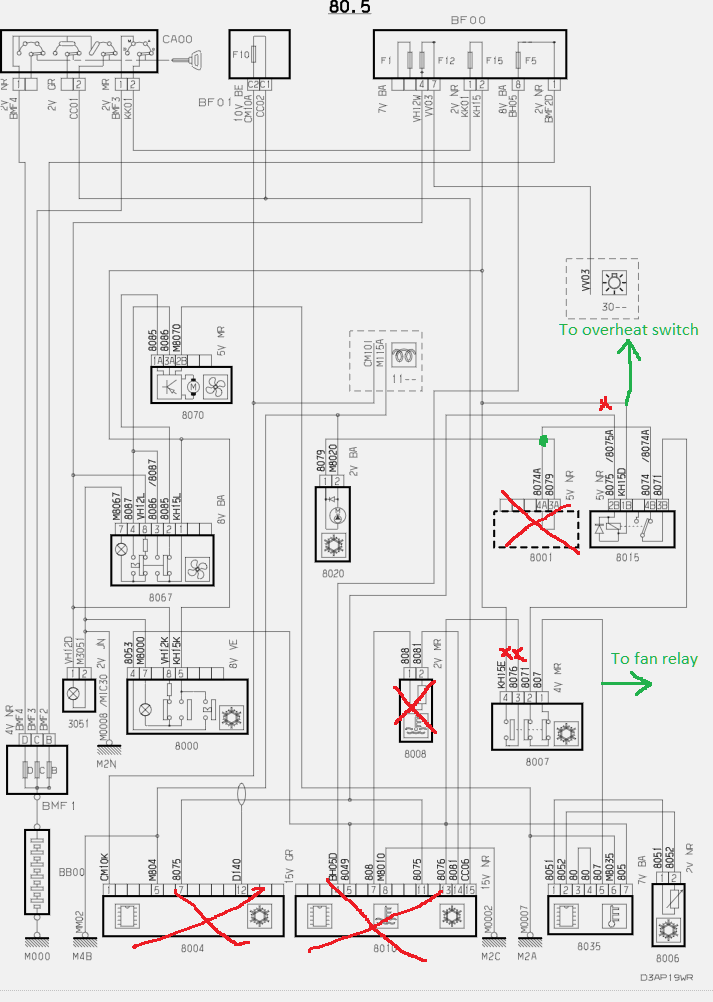

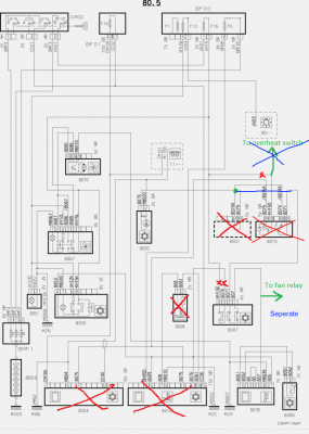

So far I made this:

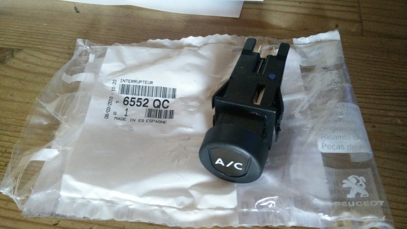

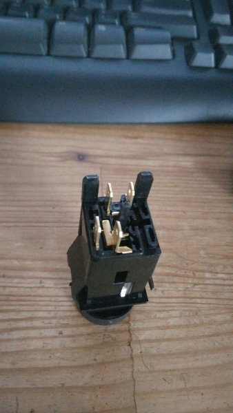

Ok I have the last part of the A/C just ago delivered. But, which pin is which? There are no numbers on the switch.
MikeT
Posts: 4808
Joined: 11 Jun 2007, 16:17
x 232
Unread post by MikeT »
Usually, such switches will have two pins for illumination so if you have a 12v power source you should be able to work out which pins are the switching pins.
Alternatively, a continuity test will do as well.

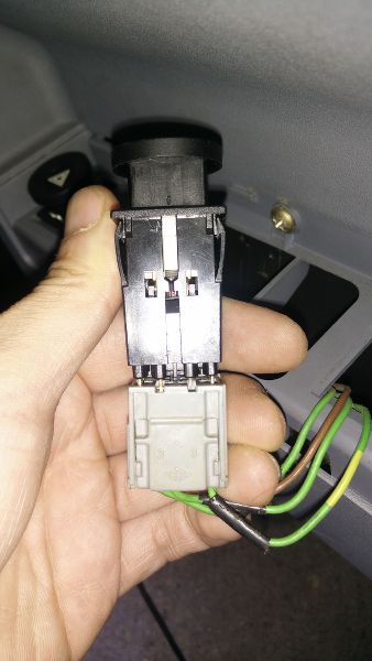

jsp
Posts: 330
Joined: 04 Dec 2014, 02:05
x 12
Unread post by jsp »
Thanks for the reply,
The pin which the black pen is now in doesn't work regardless on or off position
x 1746
Likely there will be
- Gnd
- Fascia/dash illumination +12 supply for the internal bulb/led
- a pair of contacts which 'make' when sw is pressed
Circuit diag will identify the sw and its connections.
As said, meter check will sort it.

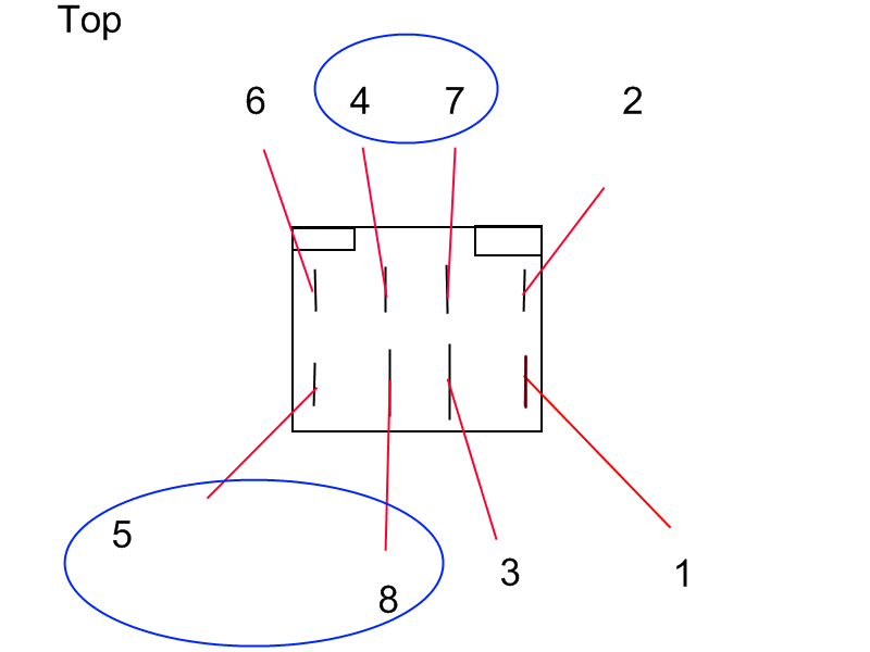

jsp
Posts: 330
x 12
I used my cars rear windscreen heater plug as reference:
Pinout
