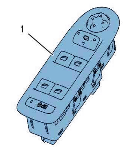

On the X7 the Driver's Electric Window Control Panel is the master ECU and handles requests for the passenger side - so I would check the control unit out in case water has got into the unit - some electrical contact cleaner will help.petef wrote: 17 Sep 2018, 17:38 Drivers side window works fine. Removed passengers switch and checked that out - all ok. So that leaves no power getting through , jammed mechanism or motor I think?

There is an existing problem with the drivers side control panel - won't work for rear windows. However both rear windows work fine on their door switches. Perhaps I could try 12v - from a slave battery - direct to the passenger door regulator?

It'll be the driver's control unit then I suspect - the child lock button on the panel usually prevents the rears from opening - assuming that is not depressed, it would again highlight that panel as suspect. You'll find that every time it rains, opening and closing the doors - the water always accumulates on that control unit - over time it seeps in and gently corrodes the contacts causing shorts. You can unclip it carefully and take it out for a clean up. Once out it can be carefully unclipped and cleaned out.
I had to do this on all my C5s at some point - but now my OCD just kicks in when i see a bit of rain on the panel - it's reach for the cloth time and into overdrive!

When I got my C5 Mk1 one window would not automatically close (it would close if I held the switch). A Lexia session told me the driver control switches were at fault. When I opened it up there was crud on some of the contacts (one contact was very dirty, and corresponded with the window at fault). I gave every contact a good clean, and the windows responded as they should. When Trainman had a similar issue on his C5 he also cleaned the switches in the driver module, and it resolved his problem.
