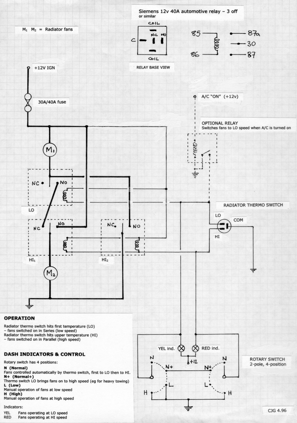

- x 1751
Re: AX fitting airco system
May or may not be of any use, but here is the basics of a twin-fan cooling installation, with relay added for triggering low-speed when AC is switched on.
Uses a standard radiator thermo-switch.
Dash LEDs and manual switching is an optional extra.
Circuit equates to the standard 3-relay arrangement on many Citroens.
