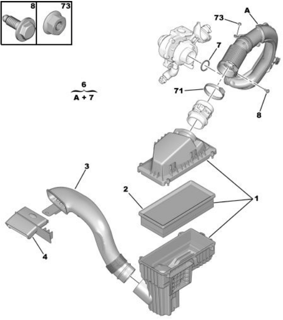

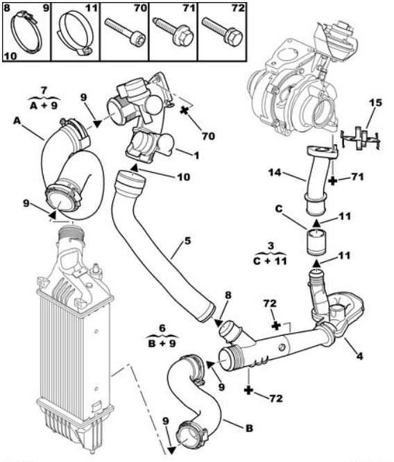

Dave, can you be more specific on the piping you are referring to? 'Vac' pipes doesn't really help - it you have a couple of photos - one close up and one taken further back so we can see the pipe you are referring to would help with identification.
In the interim, here is a diagram of the Turbo Air Piping in case this is what you are referring to..
| DW10BTED4 Turbo Piping | Air Filter Piping |

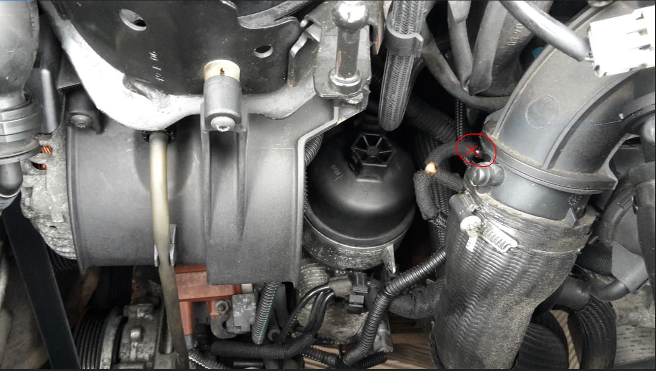

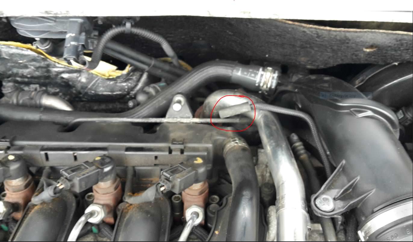

this pipe was tucked under the alloy pipe ( i'm thinking this is EGR > Inlet?) open ended but i couldn't see where it should go? attached somehow to the EGR valve?
the red cross on this one is another that was not connected, the plastic pipe has what looks like the remains of a T in it and the pipe i connected ( rightly or wrongly?) to it was longer than it is now, it broke whilst moving it and also had a rubber connector on it as the one in previous pic and went in the general direction of the one i've connected to.

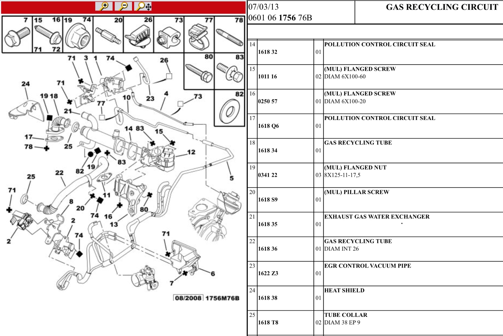

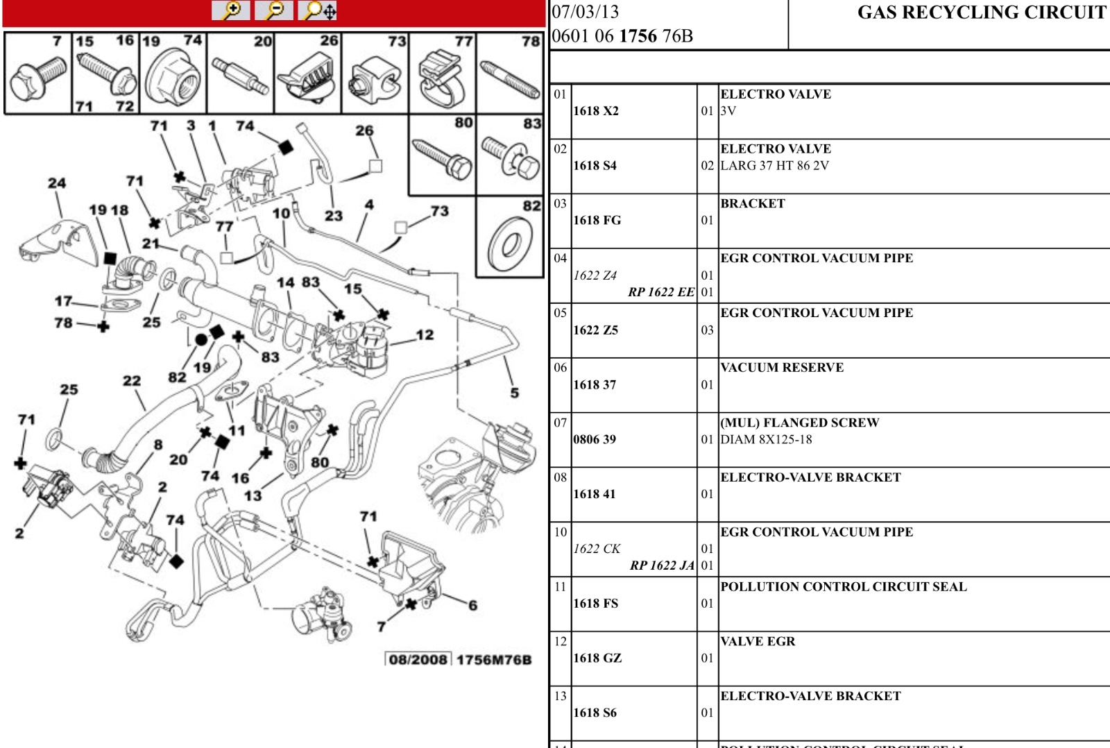

Right, that first pipe looks to be the EGR Control Vcauum Pipe (number 4 or 5 in the diagram). I’ve inserted the diagram twice, the second one with the additional parts in the table. The few that aren’t there are just clips.
(Click to Zoom)
If you look at the bottom, you’ll probably find the other pipes too!
Looks like somebody has disconnected it to try and prevent the EGR function......
(Click to Zoom)

cheers Marc
Mechanic thought the same as well, looks like a little tracing and cussing sometime soon!!!

the issue i have with the open ended pipes is that i don't know what they're supposed to attach to or if anything has been taken off?

Just had a look at mine. I've got a T piece in a similar area. One pipe, possibly the red X connects to a rubber pipe about 3" underneath the dosers, by a silver 'plastic' tube ( if that makes any sense) can't tell you what 'cause I can't see it, only feel it. The pipe that shoots off to the right goes into a fibre sleeve along with something else and turns up on the RHS of the oil filler and disappears towards the bulkhead, possibly EGR vacuum? The bottom one goes to one of the connections on the solenoid valves on top of the AC compressor. Again can't tell you which one without unplugging and blowing. The pipes all seem to be part of the vacuum system. It's a guess, but on the permanent vacuum side? The only reason I suggest side is that I've had the solenoid pipes off that feed the butterflies and one pipe only operated one butterfly. An actuator test will clarify. I think the 'green ringed' tube on each solenoid is the vacuum supply, the other actuates the butterflies.
Probably doesn't help much, but it might?
