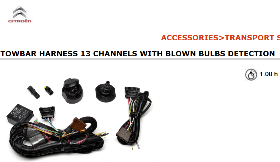

Here you go.
Features from Citroen's Sales Info:
Harness supplied with one 13-way socket and its fixings, plus fitting instructions.

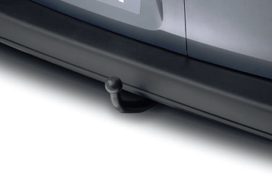

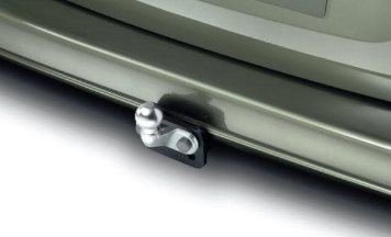

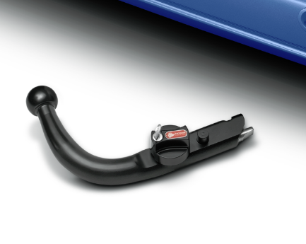

There are 3 types of towbar that they sell compatible with the above:
9627FE : Monobloc Ball Tow Hitch
9627CC : Swan’s Neck Towing Ball
9627Y9 : Tow Bar With Tow Ball That Can Be Removed Without Tools
Prices Below - Click to Zoom
| Part 942871, price £90 inc. VAT from Citroen |
- This harness takes account of the features of the vehicle, thus ensuring safety, reliability and simplicity of fitting.
- 13-channel towbar harness with blown bulbs detection, for connecting of ball tow hitches.
- Simple connection using the interface connectors identical to those for the vehicle.
- In addition, this loom has a unit to detect faulty flasher bulbs.

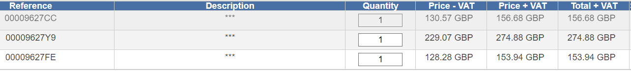

Here you go - all these had type approval increased from 1100Kg to 1150Kg. VAT inclusive dealer part numbers and prices below:
Remember these vans were available with either 600kg or 800kg payloads, so check you label for the max GTW.
| 9627FE: Monobloc Ball Tow Hitch (Max Trainer Weight 1150kg) £153.94 Inc. | 9627CC: Swan’s Neck Towing Ball (Max Trainer Weight 1150kg) £156.68 Inc. | 9627Y9: Tow Bar With Tow Ball That Can Be Removed Without Tools (Max Trainer Weight 1150kg) £274.88 Inc. |

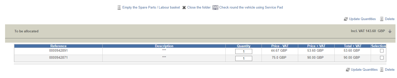

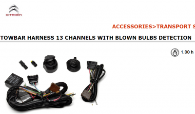

£53.60 here for the 942891 part. This one is 7/13 pin and does not have the blown bulb detection so is cheaper
£90.00 here for the 942871 part. This one has the Blown bulb detection.
I would suggest that you tell them you have checked the parts on Public Service Box and these are the prices. I can't believe they can justify double the price outside of the UK - they come from Europe anyway - something not right there.
Here is the evidence:
Click to Zoom
Click to Zoom

As for towbar choice - that will be down to preference and looks / convenience of removal etc.

My preference is removable swan neck despite the extra cost. They look so much neater although you do have to find somewhere to store the swan neck when it's not in use.
