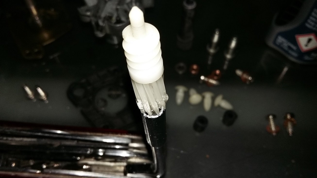

Buried deep inside the CX's speedo is this (one of two gears that turn the mileage barrels).
The teeth were worn on this part so I am rebuilding them with super glue built up in layers.
I will file them later to match the original profile.

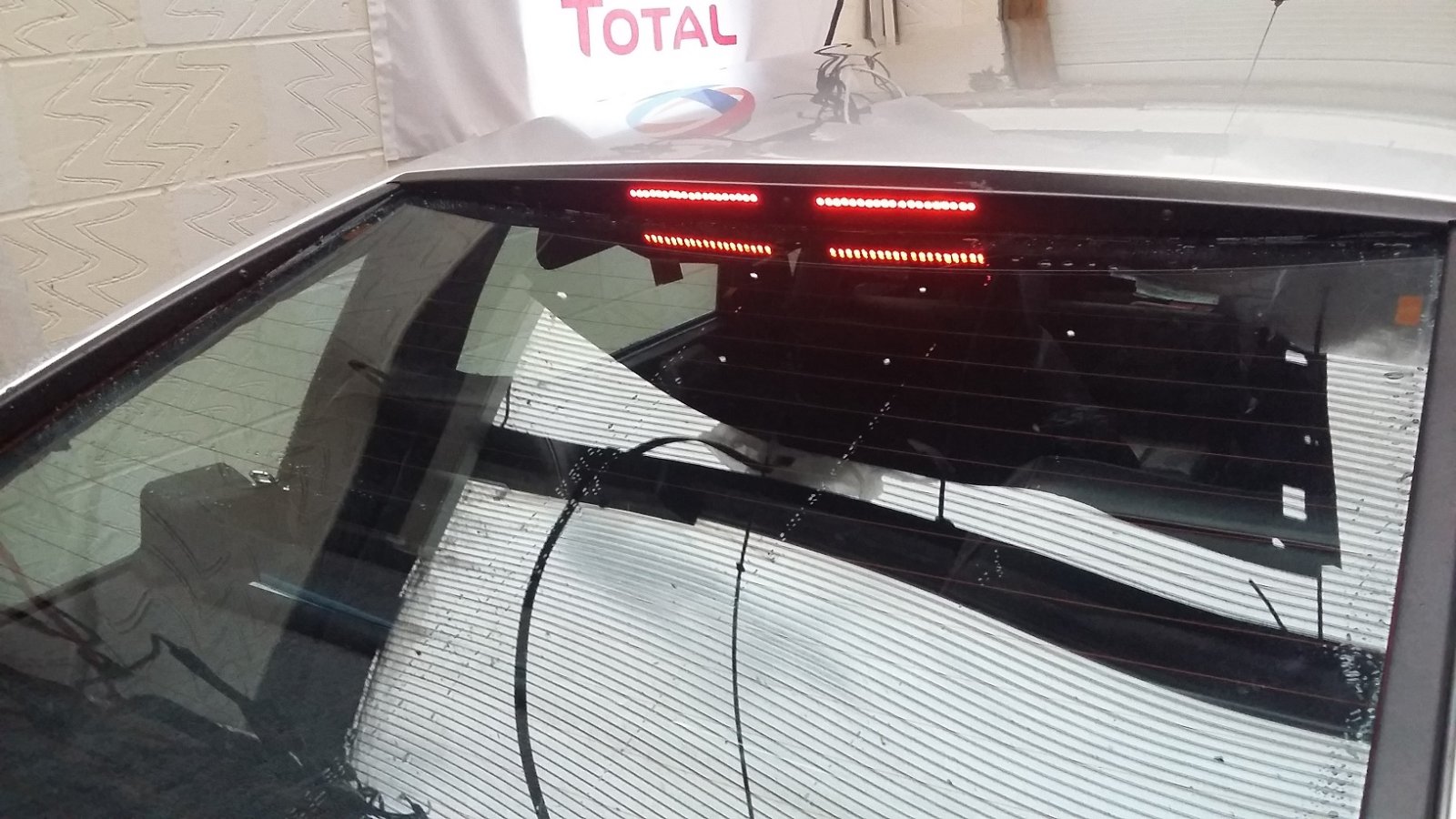

I drilled the rear trim, added a red filter sheet and fitted two led strips behind this running the wire under the rear screen pieces and into the boot via a drilled and grommeted hole.
The holes are filled with little rods of clear plastic glued in to them to form a seal and a "lens".
As the light "holes" are slightly recessed there is no light seen in the rear view mirror when they are on.

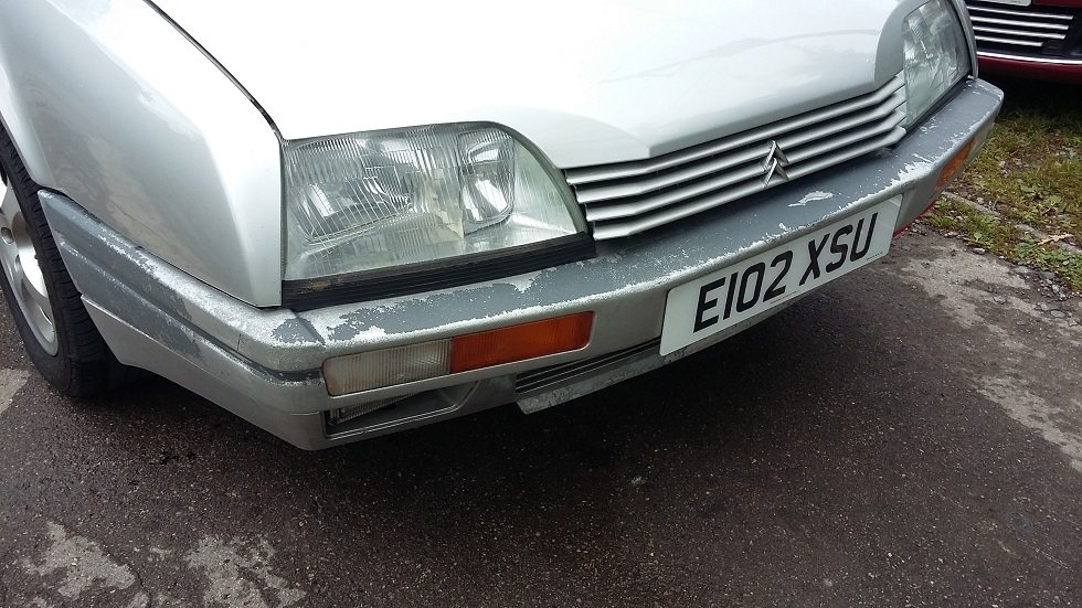

Trying to reveal the original bumpers, this after 2 1/2 hours !...so I will paint.

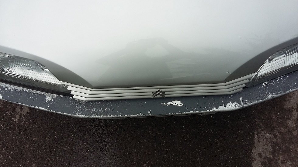

Front done as well

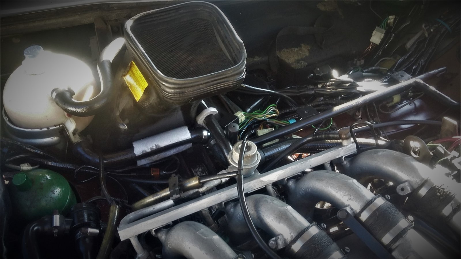

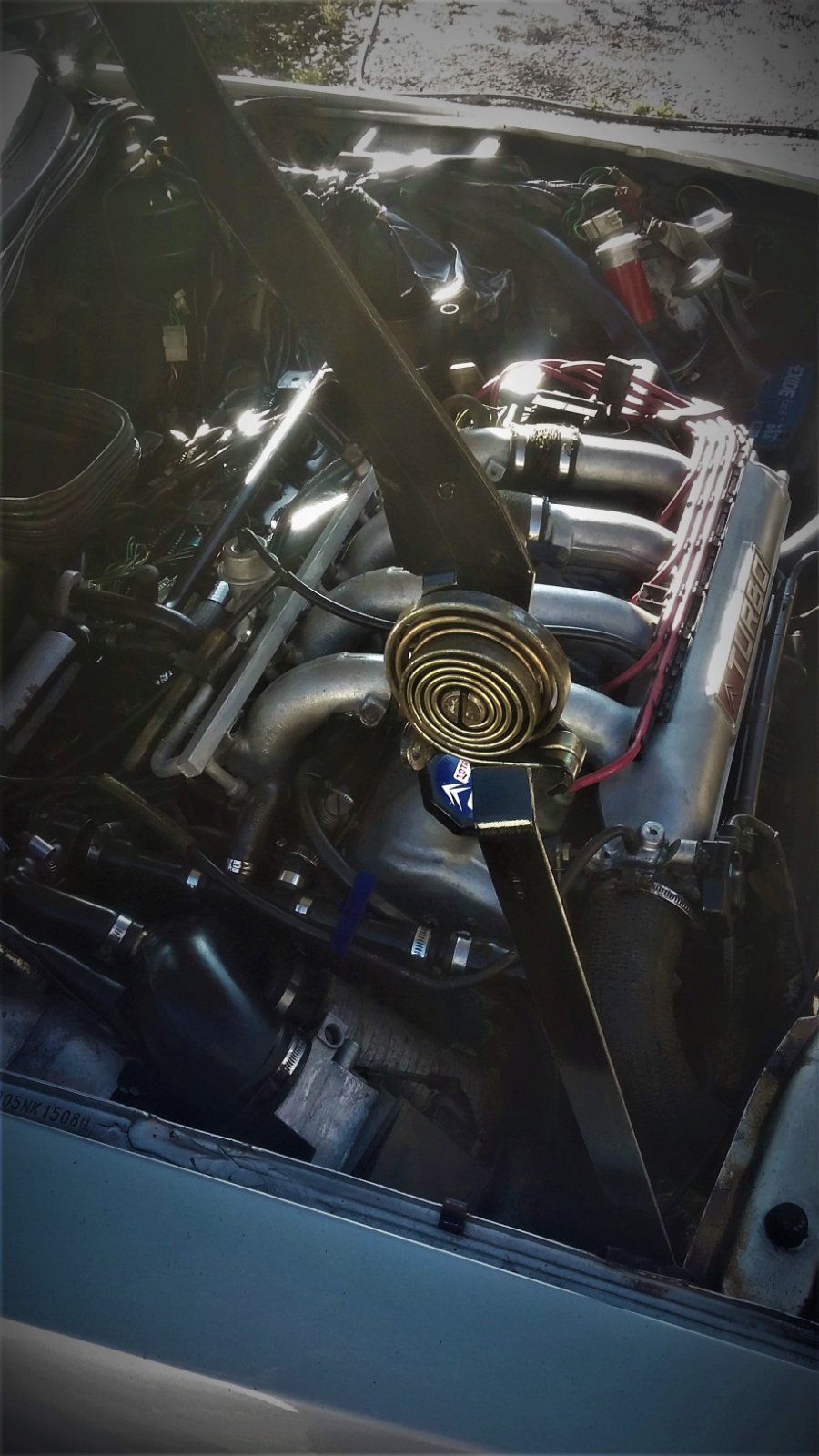

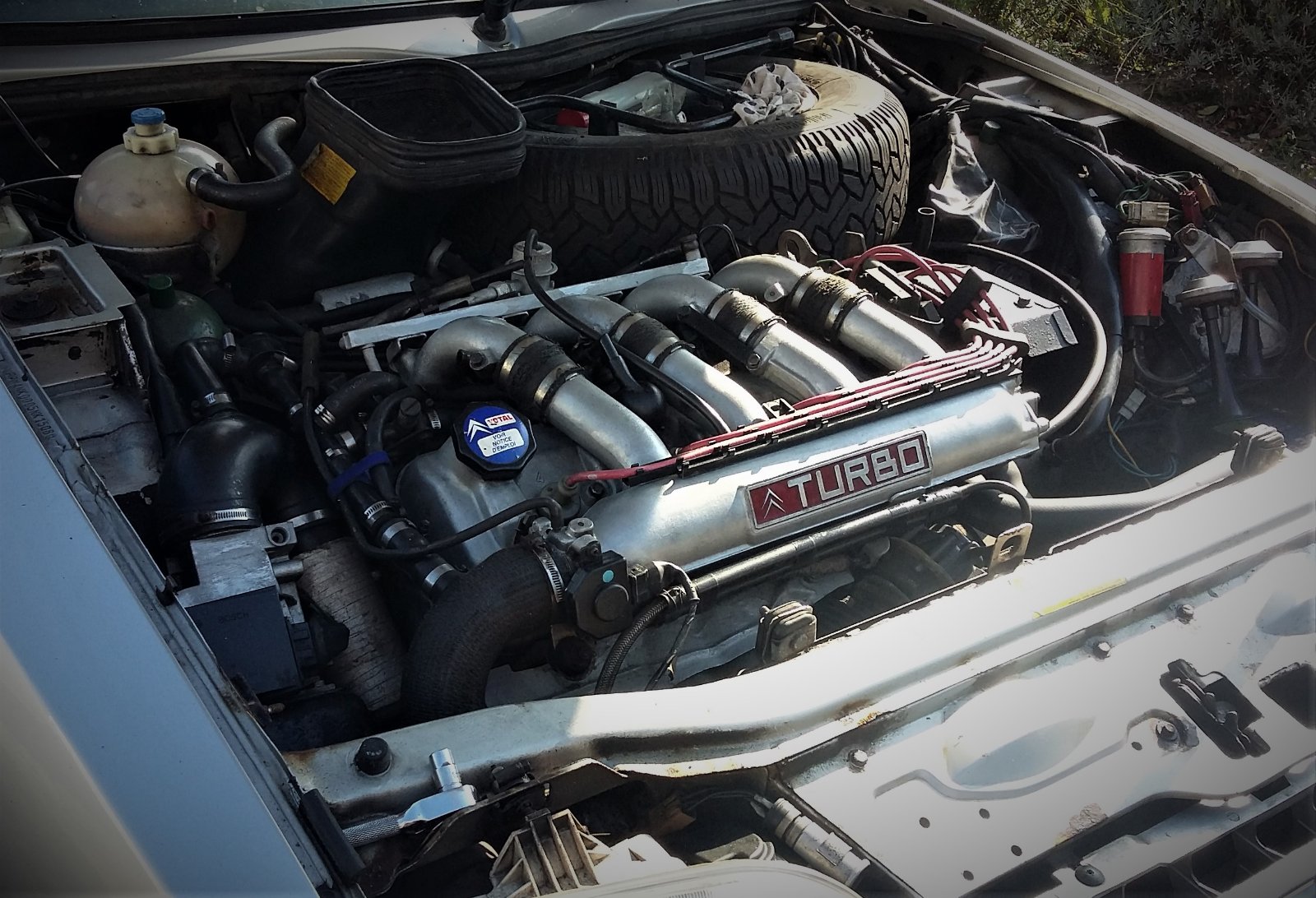

On-wards with the 1st level clean of the engine bay to allow me to asses what I have to do.
as I got it
as I got it

Re: I am an Activaist-v6 and suffer AX-isum with a touch of CX TurboGTI'itus
Cheers chaps
I hate Waxoil applied onto dirt and existing crustiness, and why oh why use the fracking black stiuff !
All sort of nasty edges just covered over. Nothing found of any particular worry.......yet
WaxOil DOES NOT WORK and makes problems worse, be warned.

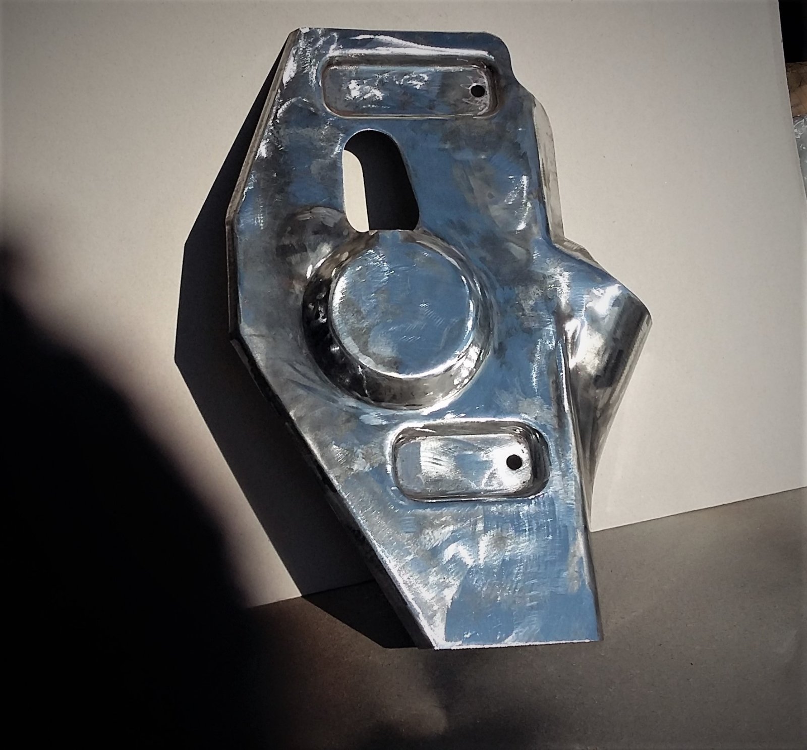

More cleaning, the metal plate is the pipe cover over the subframe that takes the spare wheel, it started as just a little clean up.......ummmm
