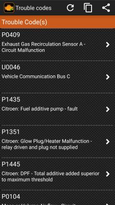

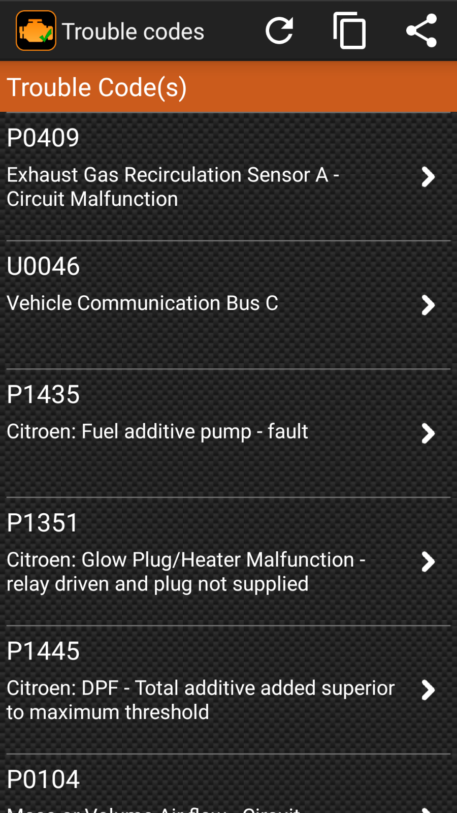

My 1.6hdi 2006 C5 have developed worryingly hickups while driving. The car starts and drives without any other issues, and it have only happened about 15times so far over about a week of driving. And mostly between 60 to 90kmh. Once while accelerating at lower speed.
Today it occurred 3 times within 1km.
OBD2 code U0046 "Vehicle Communication Bus C" is the only lead I have. EGR valve is blanked off..
Any ideas what I should look for?

Re: "Vehicle Communication Bus C" and hickups when driving (1.6hdi)
U0046 is a code returned when there is a fault with the Body VAN 2 network. I think this is specifically for the additive function, as you have a Diesel Particulate Filter fitted.
Unless you’ve removed the DPF with the EGR valve? If you have, we can’t really help as the car is designed to work with them and our advice is always to repair rather than remove which is generally illegal now for road use in the EU.

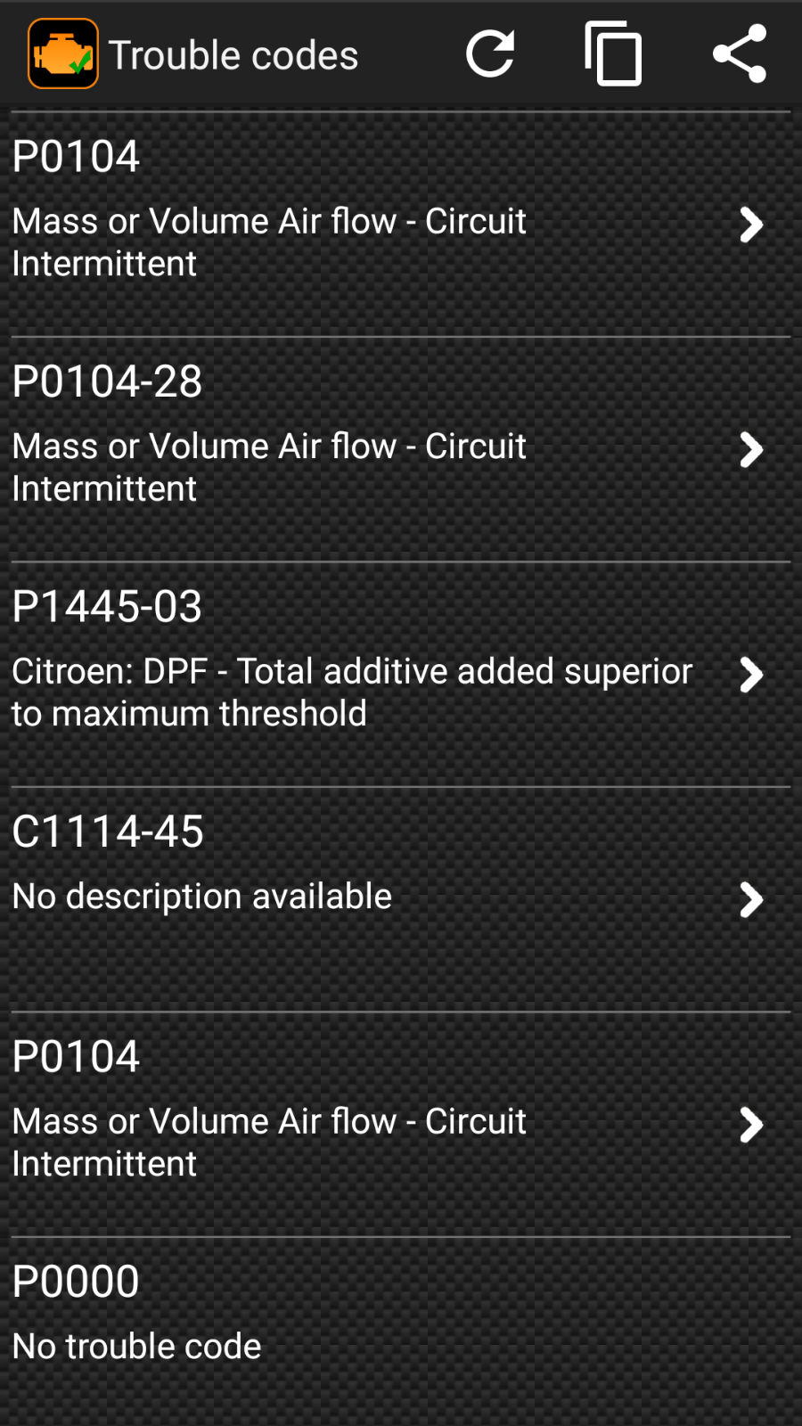

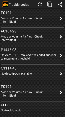

Thanx allot Marc for that explanation!! Reading codes again a few others have appeared. The first two fits well into what you say:
P1435 Fuel aditative pump - Fault
P1445 DPF - Total aditative added supperior to maximum threshold
C1114-45 No description available
P0104 Mass or Volume Air Flow - Circuit Intermittent.
I have now cleared the codes and no codes appears when reading again after 5km drive.
Any suggesting on what I could check out should expect are greatly appreciated!

Is it possible to find out what number 28 in code P0104-28 stands for?
That is a generic code reader - some of the codes like that C1114 are not valid for your car and neither are the ones with the extra numbers:
viewtopic.php?f=51&t=59824#p571421
I suspect your code reader can't interpret the data properly, but the extra numbers don't have anything to do with PSA codes.
