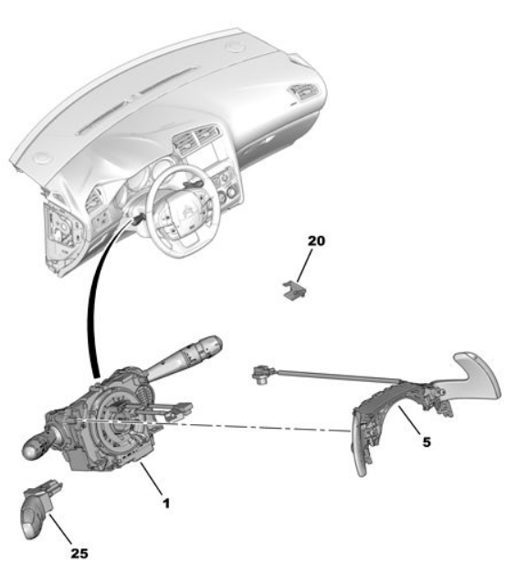

Well the answer to that is:
If you go in and say I want a new key fob, they'll first ask you if you want one with or without a cut key and order it. Once it is in and they code it great. If it won't work after coding, they will check to see if there is a fault with the car and if so, they will advise you of the recommended repair. So as these are special order, they won't refund you if there is another fault on the car that is preventing the receipt and sending of transmissions.
As the fob will be original and brand new including a new battery - the only other likely possibility is the Control module under the steering wheel that acts as the transmission receiver from the fob that talks to the BSI to allow the doors to be unlocked. This unit also controls the lights, wipers etc., so if it is faulty it may be not accepting the signal. So as Paul said earlier - if you know the unit is sending the signal - and is sending the correct code, then wither the control module under the steering wheel is faulty or the communication between this unit and the BSI.
(No 1) Switching Block Remote Control (Comms Unit)
