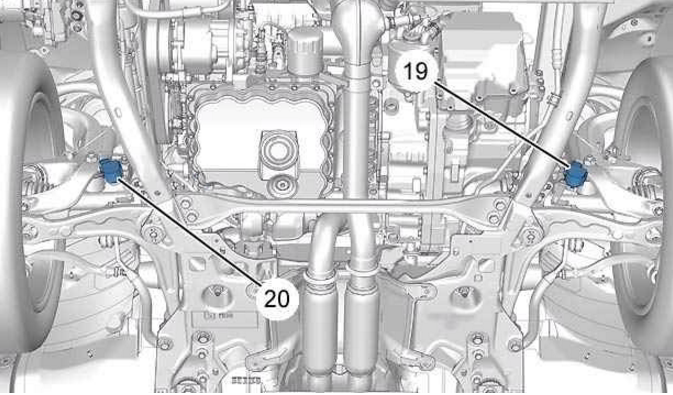

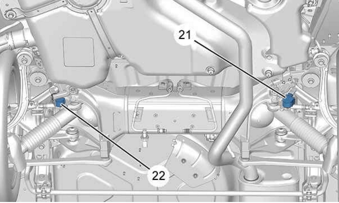

Ok, so confirmed as 3.0 Hdi 6 Cylinder variant, so you have the height corrector sensor on each wheel as per the diagram below:

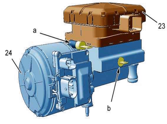

The anti-sinking function is carried out by the exhaust solenoid valves, incorporated in the integrated hydroelectronic unit (BHI) as shown below, so if the car is sinking at the rear, this may indicate the valve is playing up - I would check all the electrical connections to the BHI, to make sure they are secure and that there are no fluid leaks (now or previously, that may have caused fluid to get into the connectors.
| C5 X7 Front Height Correctors on Each Wheel | C5 X7 Rear Height Correctors on Each Wheel |
| BHI Integrated Hydroelectric Block (BHI) Showing Connectors |

No Stu - none of the X7s have the AMVAR function that was available on some of the top end C6s. On the X7 V6 models the system incorporates a separate Suspension ECU and 4 height sensors (1 on each wheel) for these engines. Makes no difference to the ride. It's just there are 4 of the blighters to go wrong instead of 2!
